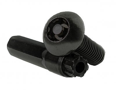

    Schools starting soon and I need a way to secure my LED bar to prevent theft. Can you guys refer to a source to get compatible light locks? I have the 42" radius bar.

    +1. Been looking around and haven't found anything half decent outside of welding the bolts to the brackets.

    Maybe 2 small tack welds on each bolt head would be good enough? I'm gonna do the same although it will be more work when you want to remove the bar and brackets

    We will figure out the thread/size. Please don't tack weld your light bars!

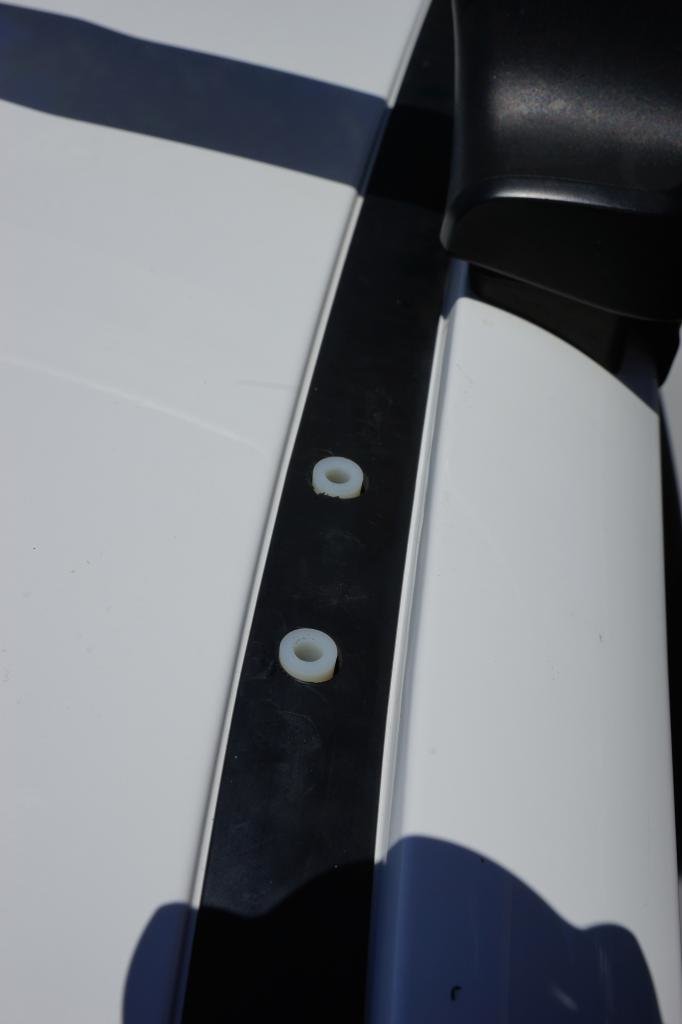

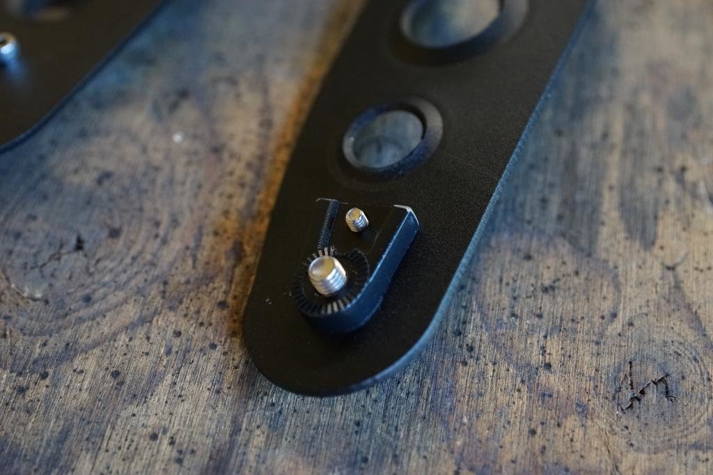

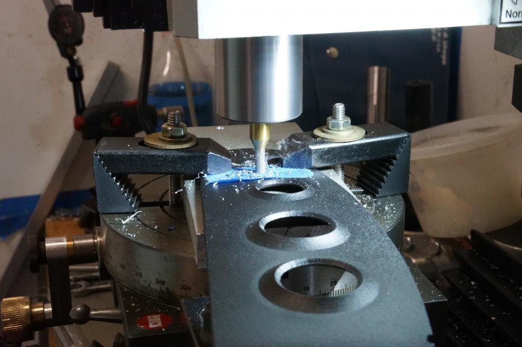

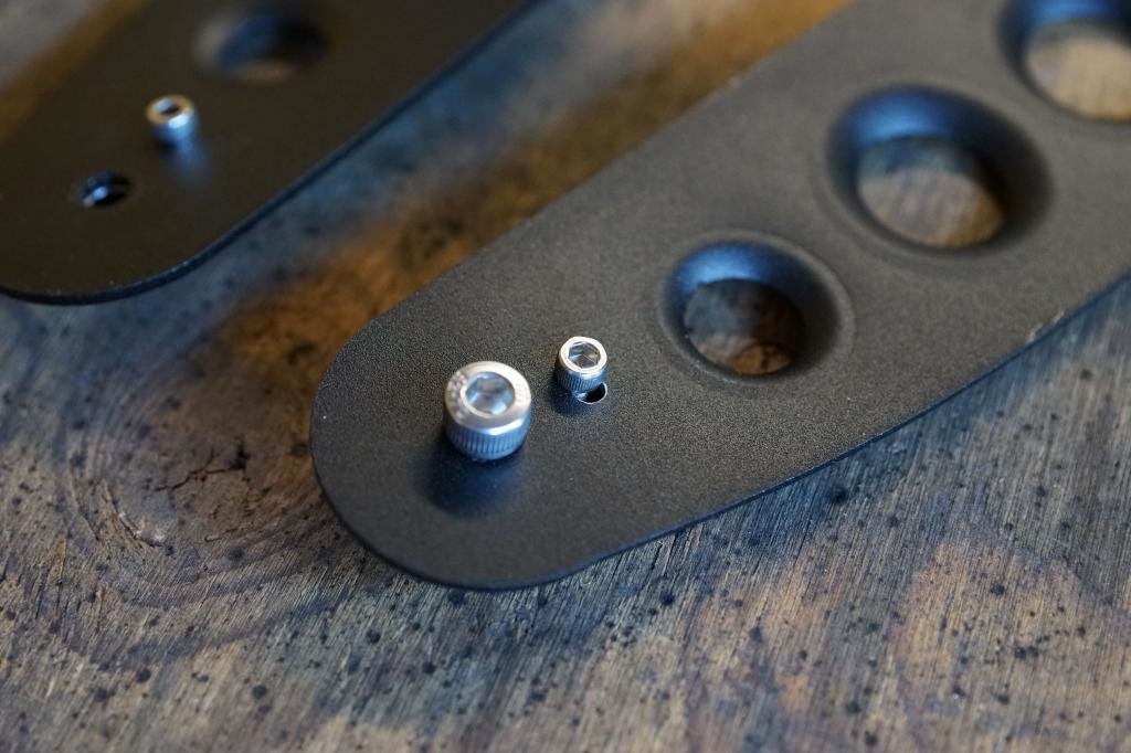

    Mounted the 50" Rampage Radius LED bar. The light bar brackets were modded by creating a 10 degree swivel point with a set screw adjustment utilizing and modding the existing hardware. Nylon bushings were inserted in the channels so that once the bar was mounted there would be no compression on the rubber roof rail as well. The light bar brackets then had to be bent near the mount points to accommodate a better fitment.
    Setting the tolerances
    Creating the 10 degree swivel set screw points
    Close-up of utilizing the existing hardware
    Creating the channel holes for the nylon bushings in the rubber roof strip
    Nylon bushings in place to support the light bar and to prevent compression of the rubber seal
    Test Mount
    Side View of bracket installed on railing (No compression of the rubber seal!)

    Any updates for a light lock source?

    I posted this earlier.

    What is the source and P/N of these bolts?

    Yeah, thats what I was asking. Where can we get this, will they fit for sure?

    Google "LED light bar security bolts" or "light locks". I think SDHQ has them.
