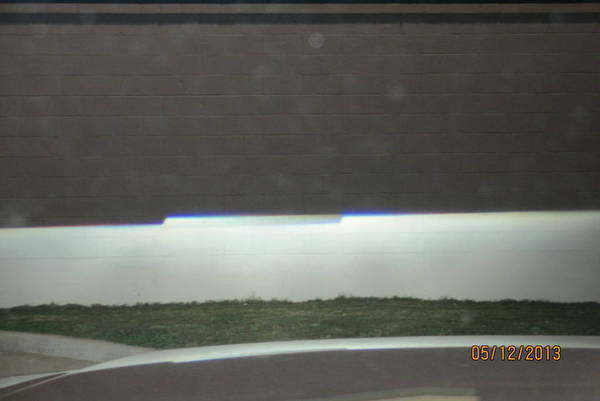

    What do you think about this pattern? My right side light is not perfectly aligned. That's what i get for not doing the alignment in better conditions, meaning there was still to much light outside.

    That is possibly perfect, though it looks like it might be a little too far to the left (really can't tell without the front of the truck for reference)
    The patterns that show both cutoffs in the same place are not properly aligned. If they are lined up to match at 20ft, then at 200ft, the passenger side upper cutoff is going to hit oncoming traffic.
    The distance between the cutoffs, at any distance, should be the same as the measurement from center to center on the truck.

    Thanks Rich, i will drive over to Lowes again and use their wall to re-adjust them. Thanks again for the input.

    Ok, so i went to Lowes and used the wall again. For the life of me, i couldn't get my headlights to point down any further. The adjustment screw wasn't doing anything anymore. Not sure whats going on but they wont go down and i'm afraid that they are aimed to high. Any suggestions?

    If the low end of the cutoff is level with the centerline of the housing or a bit lower, you're fine.
    Different states have different standards (even though they should all be in compliance Federally).
    Some states spec 2.1mm below center at 20ft. Some spec 2.1 INCHES below center at 20ft.
    California specs no more than 5" below center at 25ft.

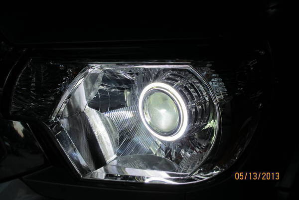

    So i had to open my left headlight again. I found that when i sealed the projector onto the reflector, there was to much JB weld on the back of it not allowing the bowl to be adjusted inside the housing when sealed. Simple fix, used a dremel to grind off some of the JB weld allowing the bowl to move without binding against anything. I am now able to adjust the light up/down and left to right with no binding whatsoever.
    So the light are adjusted perfectly now, or as perfect as its going to get, i am not blinding anyone either.
