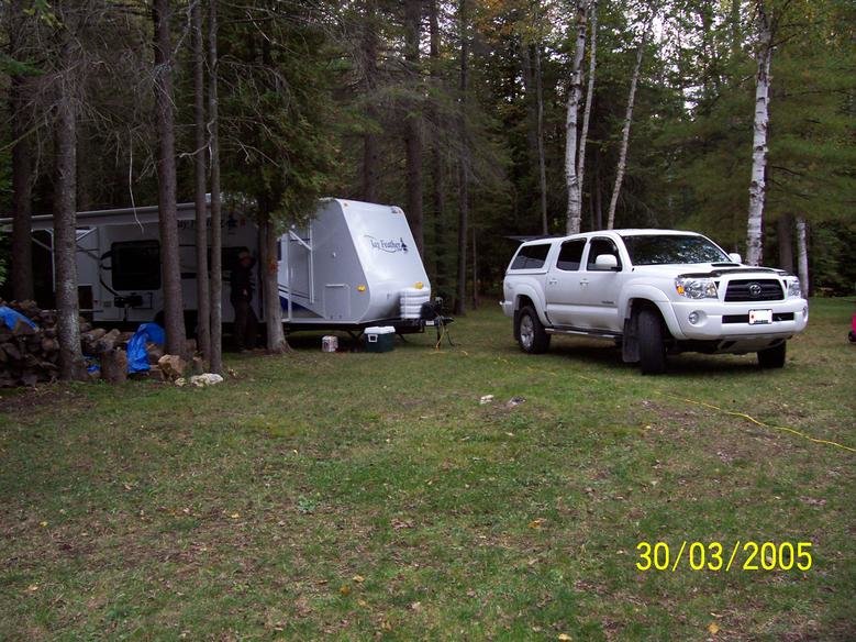

    pull a 24ft trailer at 4500lbs, no problem to pull, I do have a WD hitch and sway bar control. Its a Jayco 213, its 4200lbs dry.

    Its my best friends cottage and we live closer so camp there for free often.
    Yeah after I posted the pic I noticed the date:confused: . It was last fall. I will have to update my camera.
