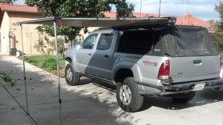

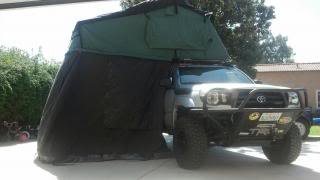

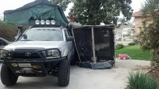

    diablo_Alex2777
    diablo_Alex2777 Well-Known Member
    Feb 2, 2010
    #30567
    483
    Alejandro Gonzalez
    Mira Loma
    05 tacoma dcab Trd off road. 4x4
    Icon UCA's,coilover, Demello front,rear bumper All-pro 3in rear leaf spring Miler maker m8000 winch\ 33's coopers stt's Demello's skip plate 3 hellas 500's
    Here is my home made rack. Made it to still fit my soft top.
    My Rtt set up, From Tents on a rack.
