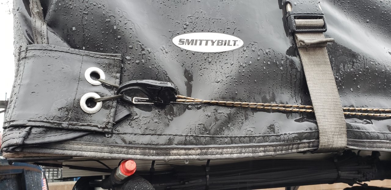

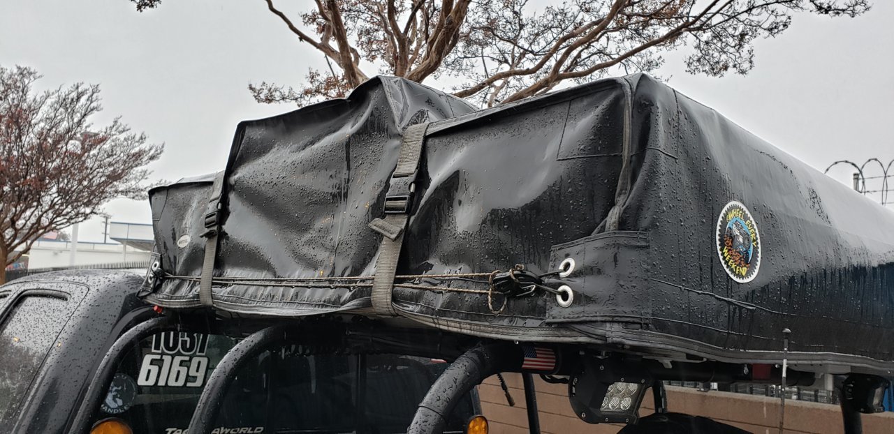

    They are really inexpensive. I also have incorporated one into helping to keep the cover closed. The velcro that holds the flaps have worn from use over the years. So I added two grommets on each flap, has worked out well so far..

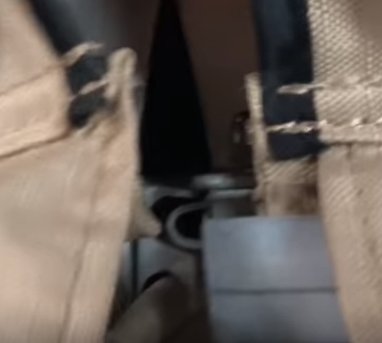

    I am trying to figure out how to fix the "curve" or "V" in my tent joint.
    When the tent is deployed, there is a noticeable "V" when you look at it from the side. When anyone gets in the tent, it flexes down and can pinch hands/feet on the ladder. If I prop the tent up sightly to avoid hurting someone, the tent looks very funny and it feels like the blood rushes to my head when I sleep. Seems like it's pinching or binding or something.
    My buddy is having the same problem so I'm sure this is something usual. There must be a fix for it!
    :annoyed::help:
    Any help would be great! Thanks in advance!

    No it is not bent. I think the tongue and groove aren't fitting properly.
    This are the tongue and groove I'm talking about (this is not my tent).

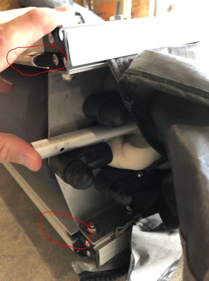

    This is my tent, circled is tongue and groove I'm talking about.

    Looks like the same 'tight fabric' issue I had with my old CVT tent. My Tepui seems a little better. I put weight (think clothing bag and anything else up there once I fold the tent open. Since you aren't using the annex, what about running guy wires back to the wheel or to ground anchors?

    Take your mattress out and look at the tongue and groove From the inside with the tent deployed and you’ll be able to see if its mating properly with weight applied
