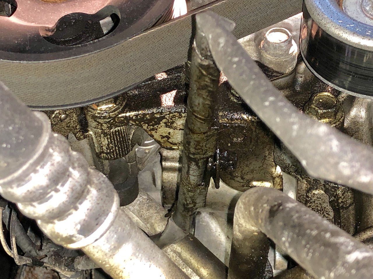

    ------------ Original Post (*timing cover oil leak has been fixed under warranty since then, found my valve cover leaking on 05/07/19) --------------
    I have an oil leak, Toyota has refused to repair it. Toyota Corporate came back to my dealer on 04/12/19 that they’re starting to see these trucks come up with this issue. There is no official TSB yet. Toyota Corporate informed the dealer that it’s “only seeping” and it is “normal” for the engine.
    At least my service manager let me know he disagrees and has never heard a reply that ridiculous, he let me know he took additional photos, submitting a report after he traces the dye.
    I can’t believe this. TOYOTA’S STANCE (not the dealer from what I was told) IS THAT THIS ENGINE LOSING OIL (not out the drain plug after drain plug removal) IS NORMAL.
    A LEAKING TIMING CHAIN COVER IS “NORMAL”.
    Toyota Corporate has refused to fix it.
    • 52,000 miles
    • 60,000 mile factory power train warranty
    • 7 year, 75,000 Mile Toyota Platinum Plus Warranty.
    This trucks first reported valid warranty issue was the same day I bought my truck. This service visit currently was to address braking shudder/washboard issue but I noticed the oil leak the day before I brought it to the dealer while I was changing the oil.
    Truck has been in the shop now non-consecutively for 51 days and counting (31 days on this visit alone). All items beside oil leak had been reported before 2years/36,000 miles.
    I am at month 31 of ownership and purchased it new after test driving it at 5 miles on the ODO.
    Other items documented and worked on so far:
    • Bed assembly issue that required dismantle/fix/paint. (Assembly issue)
    • Hood re-glue. (Assembly issue).
    • Differential Howl (New leafs). Call Friday service manager said it’s returned and will only get worse so x2 attempts. This was not planned for this visit but they’re trying for a fix. (TSB applied once, issue has returned)
    • 30-10mph shudder, which evolved to a washboard. (2 TSBs, both do not apply due to differential/model, or drivetrain configuration/manual transmission).
    • Timing chain cover seal replaced.
    • Replaced radiator
    • Replaced water pump
    • Replaced carrier bearing
    • Replaced rear wheel bearings
    • HVAC blower motor/cage recall. (Recall)
    • Replaced leaf springs
    • Added body-mount dampeners
    Not yet addressed/denied/other so far:
    • Fuel pump chirp (I can hear it echo of houses and vehicles I drive by in my neighborhood. Echos if you park parallel to the garage door/box truck, it’s loud. They “could not replicate”. I have videos. (TSB available/not implemented)
    • Passenger window gaskets cut too short and pop out (documented before 36k, states “customer pushed them back in/no action”. Documented that now warranty is up that they are indeed trimmed too short but extended warranty doesn’t cover trim/seals. (Assembly issue)
    • Electrical gremlin that causes the headlights to dim intermittently, cabin blower to lose power, center screen/digital speedo to brighten in a flashing manner while braking and/or rpms drop through 1000rpm. They’ve documented battery is good and alternator is 13.9 at idle, no further action. I have videos of the behavior. (Unknown)
    • Headlight housings pitting on inside of housing severely/abnormally. Dealer acknowledges but housings are not covered under extended warranty. (Materials failure).
    • Passenger A-Pillar rattle. Cooler/cold days it sounds like a bb in a film container shaking around. (Assembly issue, no TSB, dealer could not replicate).
    • Steering wheel cover buzzes frequently upon acceleration. I have a folded up gum box stuff in it to stop. (Dealer could not replicate, gum box not installed during dealer inspection/road test).
    • Whistling from lower control arms, repaired myself with plugs from HomeDepot, drilled drain holes in aftermarket plugs. (There is a TSB but I DIY addressed mine before it came out.)
    • Rust forming under paint on pinchwelds located on driver bedside, front, between cab underneath vertical rubber gasket. (Dealership has asked me to point this out next time I’m in shop).
    These issues span assembly/manufacturing/service, while affecting areas of drivetrain, suspension, body, engine, HVAC system, and electrical system.
    Doesn’t seem to align their 3 brand promise points they make in a Tacoma promotional video on their YouTube account:
    Video: “2018 Toyota Tacoma: Walkaround Complete | Toyota”
    -and-
    Video: “2018 Toyota Tacoma: Value | Toyota”
    “Toyota’s rock-solid reputation for quality, durability, and reliability.“

    Check this thread out where it was fixed for 2nd genners.
    https://www.tacomaworld.com/threads/tsb-oil-leak-timing-cover-being-fixed.96895/
    There is even a TSB for it !!!!!!!!!!!!!
    Oil Leak From Front Timing Cover
    T-SB-0326-08 October 24, 2008
    "Some 2005 – 2008 model year Tacoma vehicles with 1GR–FE engines may display evidence of a
    small oil leak located where the Bank 1 cylinder head, engine block, and timing cover meet. Use the
    following repair procedure to address this condition
    This repair is covered under the Toyota Powertrain Warranty. This warranty is in effect for 60
    months or 60,000 miles, whichever occurs first, from the vehicle’s in-service date."
    I call bs. Call back and tell them about this TSB on older ones and ask why not now !
    Imagine what that shit will look like 100K from now.

    To be clear, my dealer service manager thinks it’s not right.
    Toyota has stated it is “normal”.
    I will be requesting a formal statement in print.
