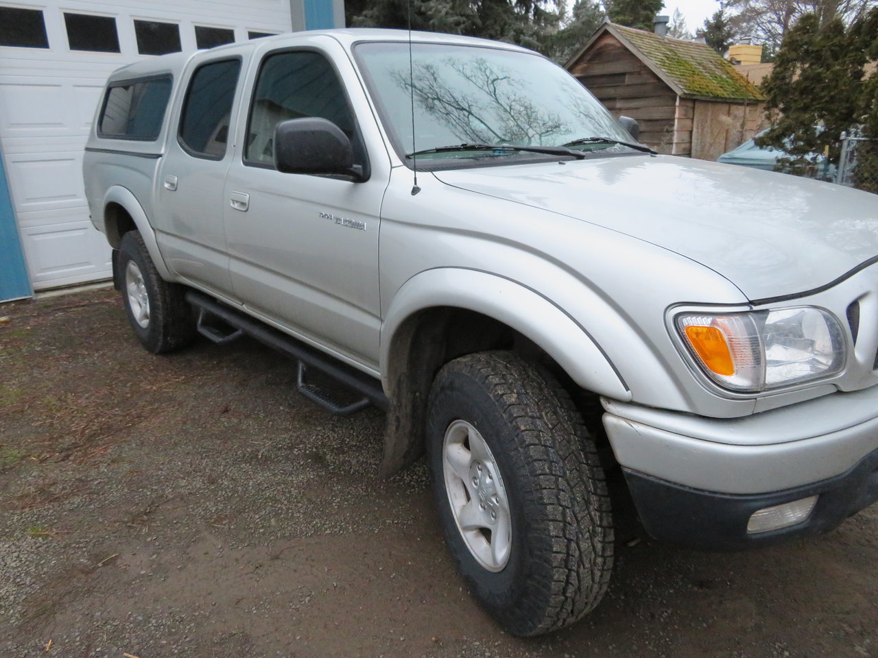

    Here's a pic of my first gen with 235/85r16 Toyo open country. For on road they work fine but I've only had them a couple months. So far better breaking and take off, there is sway on interstate corners but just slow down a little, and zero hydroplaning which is great. Haven't taken them off road yet but looking forward to it. Had KO2 in a 265/75r16 and for this truck that size/tire just seemed too heavy.

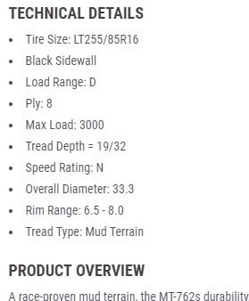

    What about the Maxxis Bighorn 255/85/16
    That's what I'm running right now.
    Trying to find the weight.

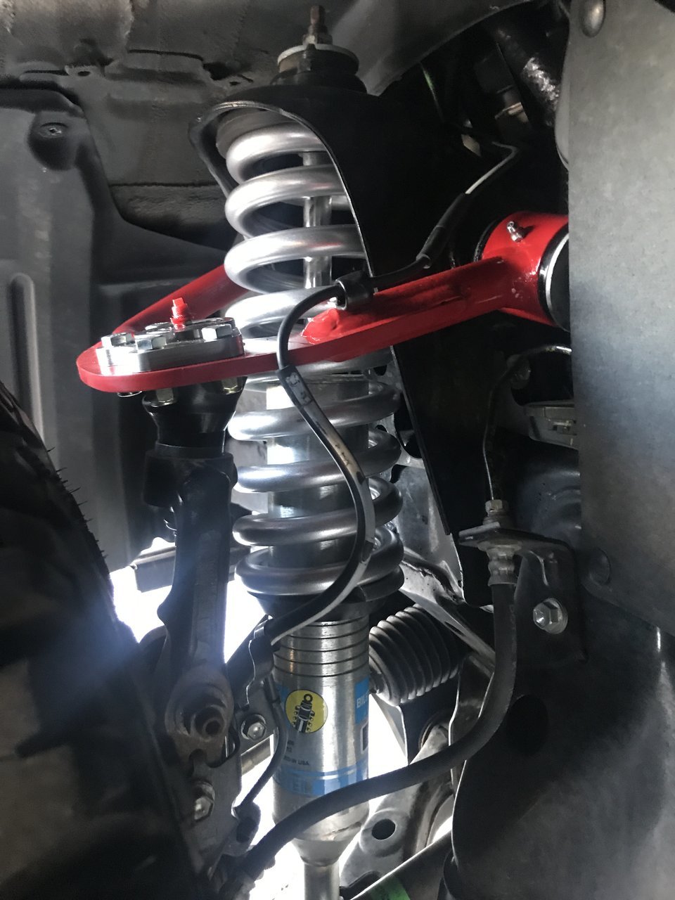

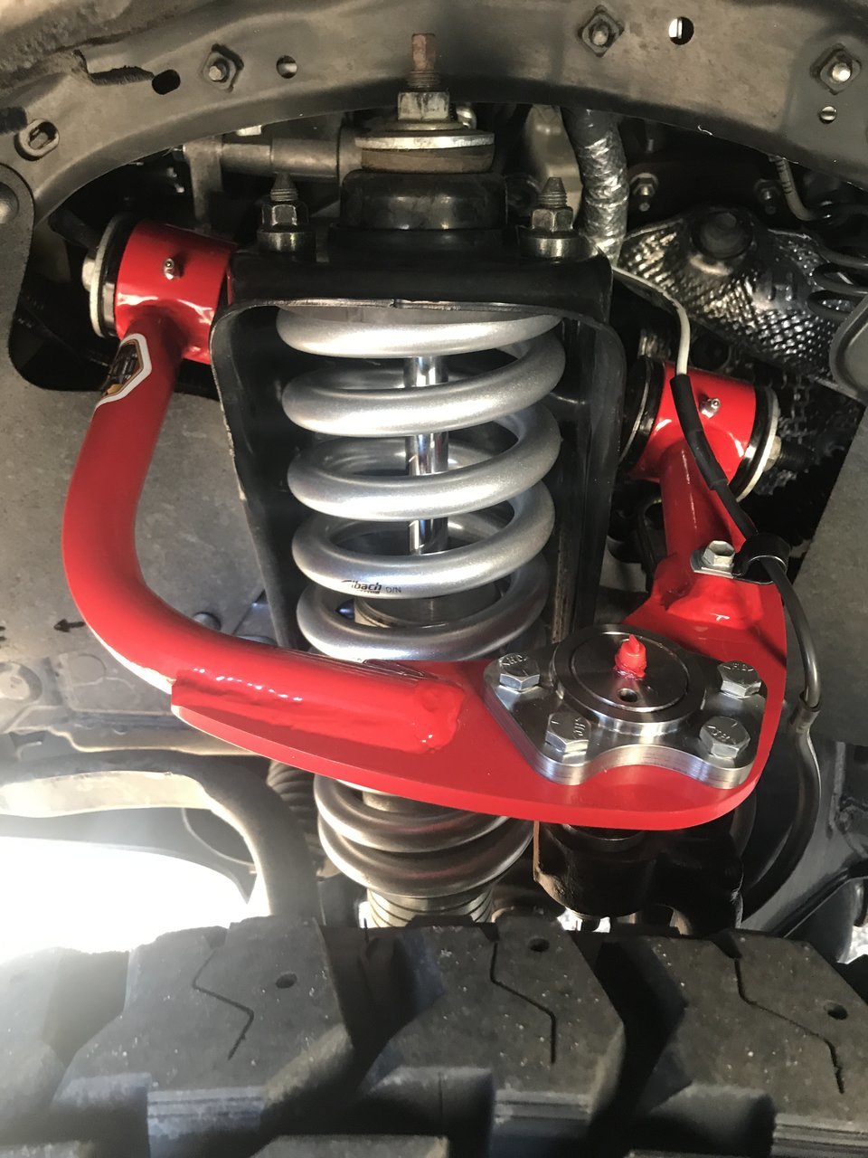

    posted this in the other 255 experience thread but seems this one is more active:
    What UCA's are people running with 255/85r16 on stock OR rims without rubbing on the control arm? I have a 2015 TRD OR and getting ready to install ADS ext. length coilovers and Dakars. Trying to decide on UCA's. I was leaning towards JBA but read that 255s will rub UCA with stock rims. So its either get new rims or wheel spacers or find a new UCA. Has anyone had issues running 255s on stock rims rubbing UCA at full lock with certain aftermarket UCA's?
    Does anyone run Total Chaos with 255s on stock rims? JBA recommends 4.5" BS rims to clear the arms with 255s or 1.25" wheel spacers if I want to stick with stock rims. Does anyone have any pics of 255s on 4.5" back spacing rims ?
    Damn this stuff gets confusing
    Thanks

    Ohno......I didn't realize that JBA needed that back spacing. Damn it! I really don't want to do spacers, but I may have to.

    LR, stock sport rims, cmc, no rub

    No issues at all I have 4.5+ of BS on FJ TRD team trail wheels. As long as you don't have a negative offset your fine.
