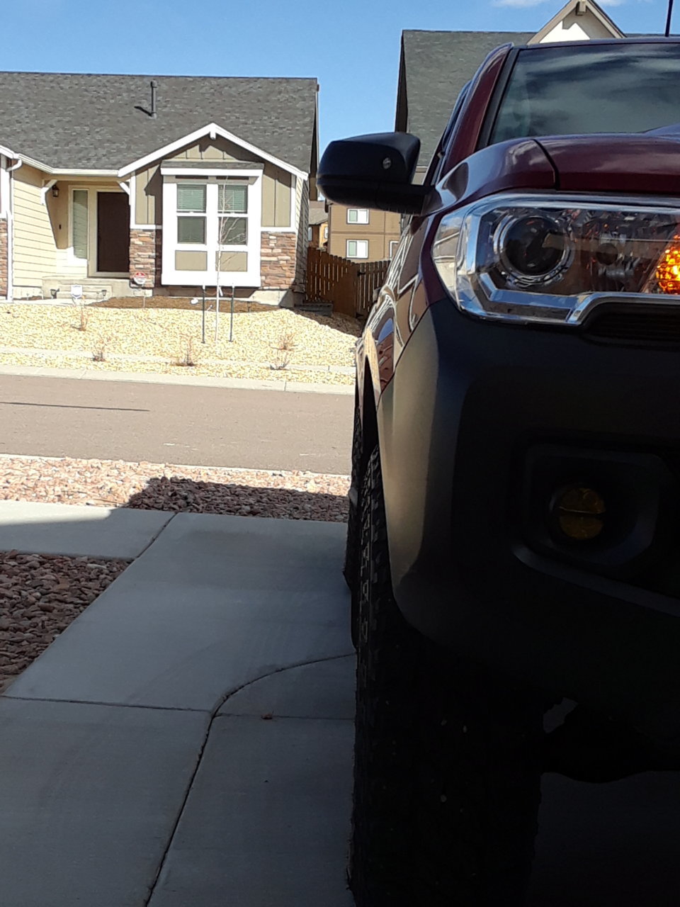

    I'm 255/85R16 on factory steel rims (no the spare type) and I'm flush (or a bit less):
    Dang, I should have snapped the sunny side...

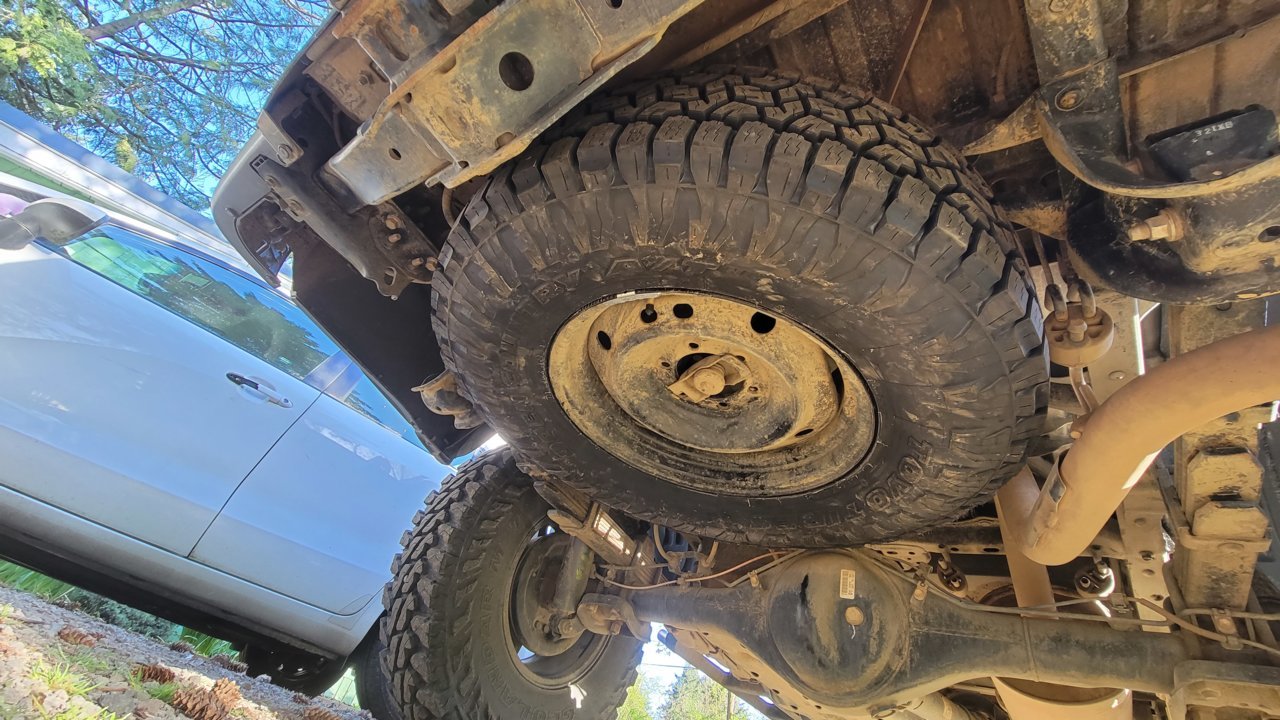

    Bent up the spare tire tabs and cut off the exhaust hanger in order to fit the 255/80R17 STT Maxx spare under there. It looks like it's clear of the diff and I think that I'm good to go, but haven't had a chance to test it yet. Anyone have opinions on if it's good or if it looks like I'll need to the relocate the spare tire mount?
    edit: Flexed it much as I could with a Pittsburg 14" jack on the diff. It's still not hitting, so it's good to go for normal everyday driving, although I'm certain there will be contact offroad. Probably will end up relocating the bracket next weekend just so I don't have to worry about it.
    Edit 2: After reading through this thread on relocating the spare tire hoist and thinking back to a photo I took of my hoist... it looks like moving the hoist where I want it might not be feasible on my 2011 without making some sort of bracket to lock the rear bolts in place. Guess I'll be strapping the tire into the bed when hitting the trail this summer.

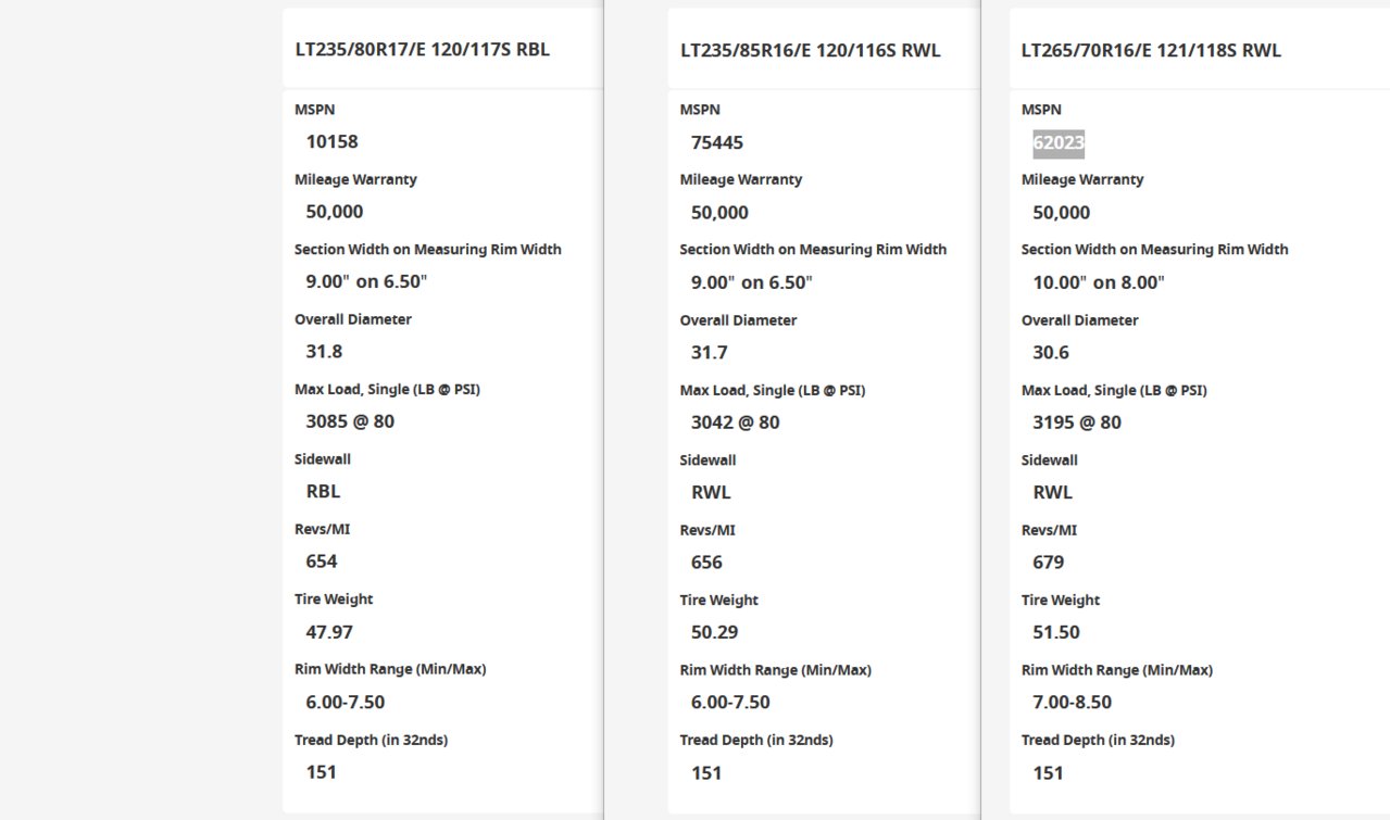

    KO2 listings.
    Stock Tire, OR with 265/70R16 on there now.
    Thinking of 17" TRD 4R Wheels (get five from McGregor) and running 235/80/17 KOs, Going back and forth about 16" steel wheels (paint them black).
    Full set of rims and tires to swap over. Get them for Discount Tires. New Sensors programmed to match the existing four wheels so when I swap back forth now TPMS issues.
    Costco has a better price, but I suspect if I get new rims and TPMS Discount may be easier to deal with in getting TPMS programmed to match the other tires. Ya, probably another $60 per wheel?

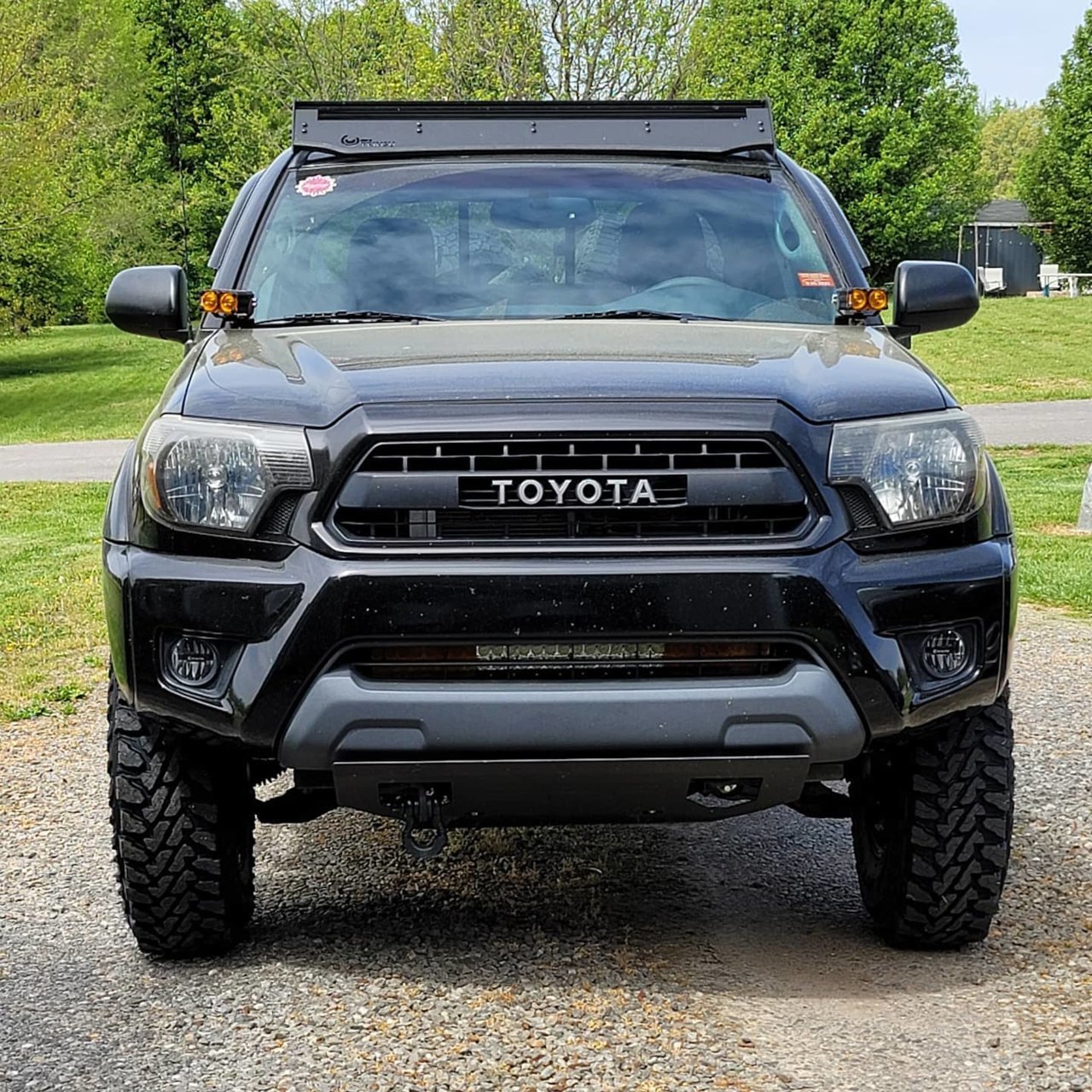

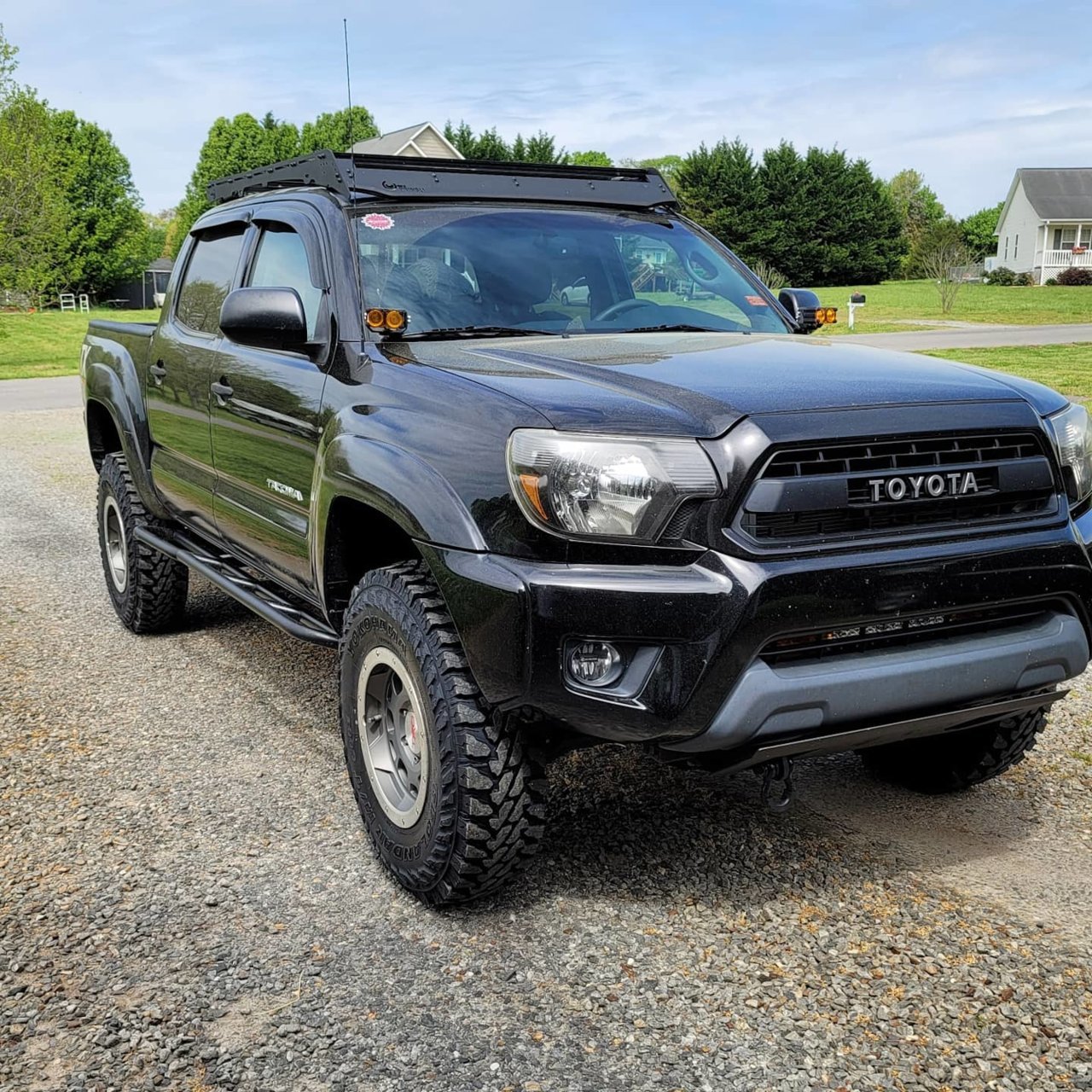

    Just made the move from 265-75-16s to 255-85-16s and am liking the look! Might just be my excitement talking, but it feels more controlled when driving as well.
