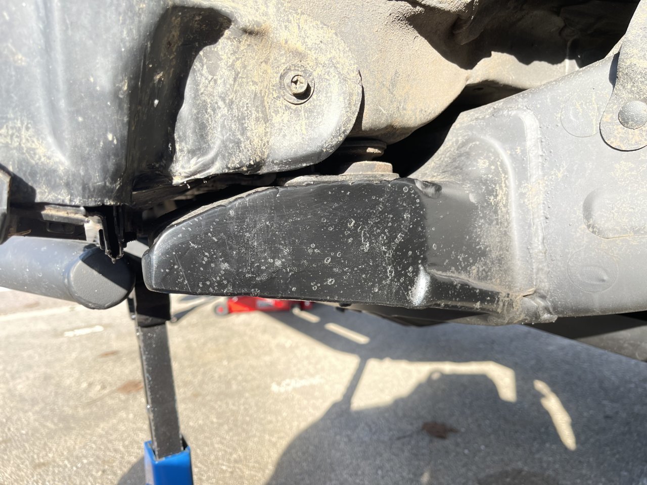

    Those will be sufficient. I love my Wildpeaks in the winter!
    Everyone’s set up will be different. Some tires can run bigger then others. I ran my 255/80r17 on my truck with a 2” level and cleared the cab mount with much room to spare. Put a 3” Elka lift on and would rub like crazy. Every time I turned into a driveway I’d rub. It all depends on your alignment specs as well. You can push your caster to 3 or 4 degrees to get the tire away from the cab or you can just cut it. I did a CMC to gain more clearance. I also plan to go with a skinny 35 in the future so I just cut to get it over with

    I have SPC UCA along with a lot of other work done. I don’t know what the previous alignment specs were but after I installed the lift, my alignment was set to 2.5 caster (set to the recommended 2 degrees on SPC and 0.5 degrees on LCA), 0.5 camber and 0.05 toe. It was either pay another $150 for an alignment if I changed the SPC degrees to add more caster or do a CMC. I did the CMC myself for next to nothing and this allows me to plan for the further when I put 35’s on

    That's a super clean cmc, nice

    Super interesting, this is a great example for ppl to see how things can go. Nice setup! The ability to do the CMC yourself changes things for sure.

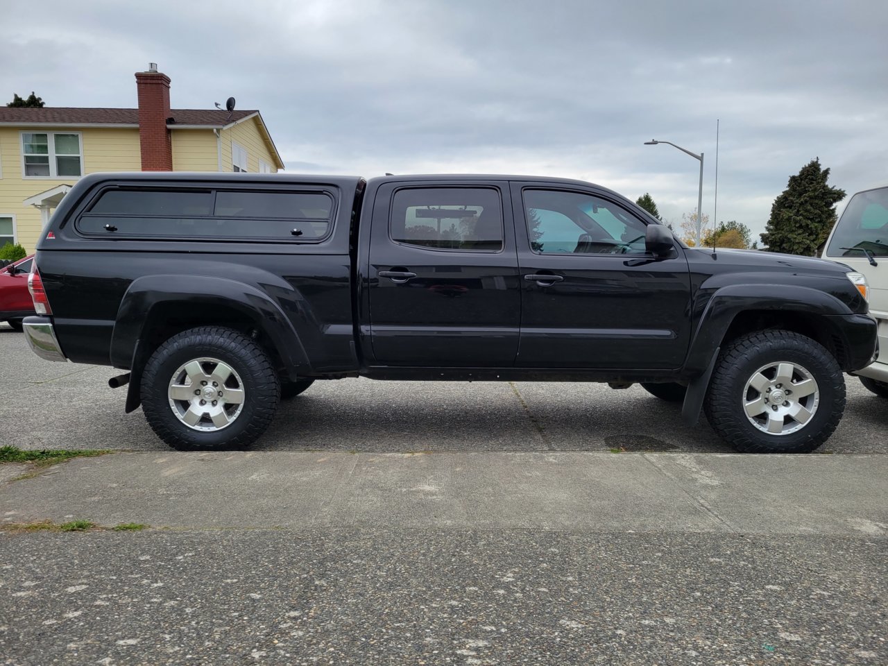

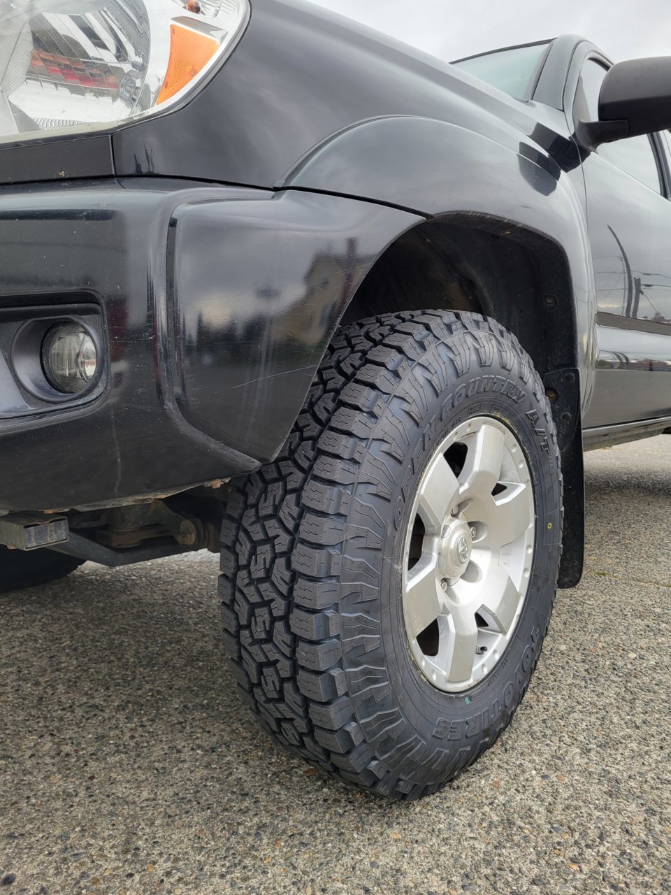

    LT255/80/17
    Toyo AT3

    Looks great! I'm loving mine

    Obviously you are running FJ wheels, which had a 15mm better offset than the TRD Sport wheels that came on that year (assume the same for other wheels on 2nd gen, but only know about the sport wheels). Any lift and any rubbing?

    I'm lifted around 2-2.5 w/ ICON ucas. It rubbed a tiny bit on the front mudflaps backing out of the shop yesterday, I'll get up in the woods and feel it out more later this week.
    Really liking the look so far. But already thinking about a modest regear after driving home yesterday
