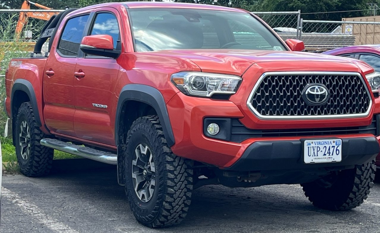

    2018 Inferno Off Road 255/85r16 Yokohama Geolandar MT
    Sport bar, air horn, 255/85r16 Yokohama Geolandar MT
    I am down to 15 mpg from 19 mpg. Well worth it tho.
    I have the 255/85r16 Yokohama Geolandar g003

    The only thing I had to do was take off the mud flaps.

    I'm on 255/85R16 on stock (OEM) wheels and do NOT have a lift. No rubbing.
    I do run mud flaps, but they are not OEM.
