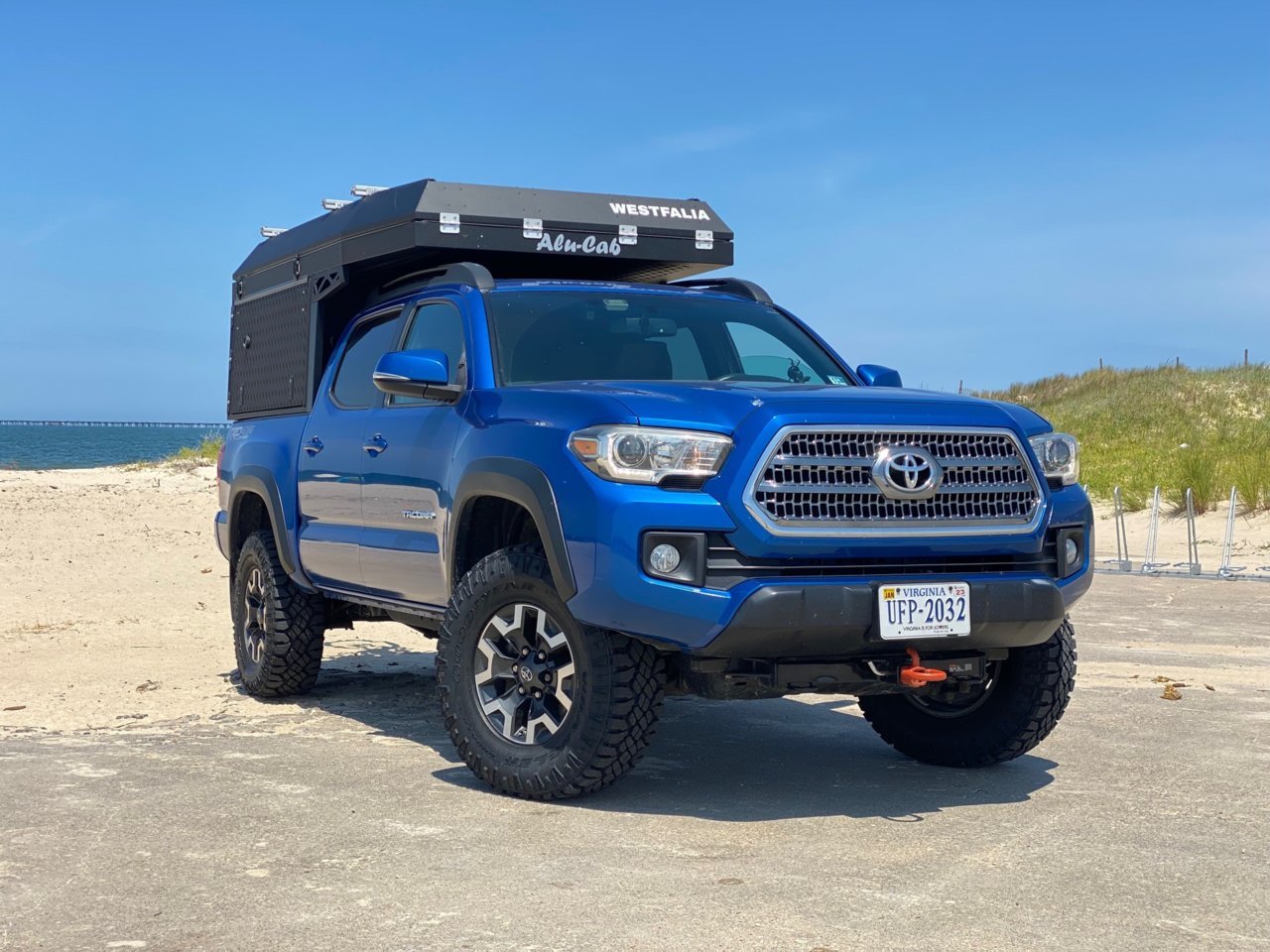

    Just picked up some Goodyear Duratracs 265/75R16

    Another candidate … how are they??

    Ive had them on for all of 3 days now... so far so good. Very light road noise. Gas mileage has dropped a pinch. Looks incredible.

    They do look incredible. That’s the size I want, too, and the interwebs say they’re only 45lb in Load C?? Is that right? Any idea show they compare to Cooper discoverer AT3 LTs?

    I have no idea how they compare. I got an E load rating which has a thicker sidewall because of my constant load.

    Looks great! I’m interested in the Westfalia top. My powerwagon came with duratracks dog gone things about never wore out so I could buy 35’s. Ended up giving them to son in law. My excuse was they just looked to small on the PW. That is one awesome looking ride!

    Your Tacoma that is, awesome looking. I was able to google the top online. Never seen that blue before. Is that a United states color or are you from Canada? Forgive me I’m new to the site. I’m new to Tacoma also. Been keeping for a long long time. Fished with a guy that had a 2015 Tacoma sport and if he can’t tear it up I had to have one. He could tear up a iron wedge with a rubber mallet! But that Tacoma just keeps plugging along for him!
