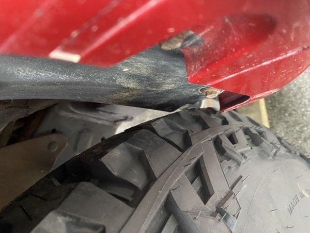

    So curiosity got the best of me and I put all my tires on today. The passenger's front is clearing just fine and seems to have enough clearance (we'll see how much when I flex test it). For the driver's side I had to remove the fender flare because it won't clear it, "note picture above" and even after I remove it I had room for the wheel to turn, however it does still touch just a bit in reverse backing up while turning about where the pinch weld is.

    I haven't touched the Pinch weld but I might need to before I go wheeling at least on the drivers side"
    I do have CMC done and right now on the drivers side if it wasn't done I think it would have touched if it wasn't chopped.

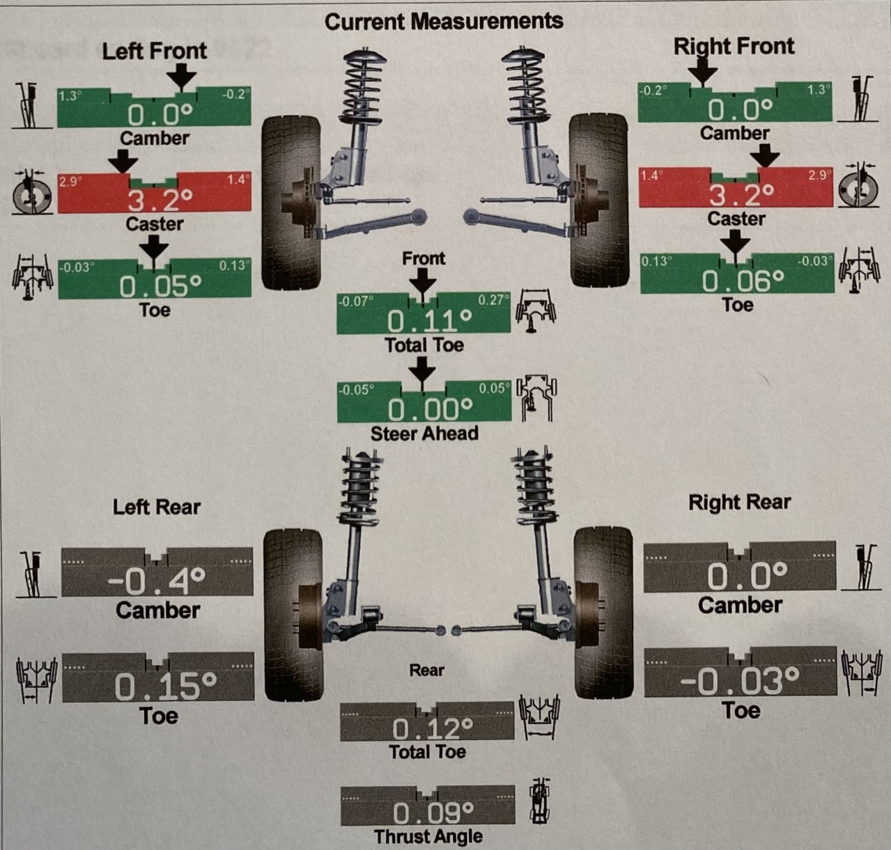

    If you take it to a good alignment shop that knows how to adjust the SPCs they can set it up for max firewall clearance. Have them move the rear cam bolts of the LCAs all the way out, and the front cam bolts of the LCAs all the way in. This rotates the lower ball joint as far forward as possible. Then set the SPC to setting E. Adjust the camber with the SPC and adjust the toe with the tie rods.
    SPC Setting E
    Front
    Rear
    Excellent write up on alignment of the IFS tacoma

    You can set LCAs are set up as shown above, and set your SPCs to position E before you take it to the shop. Find a small shop that will let you stand talk to the tech as they do the alignment. Show them the SPC and explain to them not to touch the LCA at all. Tell them not to worry trying to set the caster at all as it should end up around 3 degrees with the LCA set up like above and the SPCs set to E. Explain that the front will need to be raised to take the load off of the front suspension, and then the big nut on the SPC UCA can be loosened and the ball joint mount slid either in or out to get the camber set. After that it is just a simple toe adjustment with the tie rods.
    For reference these are my alignment numbers on my 3rd Gen set up as described.

    Drives dead straight but the roads I’m on most of the time are not very crowned.

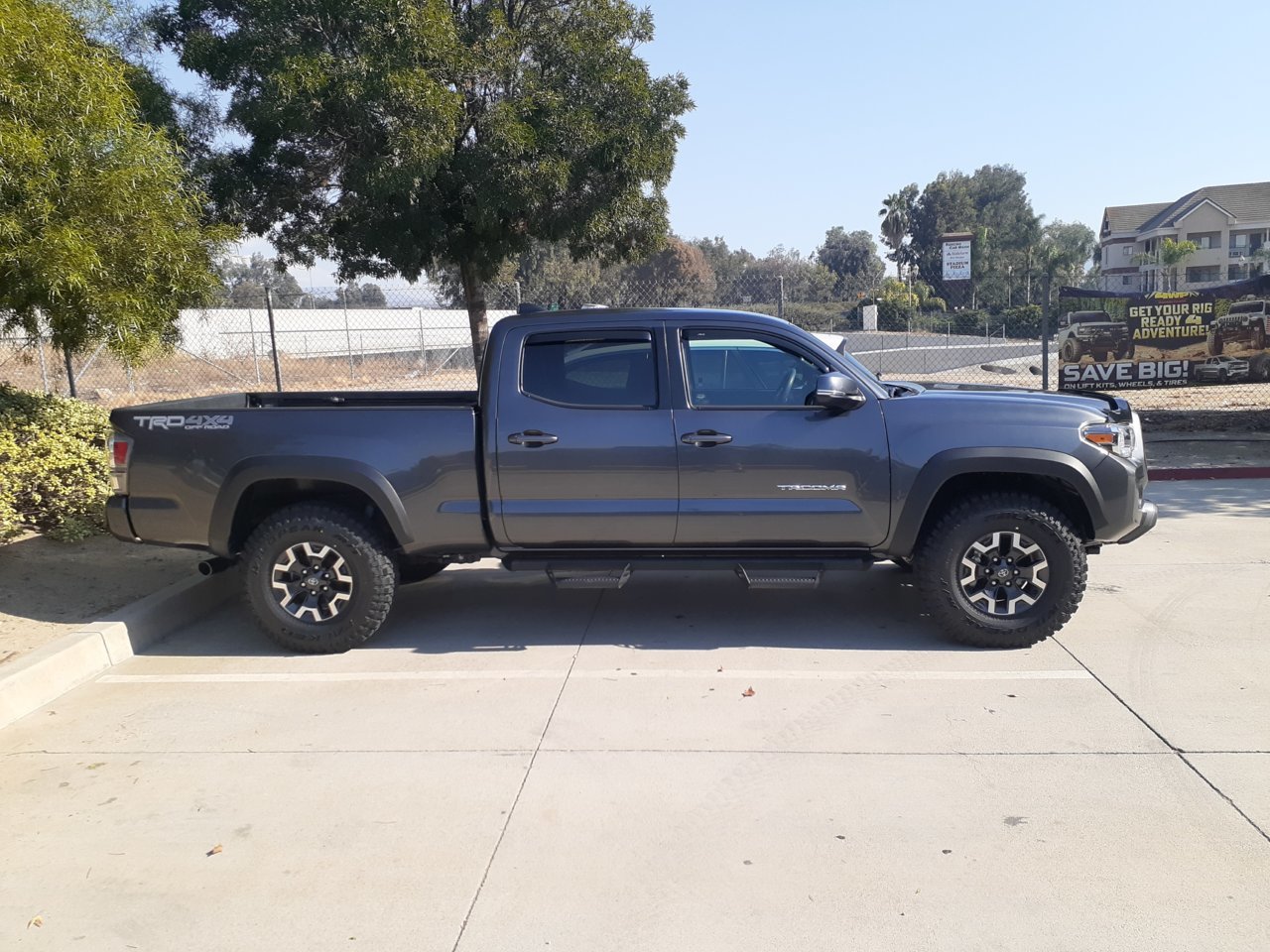

    2021 Magnetic Tacoma TRD Off Road 4x4 Long Bed
    2021 TRD OFF ROAD. With stage 4 icon suspension. 255 85 R16 Falkin wildpeak MT. No wheel spacers.
    Before and after pictures. 20220927_180137.jpg 20220927_180137.jpg 20220926_155747.jpg
