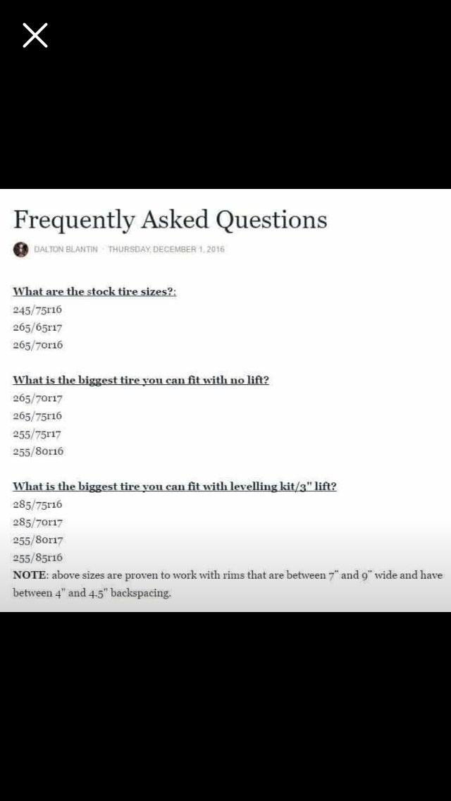

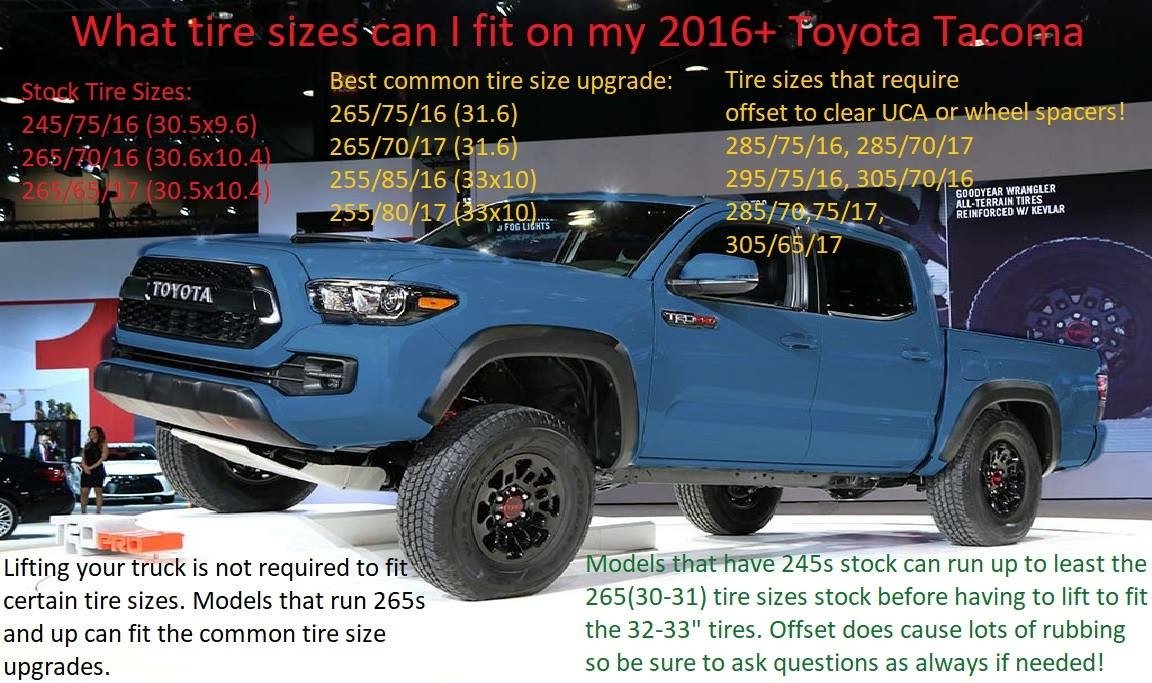

    Ok, i have looked around a lot and not finding much. I am new to this so it could be me.
    I am looking to get some 255/75 17 tires on my ‘17 sr5. Would they fit with no lift? What would I have to do to get them to fit? Thanks so much.

    Here you go!
    6FE1C8A5-5693-47C0-83A2-5DFFEBEC44F3.jpg 43B7430C-5AF8-4BC3-B1C9-B1B1A844E052.jpg

    I've got a 2" Bilstein/HS coils and rear AAL lift coming in a few weeks. According to this chart 255/75/17 would fit without lift on my TRD Sport. I assume that means no rubbing and no trimming. Would there be any issues with these fitting the stock sport wheels? Speedo/odometer issues?

    I dont foresee any issues. You can go here to compare stock tire size to the new ones to compute the difference in mpgs.

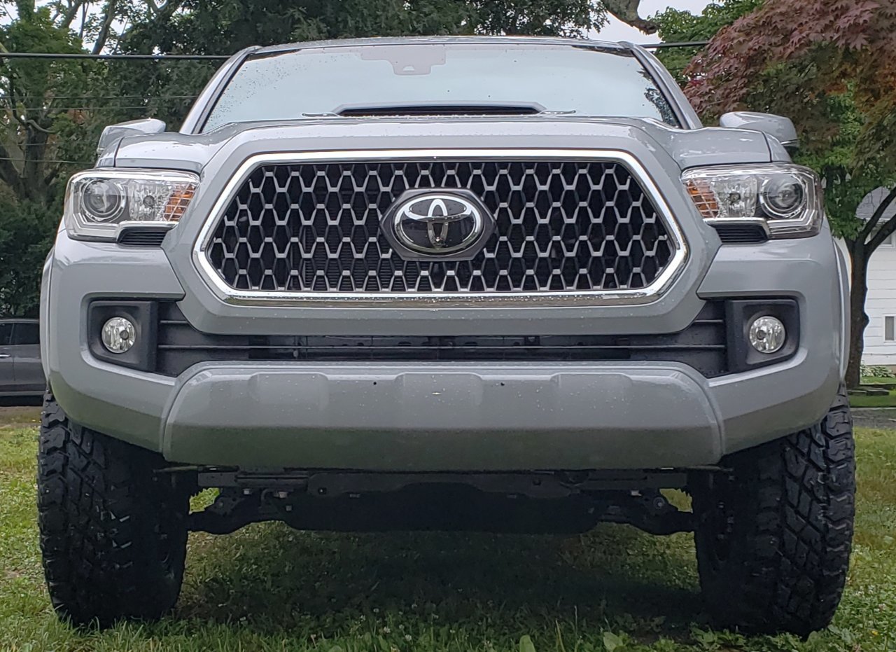

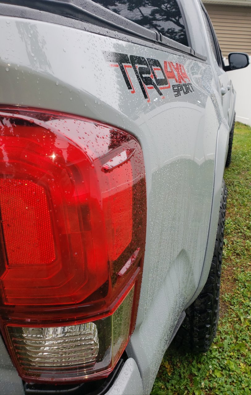

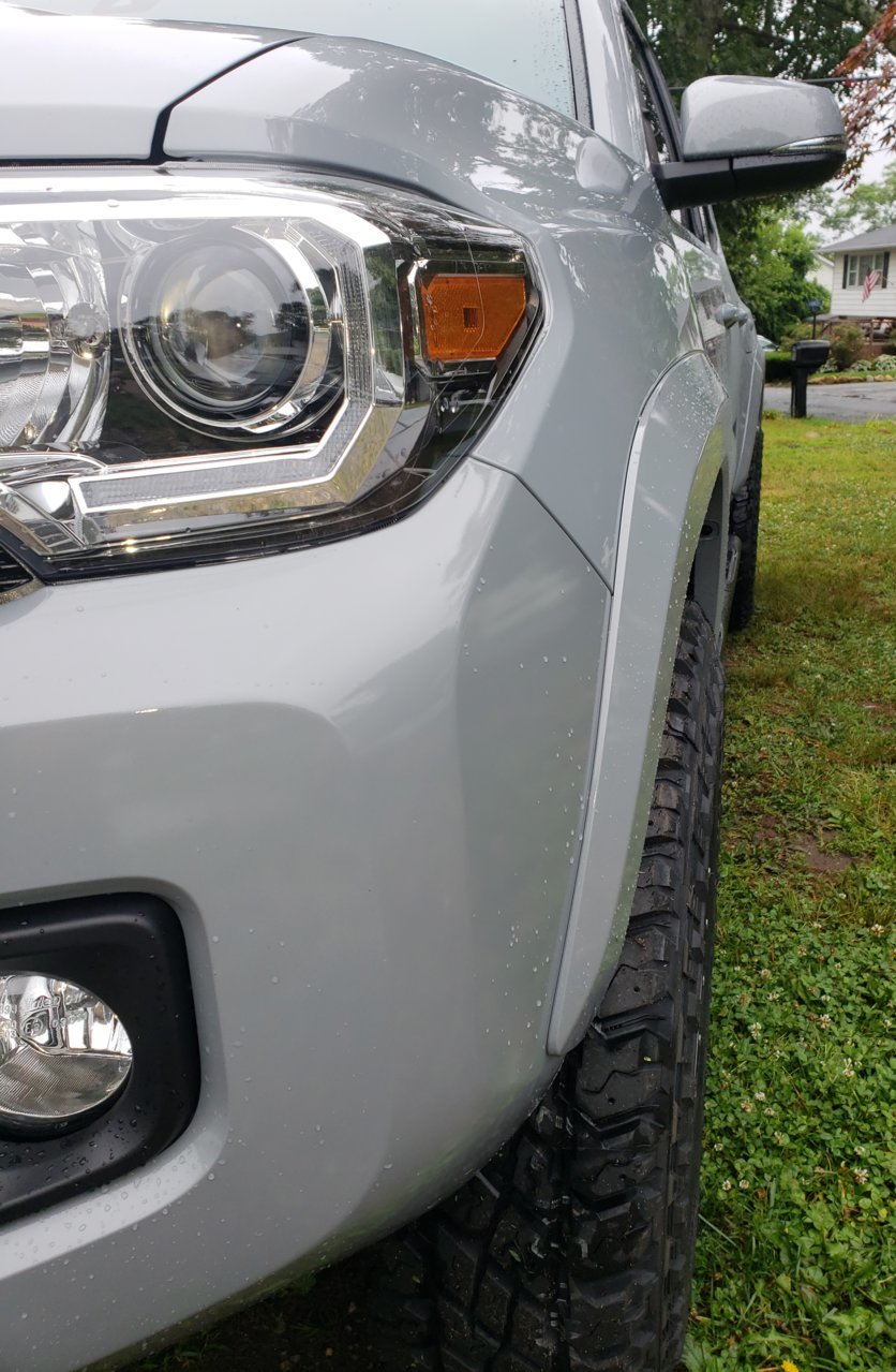

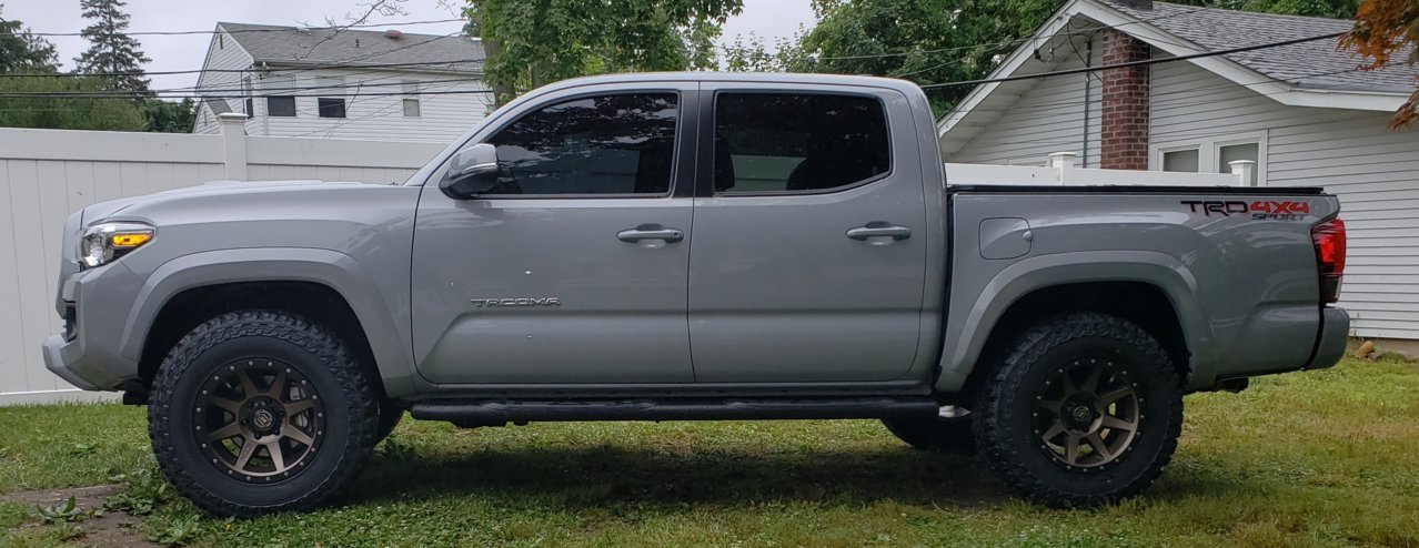

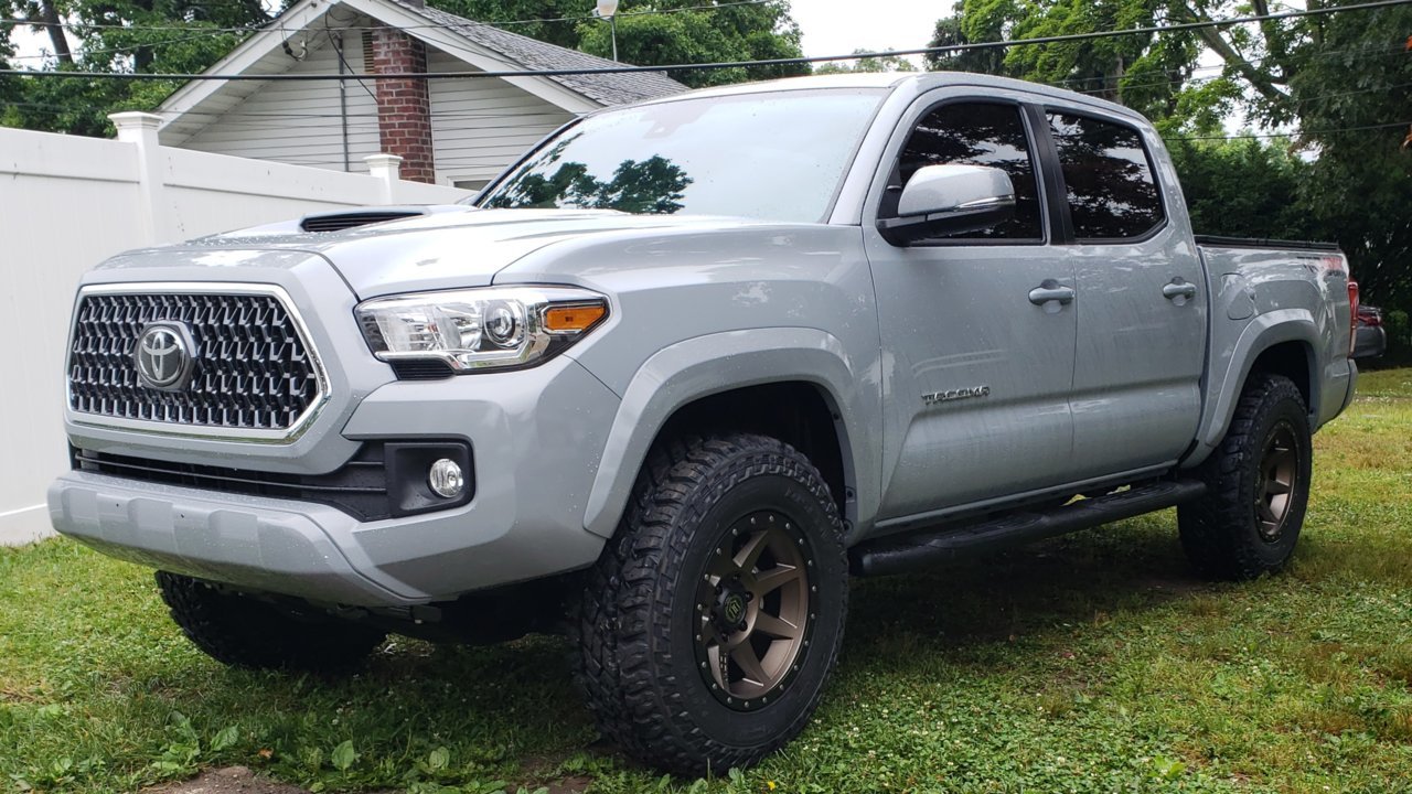

    Icon Rebound 17x8.5 w 0 offset mounted on Cooper ST Maxx 255/80r17. Tires just barely clear the fender flare while driving normally, slight rub when articulating. No spacers, and i think they fit perfectly if you like your tires to be even with the fender.

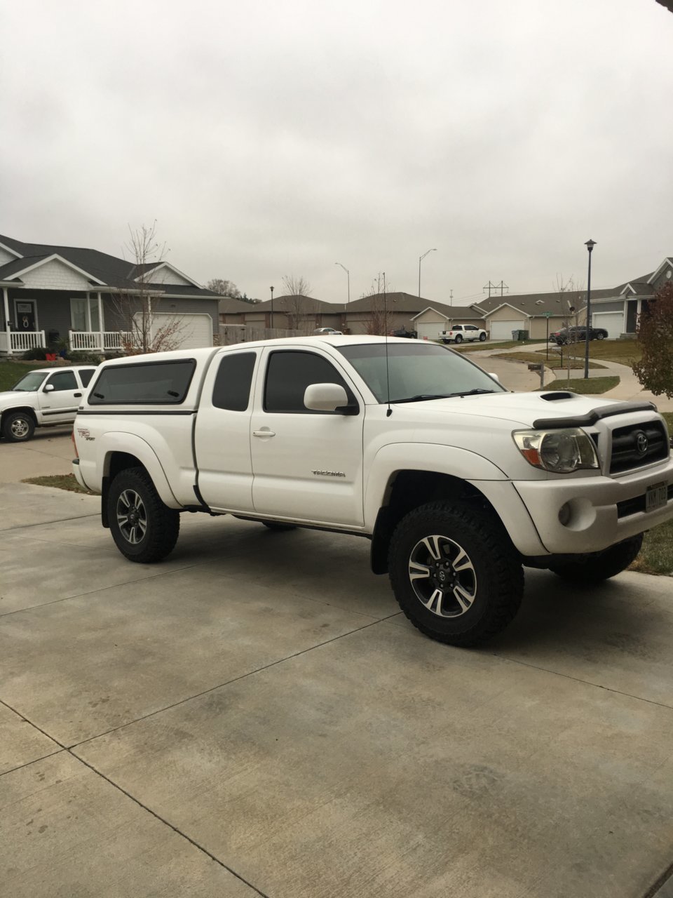

    255/80/17 st maxx483F29A7-0126-496B-B21D-E48B19F1BD34.jpg
