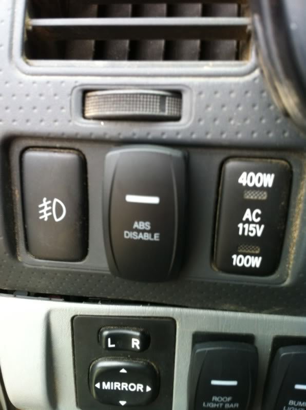

    Did mine today, after procrastinating for to long. All in all took around 45 , with sottering and trimming the switch to fit.
    Light comes on with the switch flipped then off when I hit it again
    Switch placement
