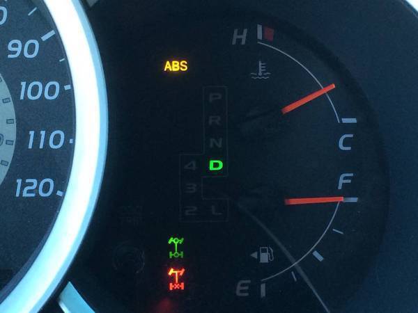

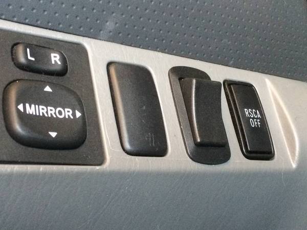

    many thanks to everyone who has posted these abs mods. with all the snow we're getting in colorado, it's a lifesaver. slamming on the brakes on snow is easier on my nerves now that i can get rid of that blasted abs.
    i have a 2007 trd sport, dcsb, 4x4. plain. no VSC, no diff lock, no traction control, nothing. you need a SPDT ON/ON switch with three prongs in back so you can ground it.
    i used the switch in the landphil method which is a Cherry KG (P/N KGC2BNB1BBB) i bought from here.
    wired it all up just like you described in this thread with a ground wire.
    here's the switch in place:
    here are the lights i get when i'm in 4x4 and i flip the switch:
    thanks again.

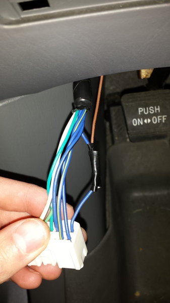

    I bought this truck new. I didn't do this. There's a brown wire tapped into a blue wire. Can't see where is goes. Anyone else notice this when trying this mod?

    I dunno much pudge, but I know that don't look factory. Not even from a Trabant or Lada factory.

    Yeah its crazy. I got it new. I didn't do it. Maybe someone can chime in

    Interesting, follow that wire!

    Just remembered I had a remote starter put in. That must be it.
