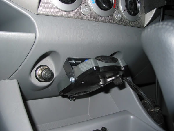

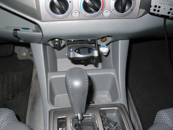

    Where to Mount an Electric Brake Controller? Where are you guys putting them? I drive a 2011 Quad cab... Pictures would be awesome

    05 DC 4x4 here's mine. Prodigy brake controller. Mounts perfect so I can reach the manual actuator if I need to on long downhill grades.

    I mounted mine under the shelf where you have your garage opener.
    I was concerned I would be hitting it with my knee all the time (I'm 6'5").
    I think I've only bumped it a couple of times. You want to be able to get to it easy enough so you can hit the brakes manually.
    I also have a lower profile brake unit than the one pictured.

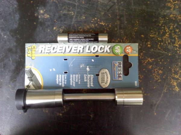

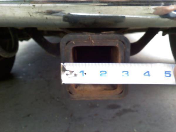

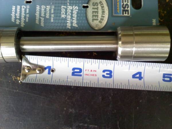

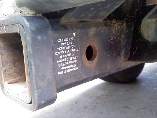

    hey OP i hope you don't mind me doing this. but i have seen wear some people are having hard time finding "LOCKING" hitch pins. like wrong size and stuff. i took some photos (sorry they are off the tundra, my brother has my truck right now. but i think everyone can get an idea) i think it could help allot of people.
    ok first i measured the end. FYI 2gen Tacoma's have a bracket wear the pin goes so it makes it 3"
    on this photo ou can see that wear the pin goes is smaller than the end. the pin on the tundra is 2 3/4x 1/2 the tacoma it the same as the end. making it 3 inches.[​IMG]
    the pin i got at wall mart. [​IMG]
    this is the part that has to be 3 inches! on the tundra it is 2 3/4 [​IMG]
