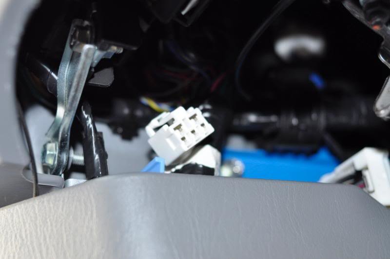

    New owner of '14 Dbl Cab, v-6, tow pkg. Can't find factory brake controller harness. looked driver side kick panel both above it and behind it. Even had the Toyota service rep at the local dealer look for me since I thought it must be "obvious" but I am just missing. Any help/suggestions?

    The dealer did not find it???
    they are boneheads.
    take off the panel, is in there.

    So, this is what you are looking for. It has a a very short lead. Keep digging, it took me a while, it was tucked way back.
