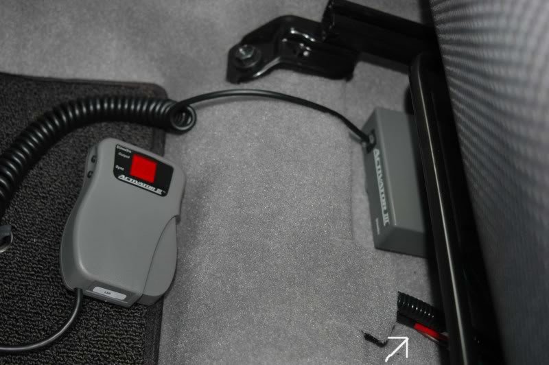

    Any recommendations for brake controllers??? Have a v6 dcsb with the or pkg and 6mt
  8. Feb 9, 2020 at 12:09 PM
    #1748
    jpereira2
    jpereira2 Well-Known Member
    Dec 20, 2013
    #118928
    6,366
    Jason
    Massachusetts
    2013 double cab trd off road
    Bilstein 6112 4th notch Bilstein 5160 rear Camburg ball joint UCAs Old man emu dakar leafs 265/75R16 Cooper ST Maxx Crux stereo a/v interface UltraGauge ARE fiberglass cap Wet okole seat covers Retro fit source Led fog lights Superbrightled pods in rear bumper Superbrightled light bar in grill Rock blokz mud flaps SOS Rock Sliders RCI Skid Plates (to be painted and mounted)
    Tekonasha p3 is what I use. 2013 towing 27ft travel trailer

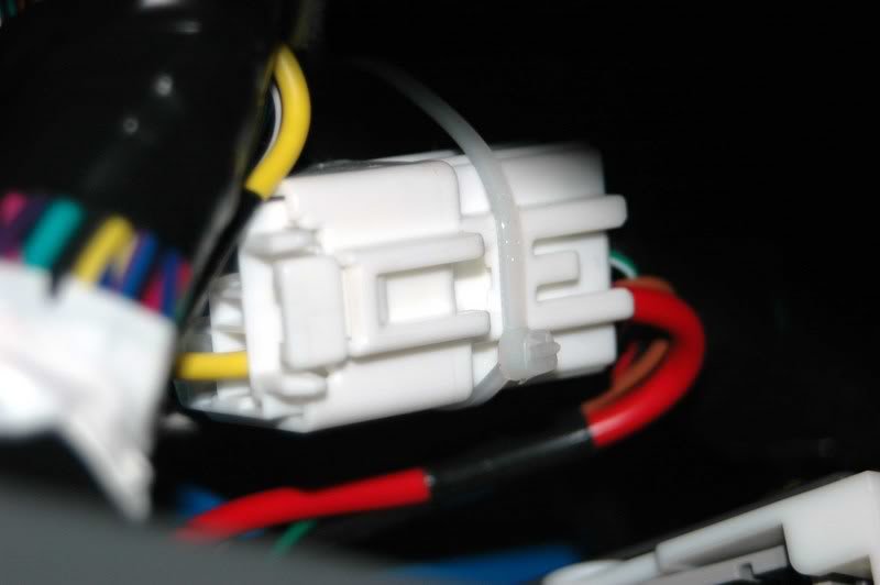

    Does anyone know if the harness is still in the same location on the 2012 model? Though I did not buy my truck new, I'm pretty sure it does have the factory tow package. In my initial peek under the dash I did not see any unused plugs hanging around.
    EDIT: Never mind, I finally found it on my third attempt. Damn thing was buried 8"+ up and behind the wire bundle.
