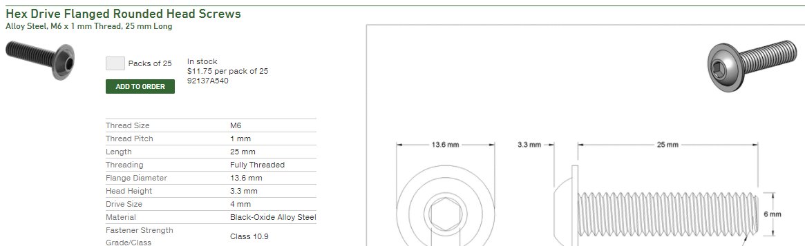

    Looking for the torque spec for the bed cargo rail/track torx bolts. Been searching without much luck.
    "snug" is probably good, just don't want to over do it since they attach direct to the composite bed.

    7.5 N.m (66.5 Lbf-in)

    Not a toyota part number exactly, but here's a compatible bolt
    https://www.mcmaster.com/#92137a540
