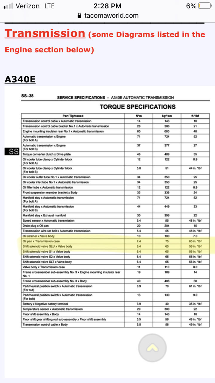

    Want to back myself up here. About to drop and clean the transmission pan and filter. Pan is attached to the case with 22 10mm bolts.
    The torque spec appears to be 7.4 Nm or 65 INCH pounds. My torque wrench has no inch pound markings only foot pounds, and lowest Nm marking is 13.6. This appears to be an incredibly low torque setting. Should I just hand crank these and maybe go a fraction of a turn beyond with my 10mm socket?

    That does equal to about 5.25 ft/lbs.....even that seems a little small. Which page did you find that on in the first post?

    On the original post, had to do a text search to find it:

    Good on you for accepting the torque value (and not arguing it).
    Oil pan bolts typically use very light torque. In fact the majority of oil leaks at the pan are from over-torqueing the bolts. Far too many shadetree mechanics think more torque is better. Definitely not the case with thin stamped metal oil pans!
    The gasket is to stop the leaks, not the bolt snugness.
    Nothing wrong with investing in an "inch-pound" torque wrench. It may not be the most used tool in your box, but it may be one of the most important ones.

    I did end up buying one, and the transmission pan is still the only location I’ve used it. But that’s ok, any excuse to buy a new tool.
