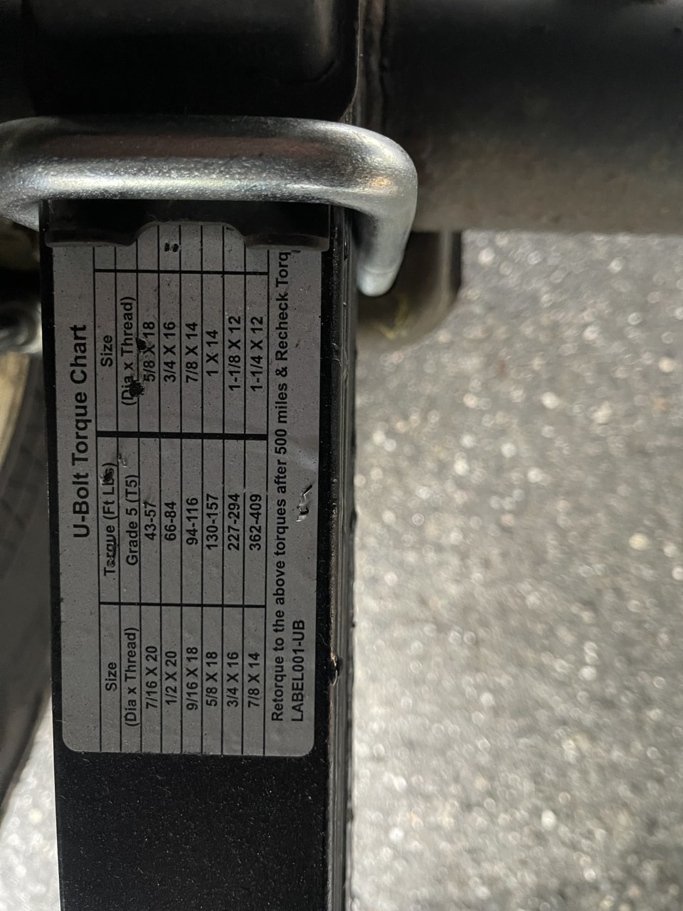

    on page 1 of this thread under rear suspension components correct me if I'm wrong but it looks like the torque called out for the u-bolts is 37ft lbs. wtf? I thought it was around 90ft lbs. :crazy:

    For the oem U-bolts.....yes......for the aftermarket ones no. The oem ubolt is thinner and the nut plate is mildly adequate......I have the Wheelers U-bolt flip kit and the U-bolts are 1.5x thicker and it has a 1/4" steel plate for the nuts.

    Thanks, didn't realized the oem ones were that much thinner (they were only on the truck for a month.)

    Man I was thinking the same thing. I torqued my Deaver springs to 100 ft/lbs, to see 37 was concerning. On the Deaver springs it states their required torque.
