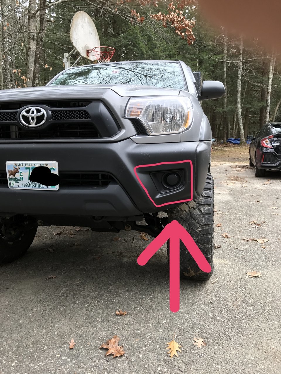

    Has anyone seen a fog light that fits this shape before? Can't find one online

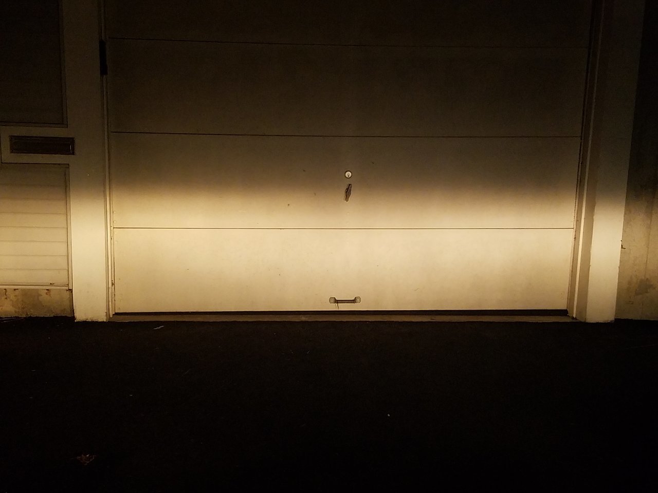

    Just installed 1 H11 Nokya Clear 75W Bulb in the Driver's Side Fog Light, and in the Passenger Side is an H11 Sylvania ZXE 55W Bulb. I will be testing these on the garage door tonight once it gets dark. I just took a look at them in the Daytime on the garage and although tough to see the Nokya is definitely brighter. Stand by for night shots :D

    Here are pics of the Bulbs, left side is the Nokya, and in the right the ZXE

    So without a light meter it looks the same to me, taking pics standing in front of it. Taking pics on the garage door, I do not notice any real difference.

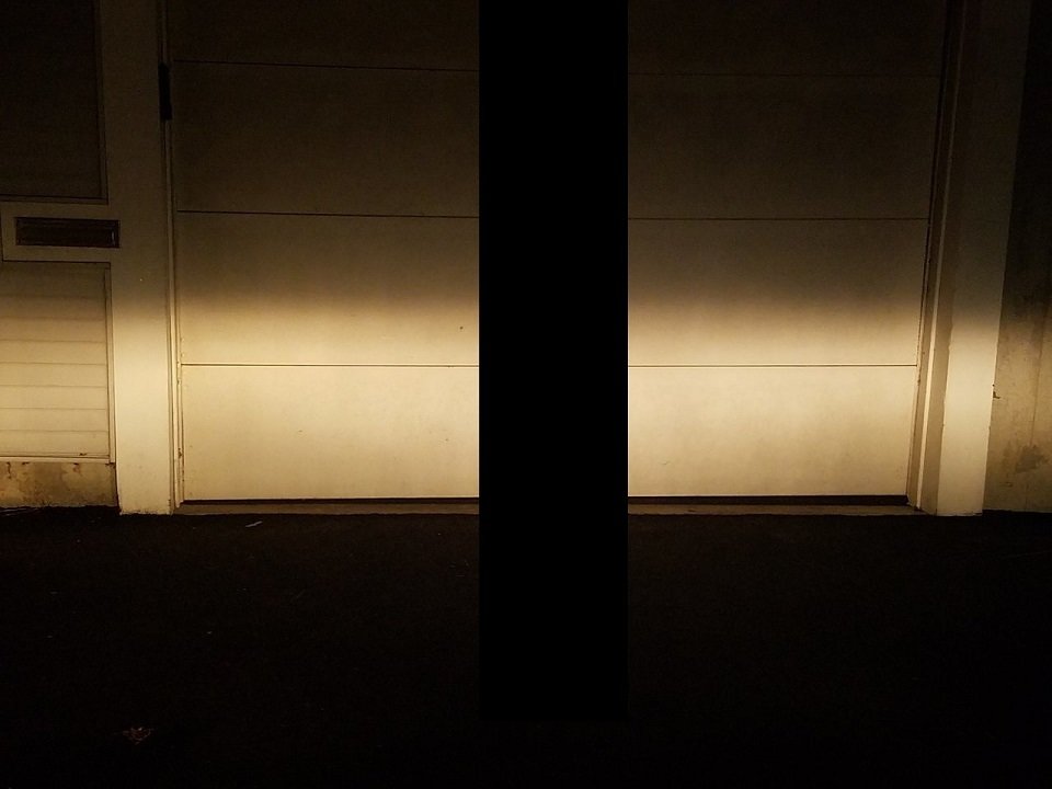

    Hard to tell based on the picture. [Note these are not the 90w Flosser harnessed bulbs from the original thread]
    If you black out the middle portion of the picture to eliminate some overlap, it does look like there is fuller beam coverage in the lower portion of the beam on the driver side, especially the outer corners. Somewhat difficult surface to tell on though, it would also help to judge being a little further away from the wall.

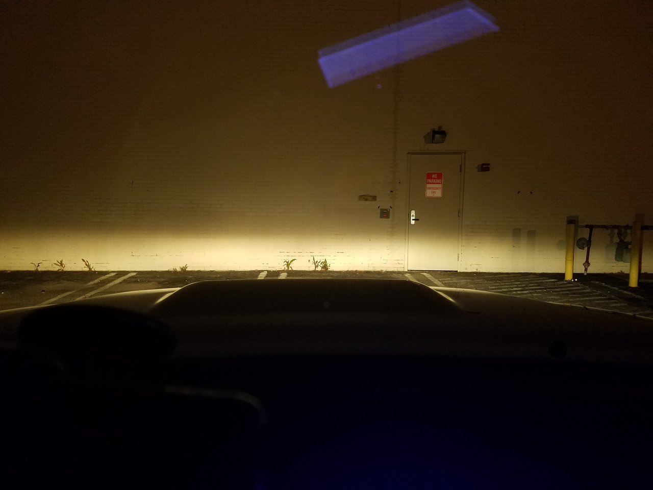

    Just took this one at the Mall

    Admittedly those don't look like much difference. Just above the scoop on either side, it does look like the driver side is slightly fuller vs the passenger side has a more concentrated hot spot. But maybe I have been staring at it too long.

    I do see some difference in brightness on the wall on the Driver side, so I'll put the other one and take a new pic
