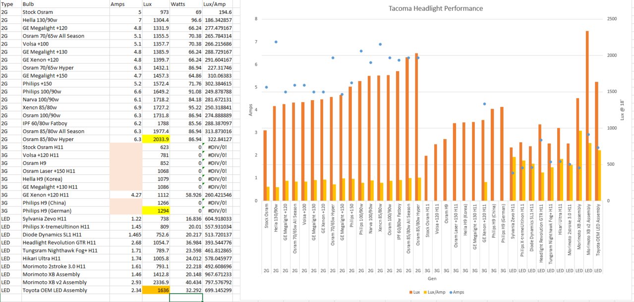

    Output comparison chart with combined data from 2nd and 3rd Gen threads from @daveeasa. It is worth noting these numbers are all run from 13.8v, using a harness for high wattage bulbs should return ~10% higher output numbers. And the voltage booster would bump the numbers even further.

    Well, shoot, here I was assuming they would have 2 or maybe even 3 projectors and show up ready to play ball, sounds more like they are just dipping a toe in to check the temperature?
    Chart with the XB's added since they are of recent interest:
