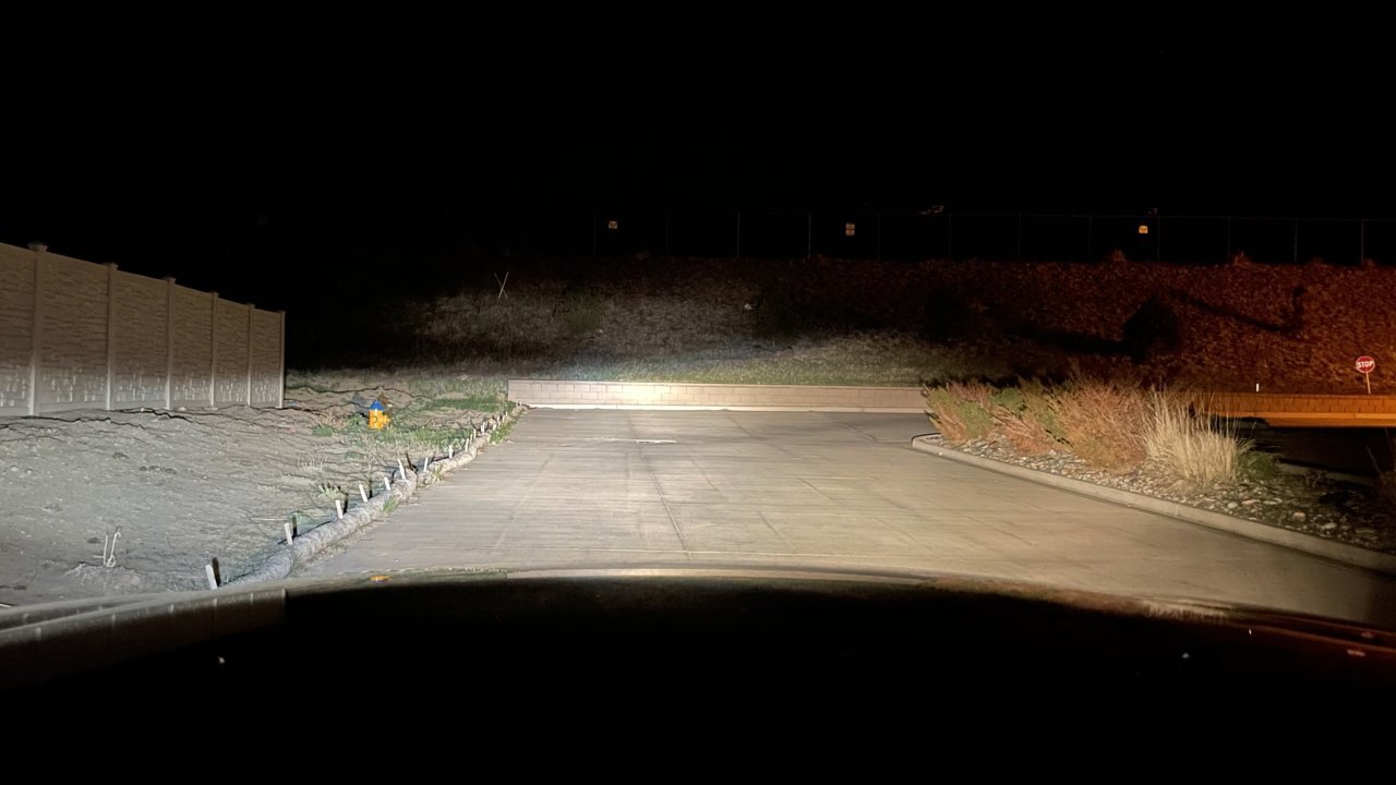

    Awesome. You didn’t mention it in your post, so I was just clarifying. The output gains are from the boosted alternator, not the battery.
    Good side-by-side in your previous post. Light is super difficult to accurately photograph, higher color temps always end up looking brighter in photos than in real life since whiter is mentally attributed to brighter in a photo, but in real life it is far more complicated than that obviously.

    Thats a pretty good comparison photo. To me there a much more visible hotspot on the clear bulb than the CBB. Could just be the camera not picking it up very well. But either way it would be an improvement over the stock bulb for sure.

    Oh yes! Shoulda put that in there for sure! Yes, overall just a ton better. Even before when I had the CBB in before the battery abs boost change, they were just not relevant. Now, they’re usable. I can tell a big difference. The boost is needed if anyone plans to use tinted bulbs.
    Agreed on the pictures. Dad has some very very poor bulbs on his truck and the pictures I took lit up the whole street when in reality, I could see nothing...
    There is a bit of a hotspot on the clear when close. But past a distance, it’s clear. Overall these two are good stuff. But, to go this far, may as well go clear lol get the best light ya can!
