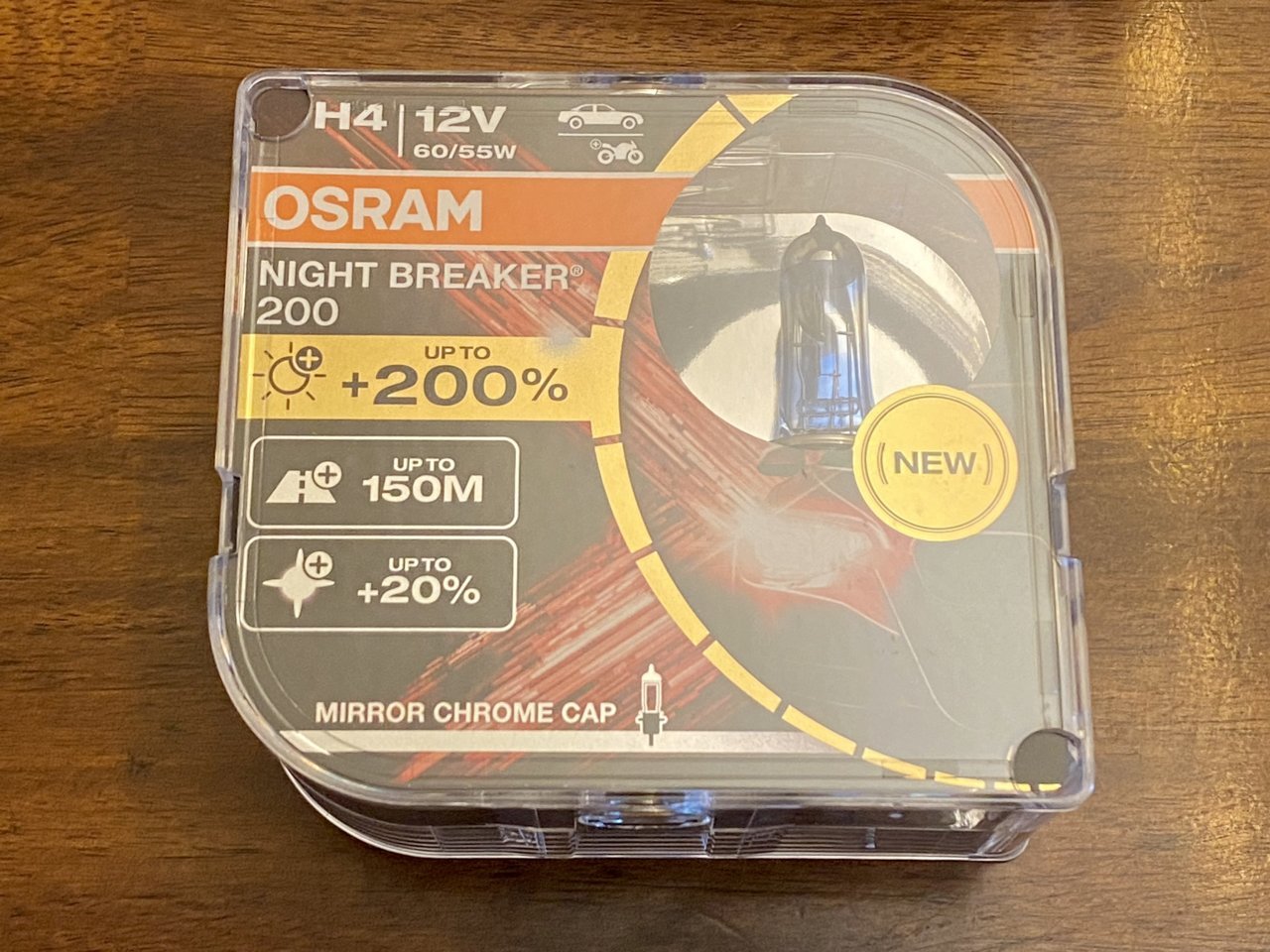

    The bulbs arrived this afternoon via USPS and are, in fact, as advertised. They were packed well, in a sturdy cardboard box, bundled together (as shown), and wrapped in packing paper.
    Less than $22 for four German-made Osram Super Bright 100/90w 2900 lumen H4 bulbs, delivered in only four days, seems like a great deal to me...

    Installed the Osram 200s yesterday, and my eye-crometer says they're brighter. Can't wait to see the test results
