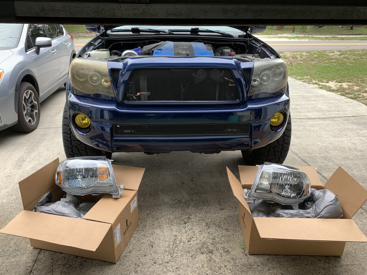

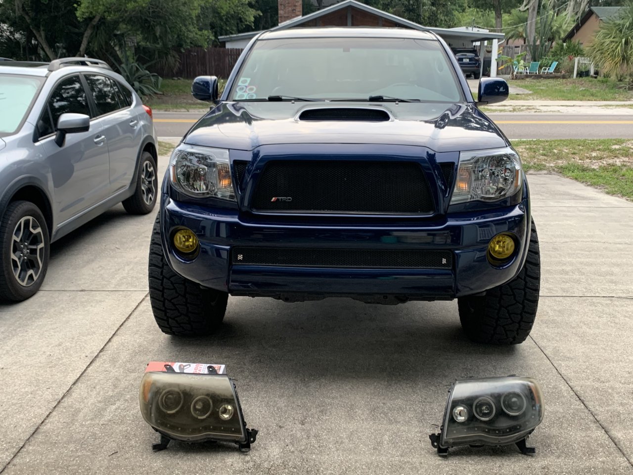

    I swapped out my older retrofit headlights with the stockers today. First I had to open them up to get rid of the chrome bezel.
    Definitely enjoy the clean look again. But I need to swap out the bulbs for sure.
