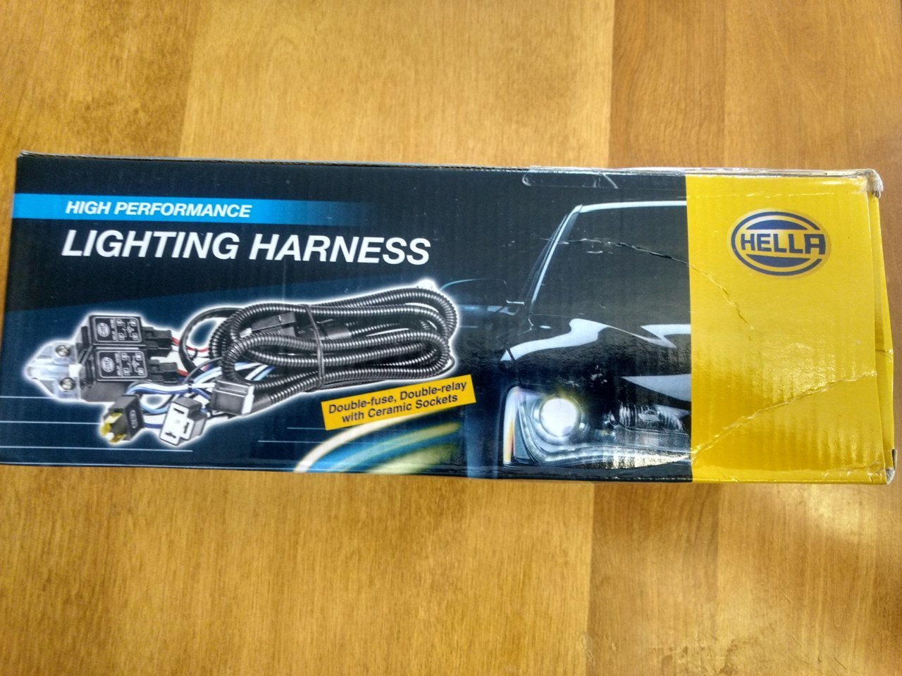

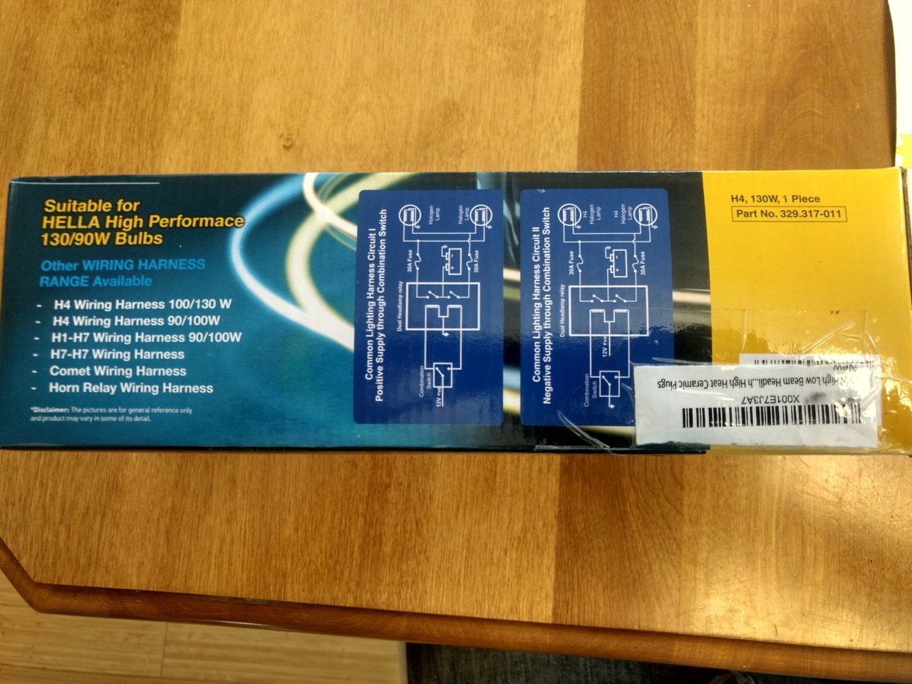

    I ended up with a Hella harness off Amazon that cost me $35. Install was pretty easy despite no instructions. I just need the correct size bolt to mount relays to frame. We'll see how well it works once new bulbs arrive.

    Thank you crashnburn- Yes I was either going to disable the drl or look into finding different relays. On a side note, blackie seems to have the same harness as me judging by the pics he posted. Very good write up in the original post and definitely the most sensible headlight mod I’ve seen so far.

    this looks likea decent setup for $35

    While I’m not familiar with this specific harness, it is similar to others in price point like Morimoto (though Morimoto lacks ceramic connectors).
    Keep in mind the performance point of the harness is to reduce voltage drop, this is done by having a direct connection to the battery and using significantly oversized wire (12awg) for higher efficiency.
    Inexpensive wiring harnesses usually use 18-16awg which is close to stock, not providing the gains of increased voltage due to heavy gauge wiring. You may get a small increase due to a more direct connection to the power source. Keep in mind the 12awg harnesses are only gaining ~0.3-0.4v. Also local grounding isn’t as ideal as return to home and usually done as a cost cutting measure. To do a quality local ground you should remove paint from the sheet metal at the contact point.

    cannot find hardly any info about the specifics with this harness other than its made in India, and I ran the part# only one I saw for sale is AMAZON.com in INDIA
