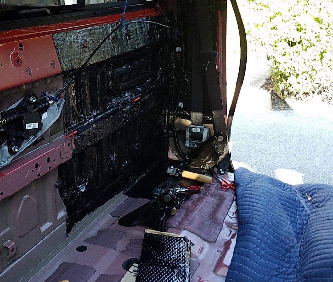

    Headliner insulation / noise reduction

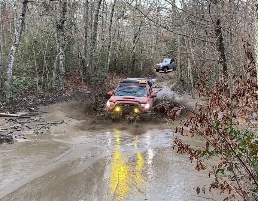

    Currently
    https://youtu.be/yK_KeRgHSyc

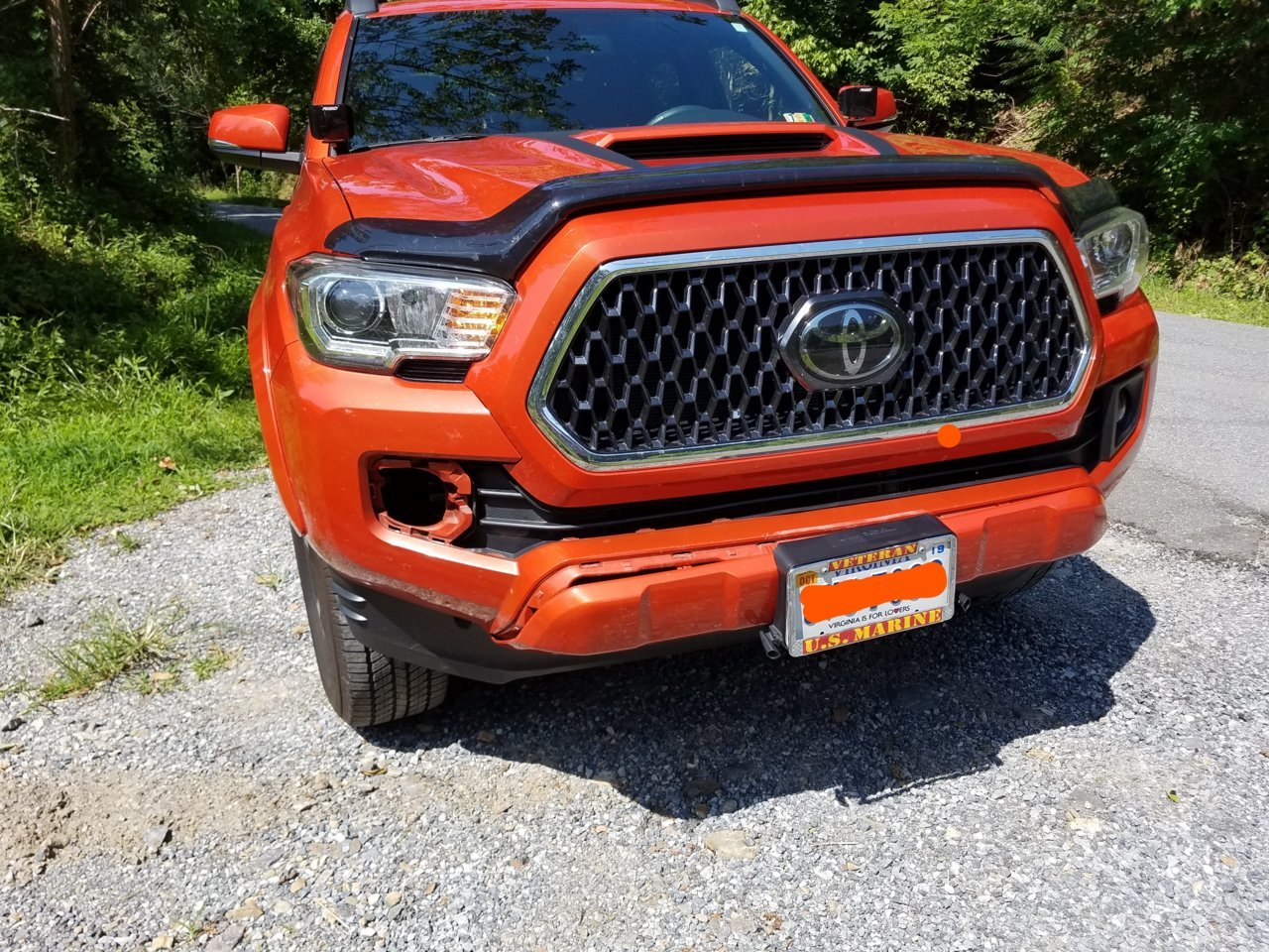

    The next few mods were from Weathertech, in channel window vents and bug deflector, and Morimoto LED fogs. Then some Rigid ditch lights on the hood, which you can see in the pic of the motivation for the next mod. Caught the rear legs of a large female deer on the way home from work. Pushed the fog lamp in, but kept it, and it still worked. New surround for the light, and some epoxy for the broken clip, and pushed it back together. Got lucky.
    Time for some not completely thought out defense. Armodillo brush guard.
    This is a bolt on and bolt together. It was a quick solution, but probably not the best one. One thing this forum has been good for is learning. The way this one mounts, it may take out the radiator and / or mounts if I catch another deer with it. And I was half way to the price of a steel after market bumper, and really didn't realize it. There is one planned for the future.

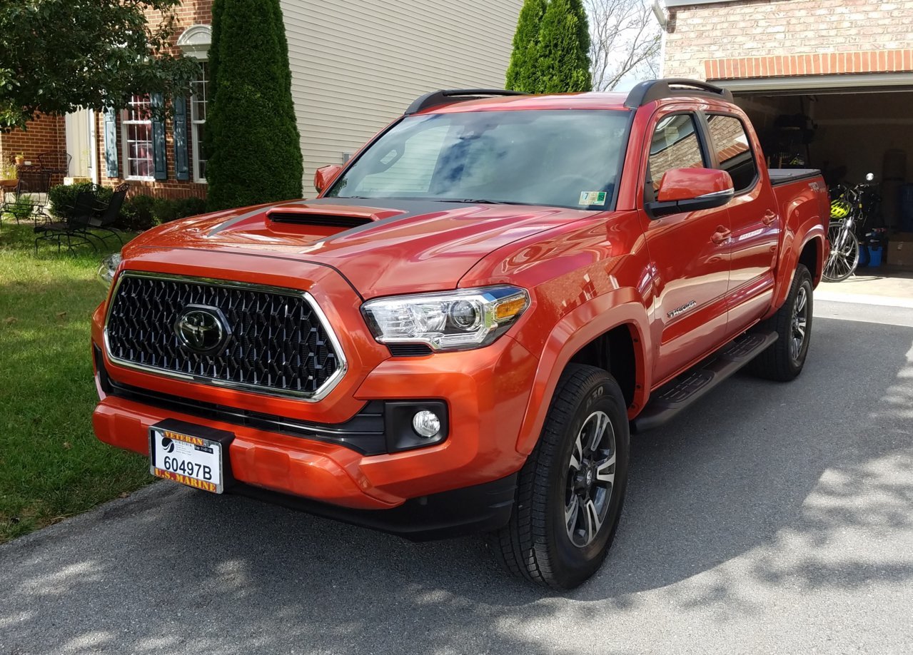

    Severe weather in the forecast: Garage test: it fit! (The back up camera was very useful!)

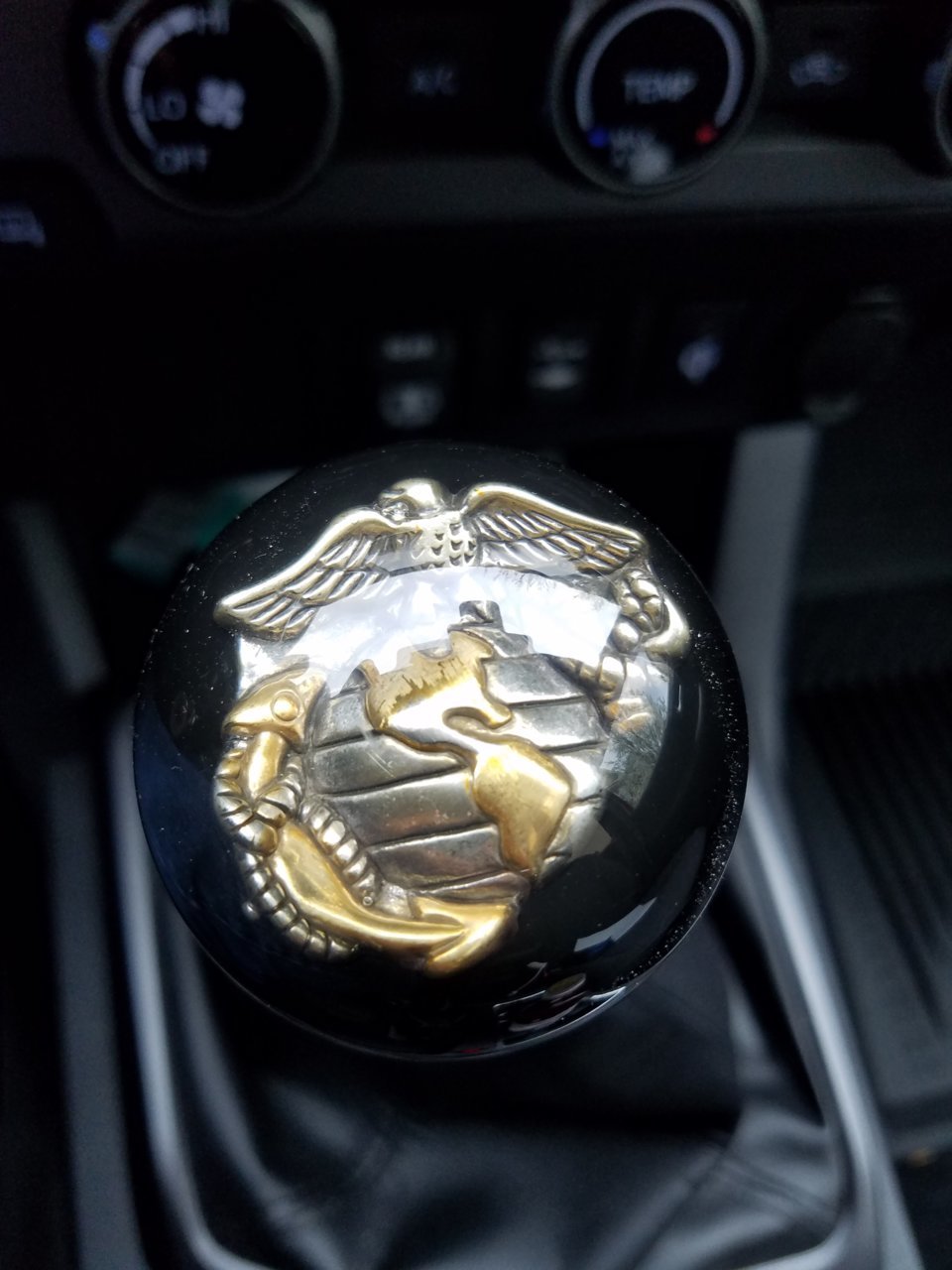

    EGA set in resin. One of my favorite additions. Great look and a nice feel when shifting, or just resting the hand there.

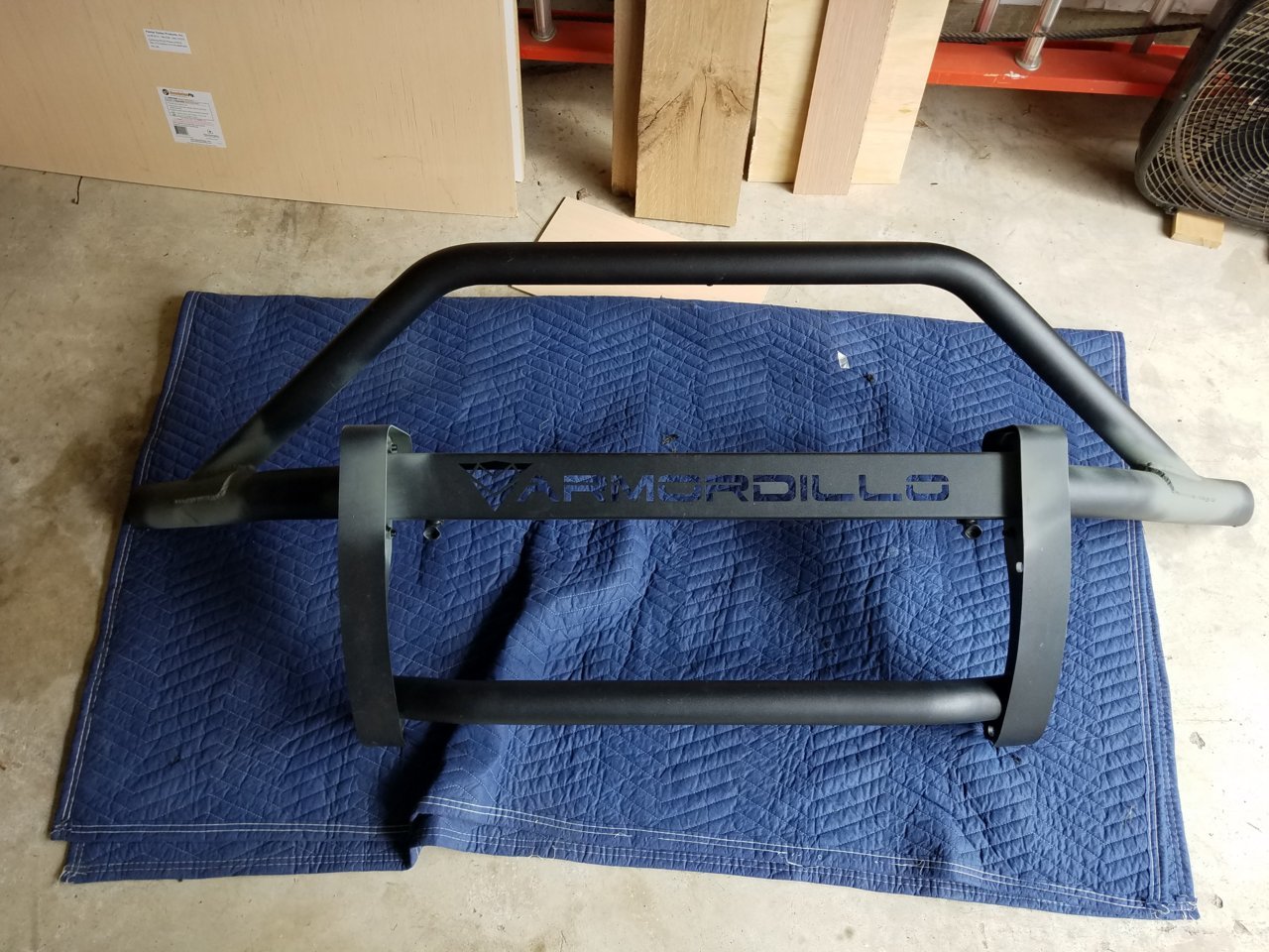

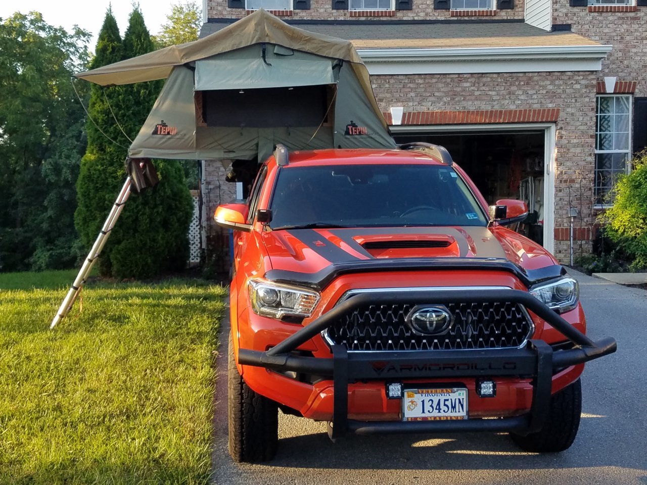

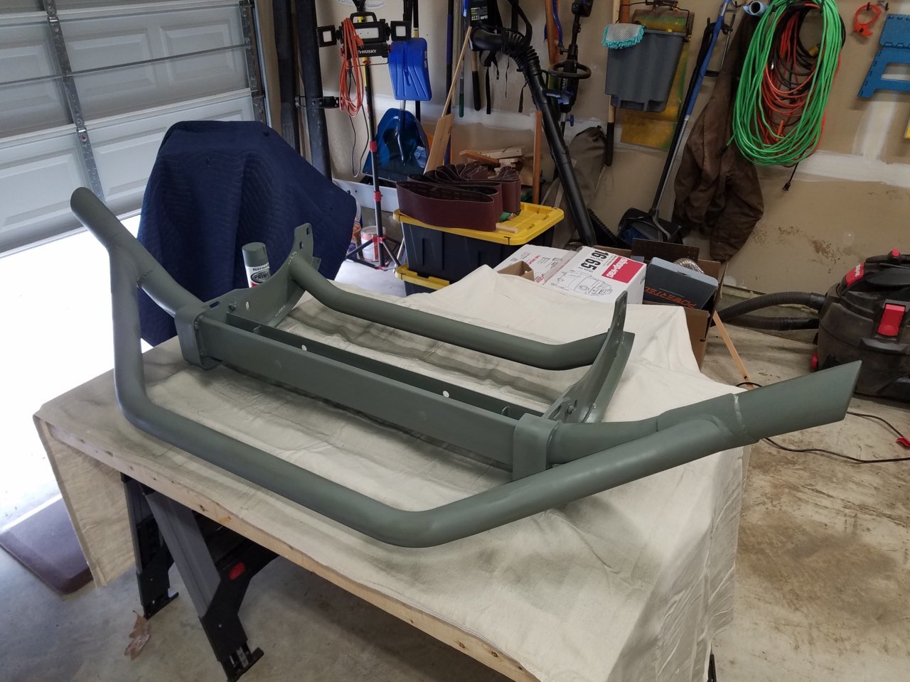

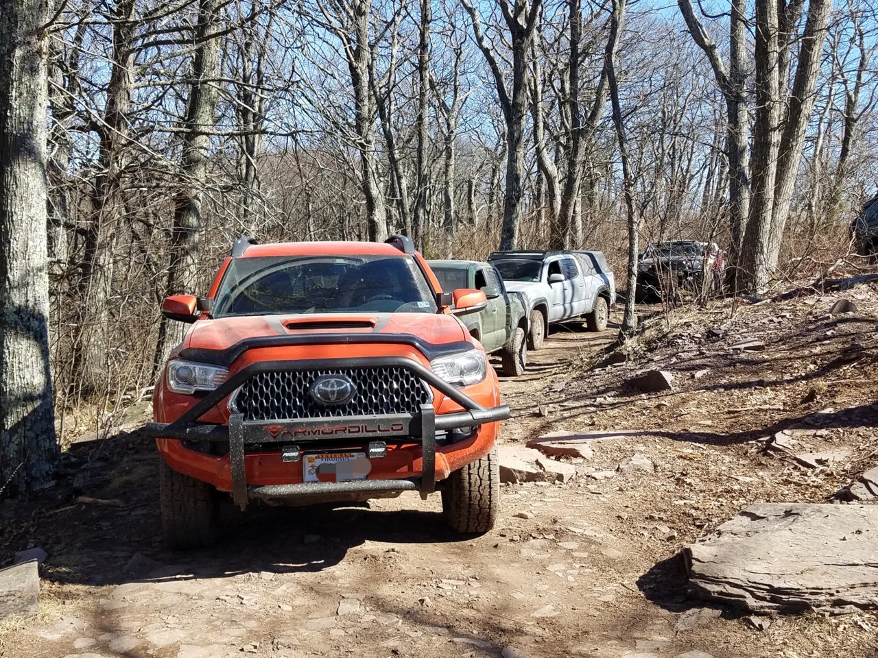

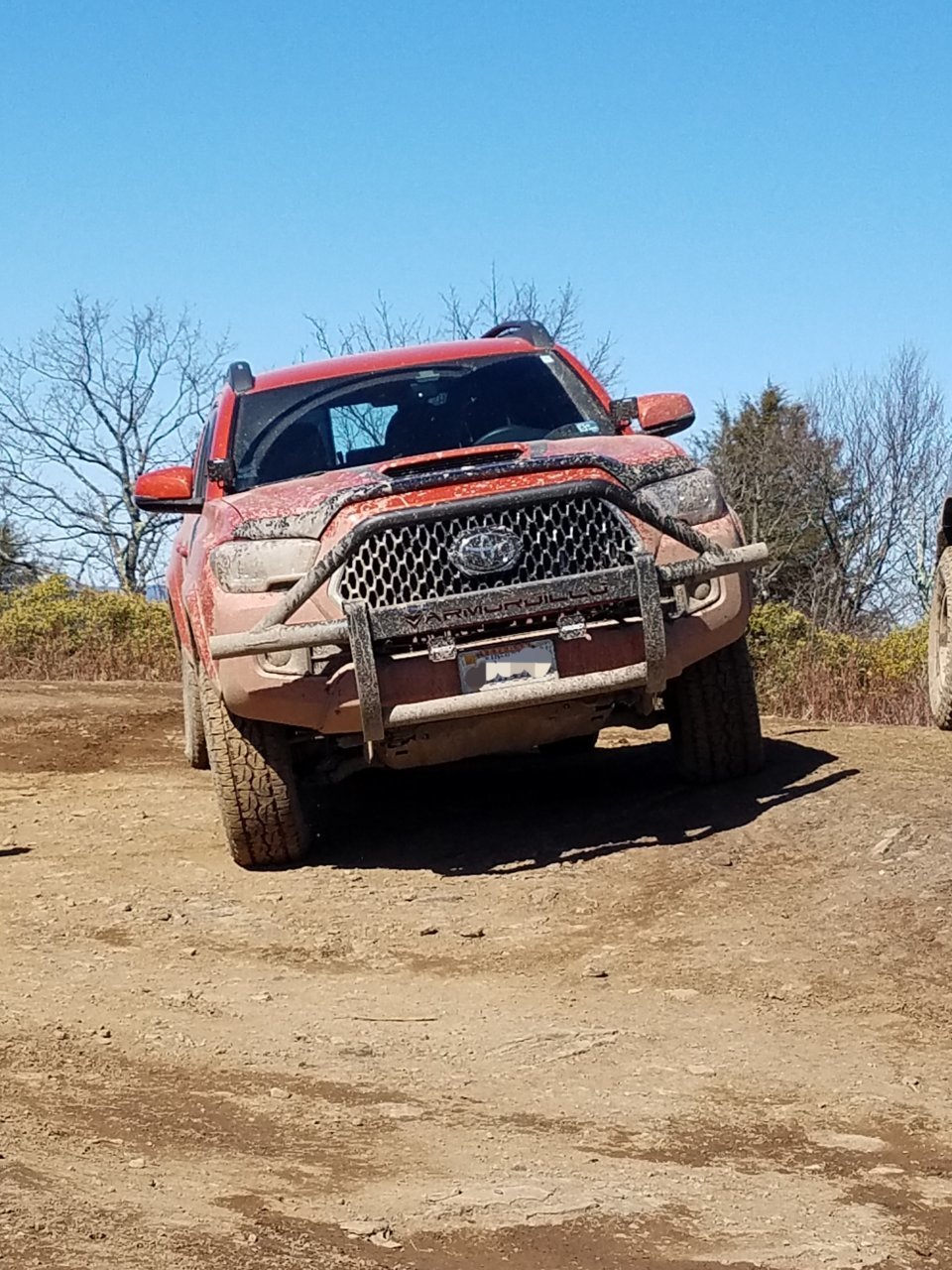

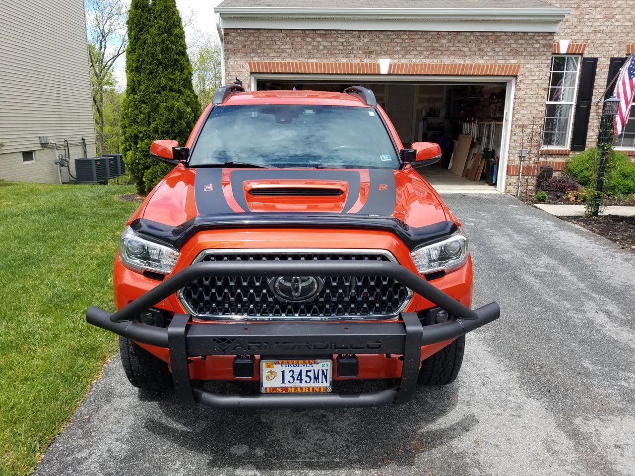

    The brushguard from Armadillo. This is a bolt on and bolt together. It came powder coated, but not properly drilled for one of the anchor points. I contacted the manufacturer and they were out of replacement parts with no ETA on production. So we negotiated a $150 refund and I had the whole unit welded by a nearby friend.
    Post weld. The left side is where the holes were misaligned.
    Sanded and primed.
    I also blacked out the mounting hardware for the amber Rigids. I also rotated the lenses so the "Rigid" lettering would be right side up when mounted. I went back later and blacked out the covers.
    A little Rainx for the lenses.
    Re-mounted with a fresh wash and wax. (Just to get it really dirty a short time later.) 20200309_163618 (2).jpg

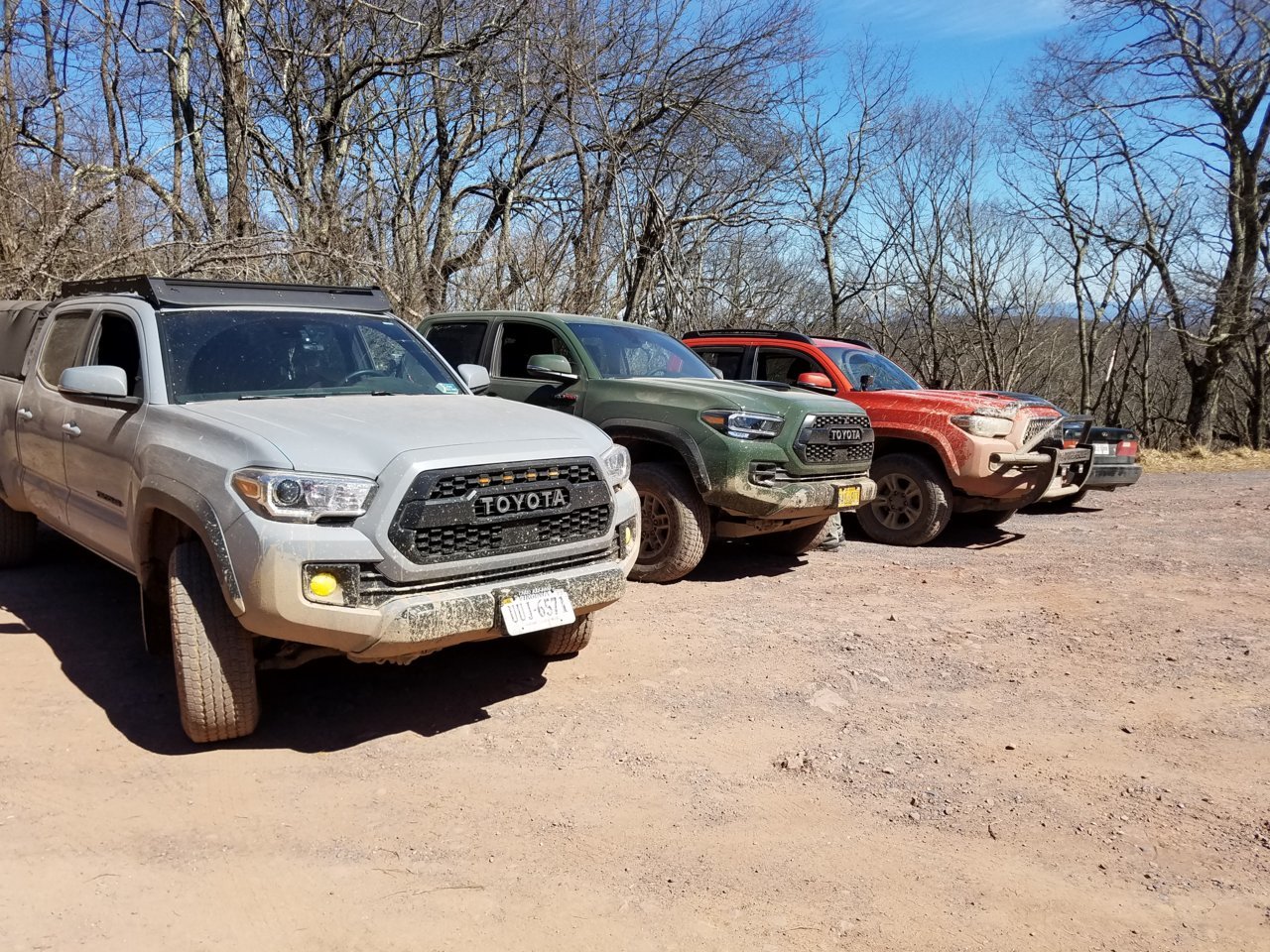

    An application of my first trail mud. (And favorite mod!) Flagpole Knob with some local TW folks who were kind enough to take three noobs in stock 3rd gens along for the ride.
    20200308_173136 (13).jpg 20200308_173453 (15).jpg 20200308_131308.jpg 20200308_130631 (8).jpg 20200308_140329 (11).jpg

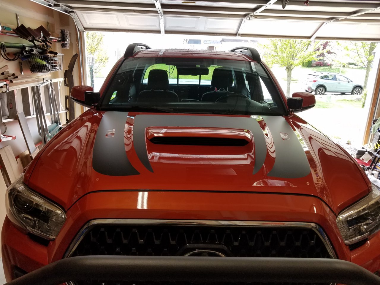

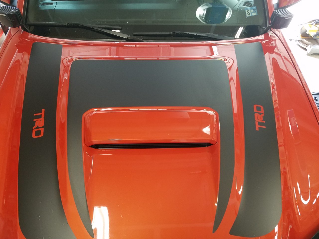

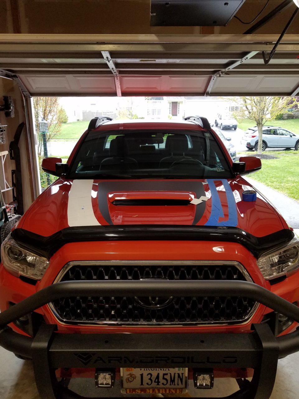

    Now for some fun. And glare reduction from the hood. I started with some tape, then some heavy wieght cardstock to get the shape I wanted. My wife then scanned the template in to her computer (she's crafty, pun intended). She downloaded the TRD logo and added that, cut it all out of an automotive vinyl, and helped me get them on. She had to recut the drivers side as I really messed up the location. Overall, pretty happy with the look, and the glare reduction.
    I had already laid out the tape, and now working with the card stock to get the template.
    I only needed one template as I could just use the mirror image for the other side.
    Finished product. I was left with a few air bubbles, but a day in the sun took care of those.
    20200506_134345 (35).jpg 20200506_135028 (38).jpg 20200506_135702 (41).jpg 20200506_135652 (40).jpg
    Glare reduction achieved. I still have some, but now it is much more diffused and easier to deal with. It was really bad between the scoop and the creases in the hood.

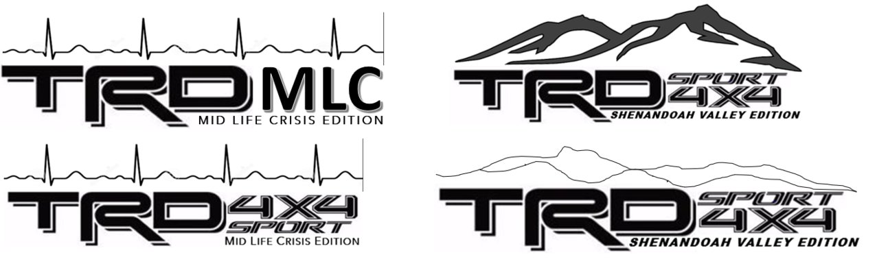

    While we were at it, I had been wanting to do some custom vinyl on the bedside. I had already removed the OEM stuff, and now wanted my own "edition."
    Some ideas I played with.
    What I ultimately went with. There are a few things that are not working well with this one, namely the small points in the compass are beginning to peel up, which we knew was possible. So I am revisiting the design and may change it up a bit. The MLC Edition is still a strong candidate. The air bubbles also worked themselves out.

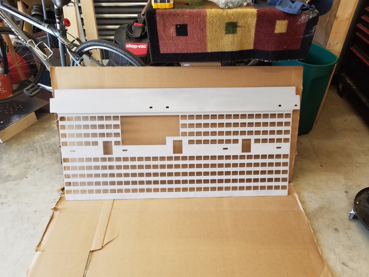

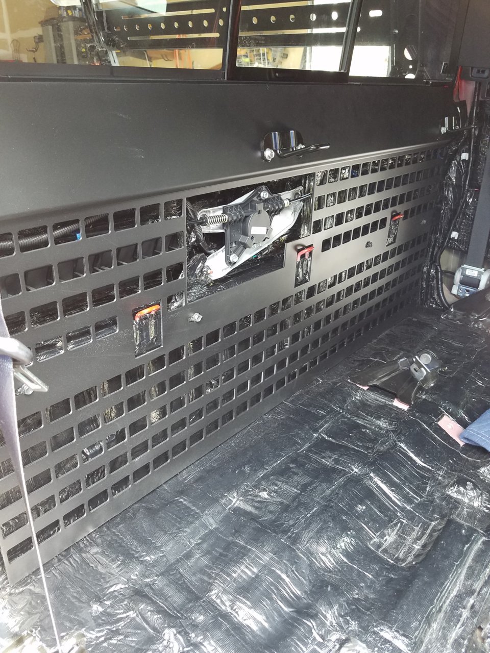

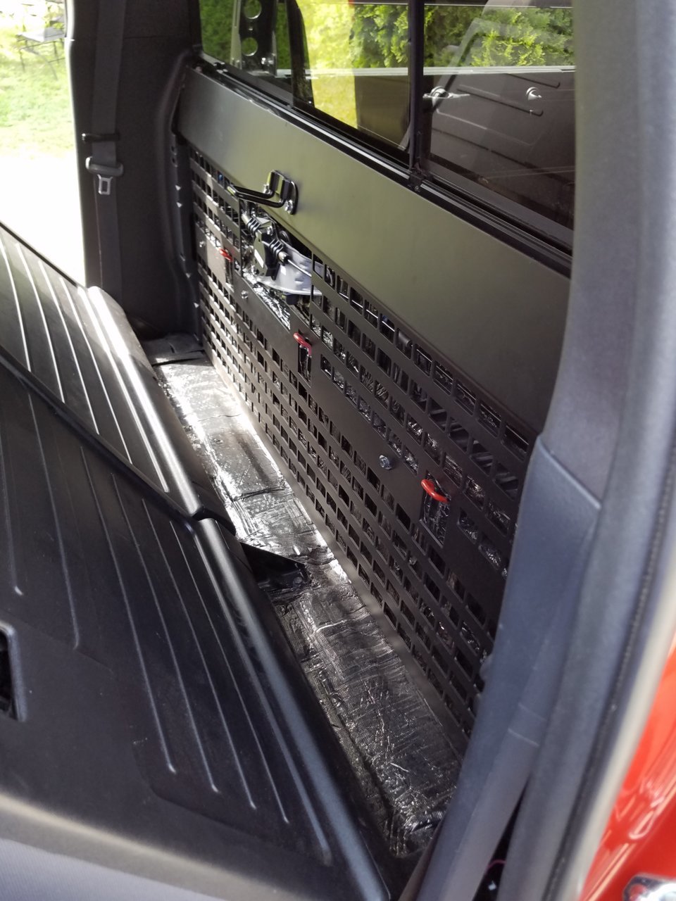

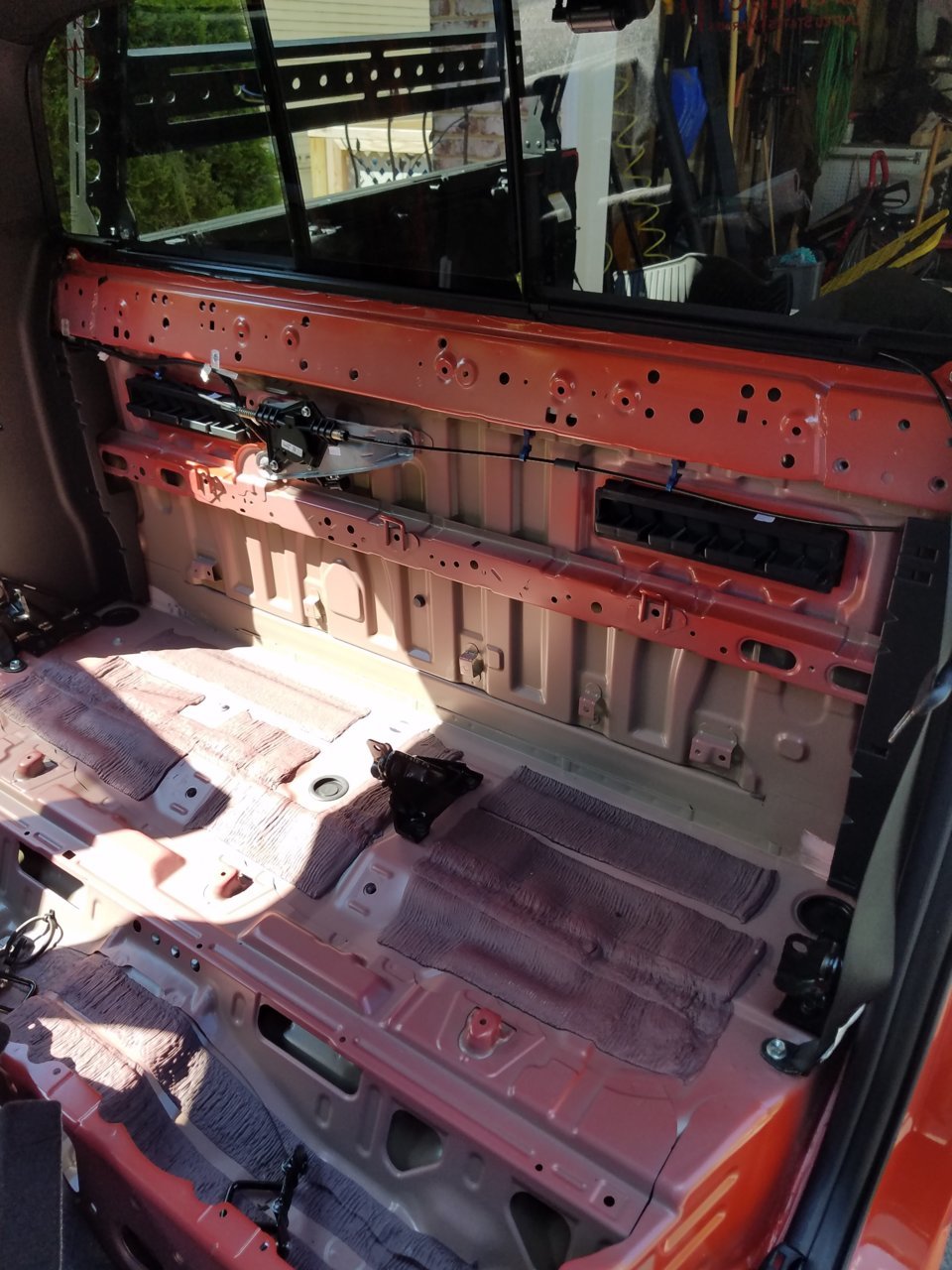

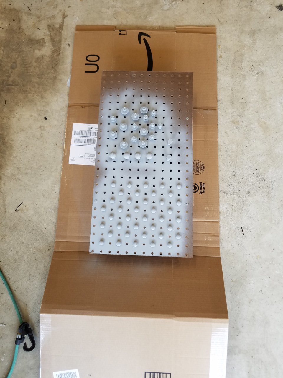

    First big interior mod. I was part of a then recurring group by for a full size molle panel to gain additional storage behind the rear seat. (It has since ended.) I pulled the rear seats, underseat storage, and plastic rear storage panel. I applied some Noico noise reduction, and installed the primed and painted aluminum molle panel. Put everything back in and called it a day. It took two days, mainly due to a late start and 95*, 700% humidity, no breeze, in the sun, on a south facing ashphalt driveway. o_O
    20200810_160140.jpg 20200810_174652.jpg 20200811_134633.jpg 20200811_150723.jpg 20200811_155413.jpg

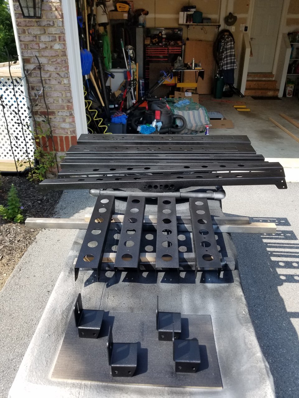

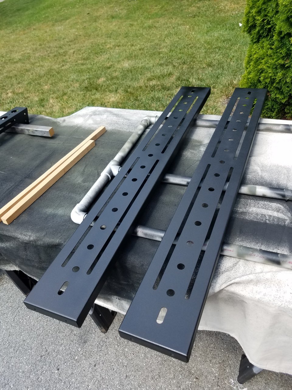

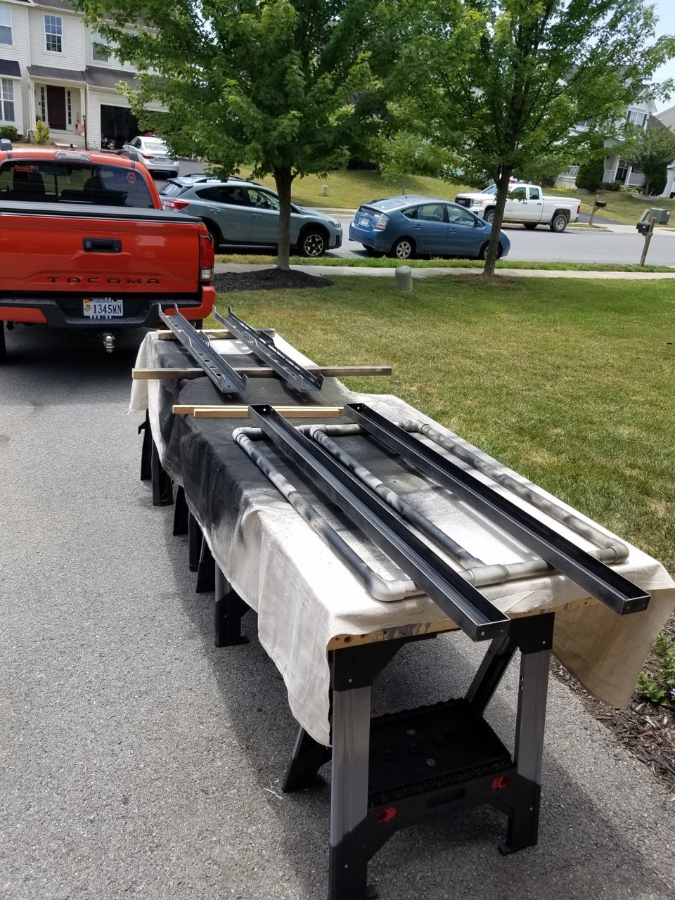

    Thanks to a local TW member, I have a used KB Voodoo bedrack and a Chinesium 270* batwing awning. There was an issue with some of the powdercoat peeling, and KB Voodoo had taken corrective action and replaced the offending parts. I scooped it up for a good price, and went to work on fixing some of the stuff that was coming off. A lot of sanding, priming and rattle can bedliner action. The only issue I had was, again, the humidity. Nothing would dry. When it was dry enough to move, I brought it into the basement hoping that would help. I let it sit for week and thougth I was good. Over all it was, but when I pulled the mounts off for the awning, some of the beliner spray came off. Overall, pretty happy with it. But I am thinking about a mid hieght rack. Time will tell.
    20200707_155303 (65).jpg 20200706_152223.jpg 20200706_131445 (60).jpg 20200707_155313.jpg 20200706_114838.jpg 20200707_155336 (68).jpg 20200714_132818.jpg 20200714_132830 (70).jpg

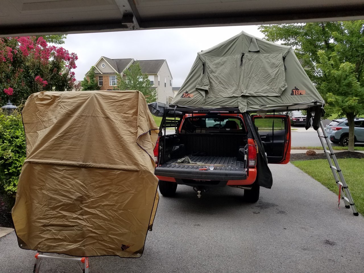

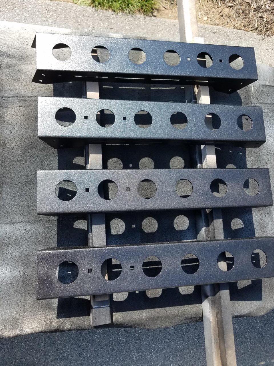

    A short time later, I found something to put up top. Thanks again to another local TW friend for a good deal, a Tepui went up top. I gave it a new coat of water proofing and some new seam tape. Just ordered a double air mattress to go over the foam mat to help with staying cool in the summer.
    20200808_102124 (88).jpg 20200808_181908 (92).jpg 20200808_191248.jpg 20200727_204936 (78)_LI.jpg

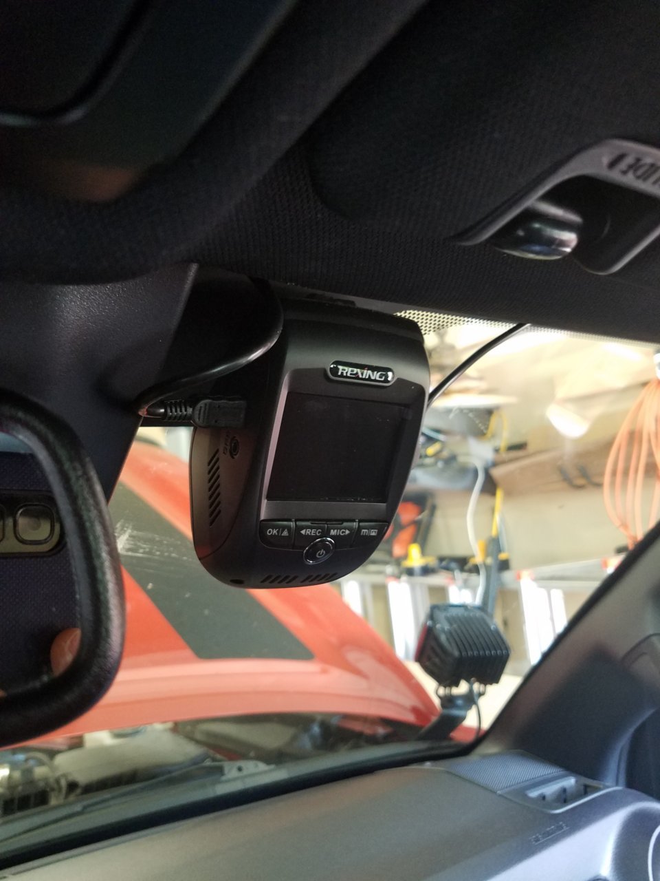

    So, a couple of small projects.
    Rexing front and rear connected cameras. Easy install. More than enough cable for the Taco cab. Using the USB power in the storage compartment. I have a wiring project coming up, and I will hardwire it in at that point. I may have to re-think this if I go to a mid height bed rack. Right now it works with the full height rack. I haven't figured out the video stuff here yet, so a couple of screen grabs from a Veterans Day run with a group of veterans.20200604_121713 (48).jpg 20200604_121742.jpg Capture.jpg CaptureR.jpg
