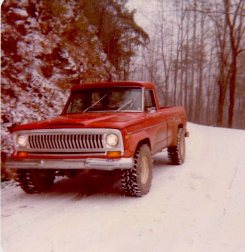

    AWD is great on ice, light snow or mild off road conditions. 4X4 can work in those conditions, but should never be used on hard dry surfaces where traction is good. In more extreme off road conditions, mud, sand, rocks, steep off road inclines etc. 4X4 is far superior. AWD can be used on any road conditions, wet, dry, it doesn't matter. 4X4 should NOT be used on wet rainy roads. AWD generally doesn't have a low range option.
    Many vehicles are made that can be used in AWD. Ford offers an option where the truck is 4X2, and can be switched to AWD for wet roads, and then to true 4X4 for more severe off road conditions. I think Chevy and Dodge offer something similar, but I'm not as familiar with them.
    And this isn't anything new. This 1975 Jeep truck ran in AWD and a switch could be turned to lock the transfer case making it true 4X4. Back in the 1970s most all trucks offered this option. In fact you couldn't buy a Chevy, Jeep or Dodge truck without it. Ford offered both versions. This truck got about 6 mpg city and 11 hwy. When gas prices went up due to the gas shortages of the 1970's manufactures went away from this system to get a little better fuel economy.

    Aldo98229
    Aldo98229 Well-Known Member
    Apr 13, 2019
    #290072
    1,440
    Aldo
    Bellingham, Washington
    2019 Tacoma TRD Off-Road
    That old Jeep would probably be worth like $80,000 now! —then again...so does a brand new Gladiator...
