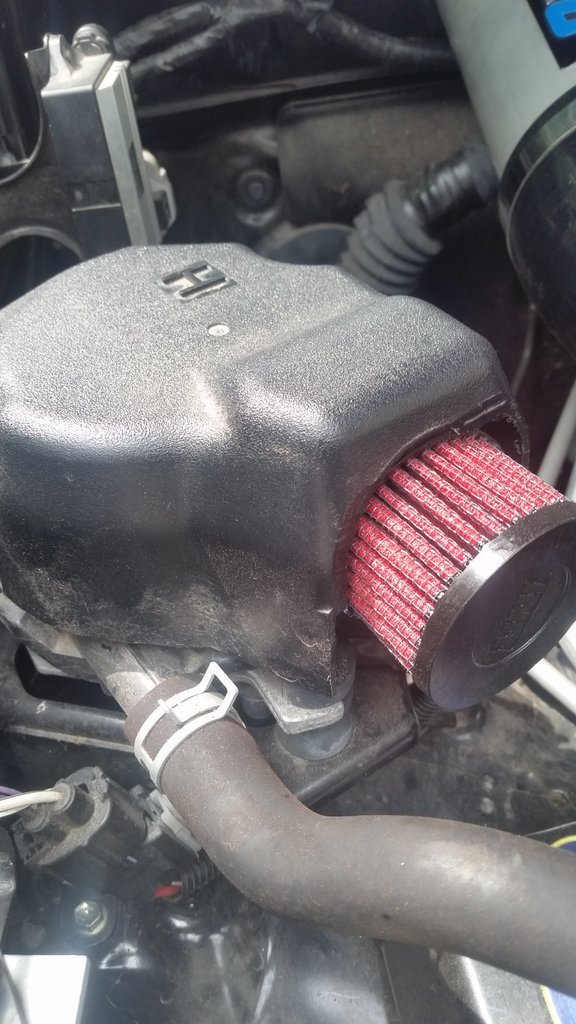

    Two small modifications down.
    Added the Unifilter to that, that, that, whatever you call it thing on the passenger side. You know the one that eats its own filter after a while and costs a bunch to replace. Hopefully I've kept that from happening with this:

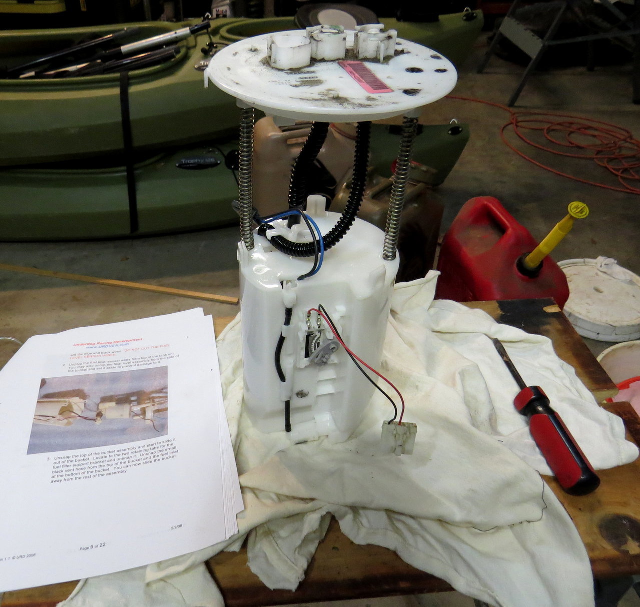

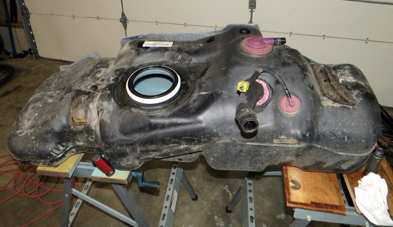

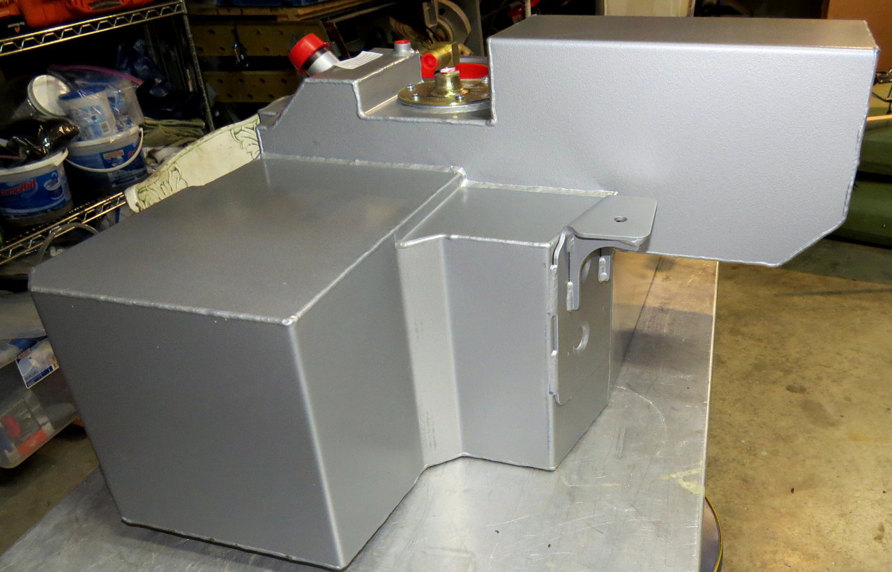

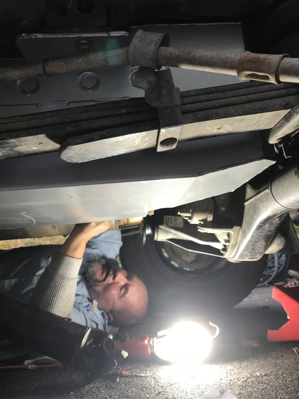

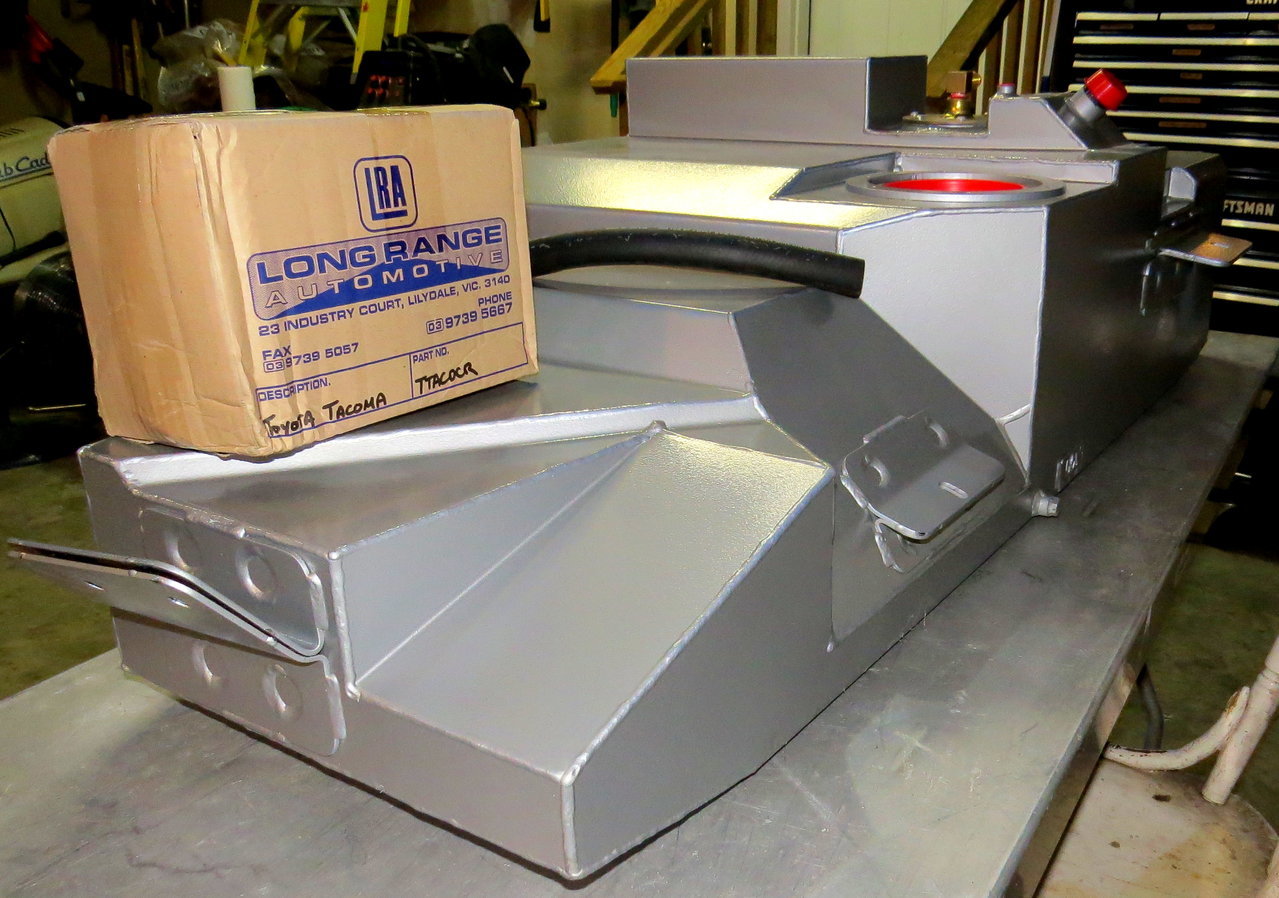

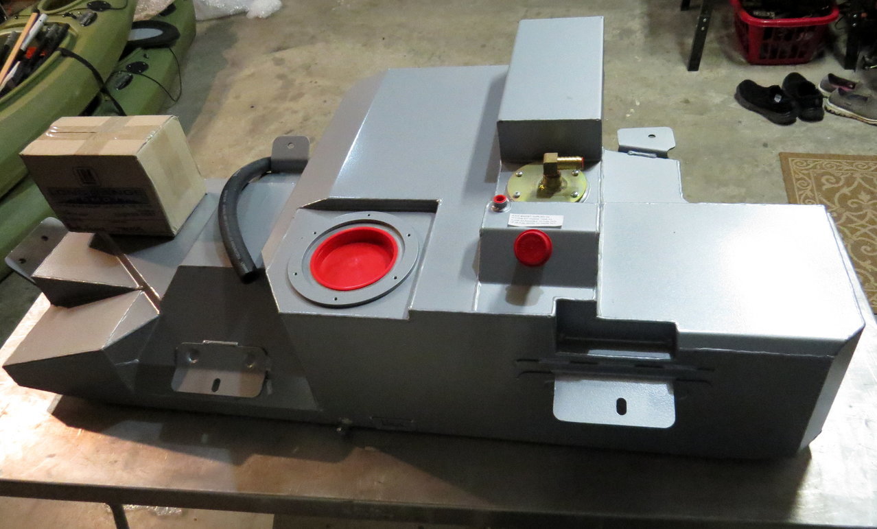

    Two full days. Lots of swearing, some busted knuckles, and a couple of Homer Simpson "Doh!" moments and it's in - despite the rain and cold. The 34 gallon Long Range Automotive gas tank is in. And the truck still runs!
    I'll apologize now for a lack of photographs, this took two 8 hour days to do - I'm slow, I know, but pausing to take pictures and I'd still be out there swearing....

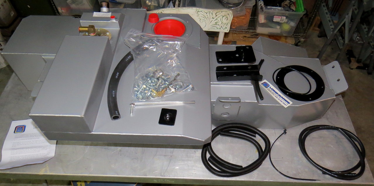

    I've had it for months, it's been lying in the garage waiting for the right time. Here I am with a few days off work and there's the plan. Install that tank!
    Unwrapped and ready. Notice that front bracket? It's bent, had to be during shipping, but what can I do at this point but bend it back flat....

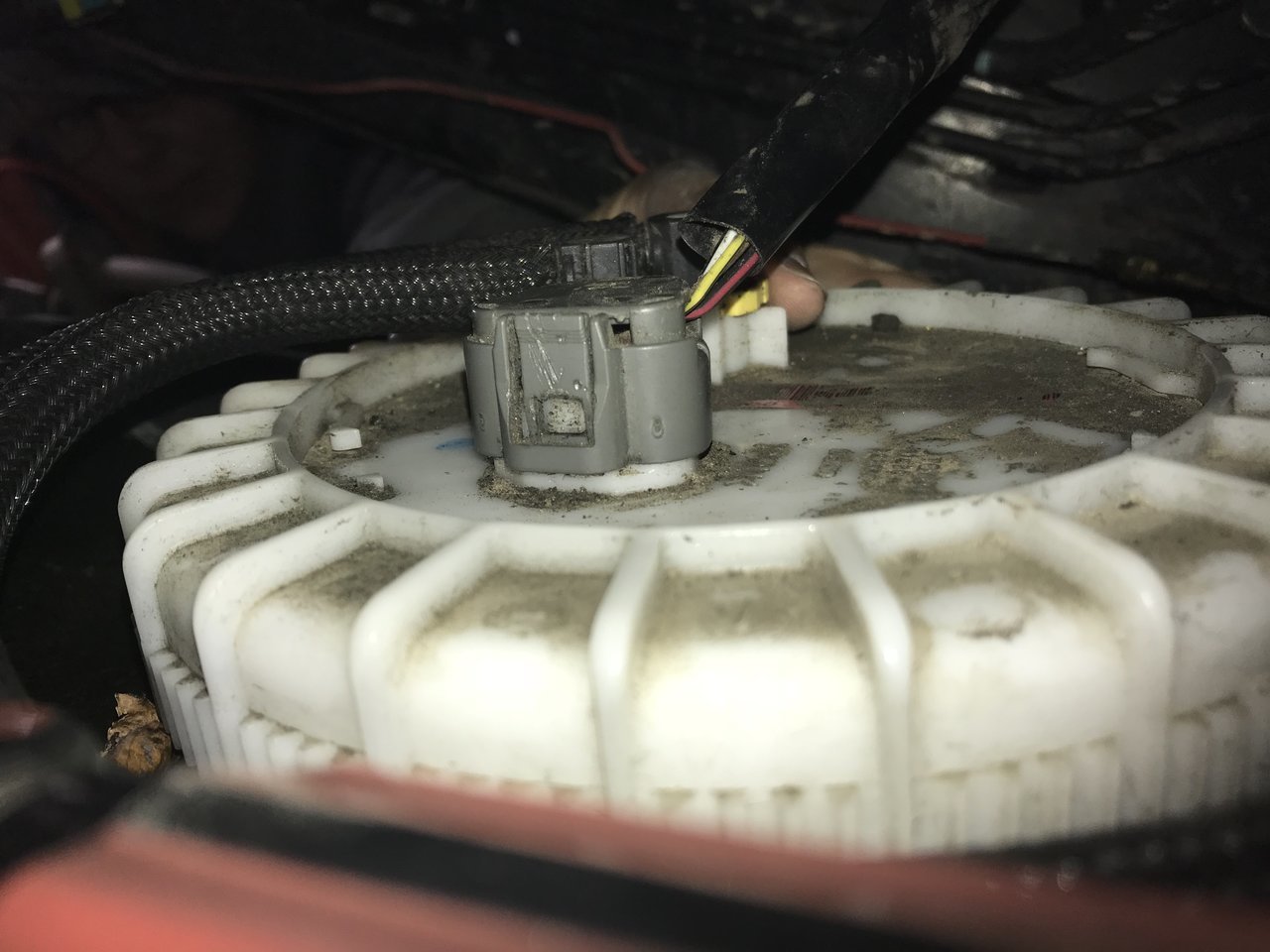

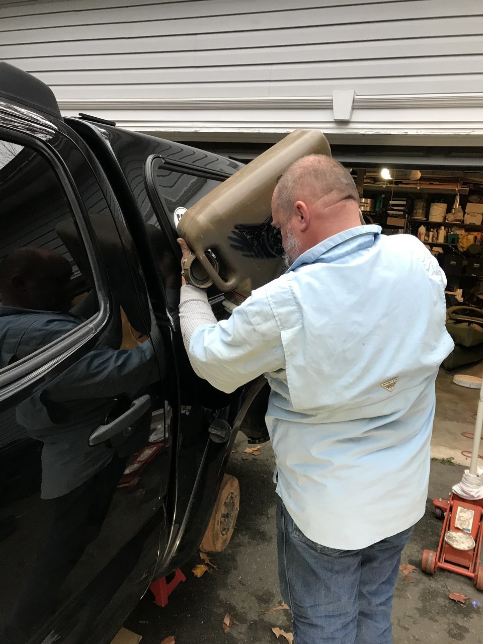

    Disconnecting the old stuff was painful, fat hands, fat arms, fat head means you can't see, reach, or twist turn connections to disconnect. This clip on the fuel pump for example.....I had to push that clip with a screwdriver (by feel not sight) and Beth had to pry it up with another screwdriver from the other side to break it free
    The old gas tank came out
    and I proceeded to install the URD fuel pump upgrade (in case I get a supercharger....but also to get a replaceable inline filter). URD's instructions are awesome. Well written and lots of pictures!
    I'd like to say the install of the new tank was easy peasy, but I'd be lyin'. The instructions are just large blocks of words. Sentence after sentence (paragraphs you say?) no pictures, no real detail. I read and reread and rereread. Ultimately, what really helped was pictures provided by @paranoid56 on the 34 Gallon Fuel Tank thread. A great big THANK YOU! to P56! I wouldn't have had such success without you!
    Raising and lowering the tank multiple times to get the fuel lines right - seems the URD kit and the LRA tank don't like each other much but we got the lines run and the filter filtering. The brackets on the outside were relatively easy to bolt up. The front bracket wasn't bad. That rear bracket though! It's that slightly L shaped bracket in the tank picture. It's a pain to install. The tab mounts onto the OE tank strap hanger. The only way it mounted flat is the way I chose - but the tank holes didn't line up so I had to drill new ones and even then the OE bracket made it almost impossible to get the bolt and nut on. Here's me struggling to do so, one arm was wrapped over the exhaust with that index finger wedged between two brackets in a not comfortable fashion to hold the nut still long enough to start the bolt.....

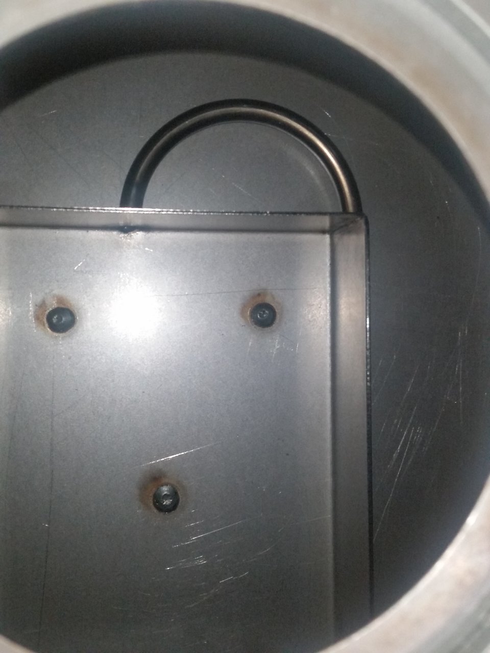

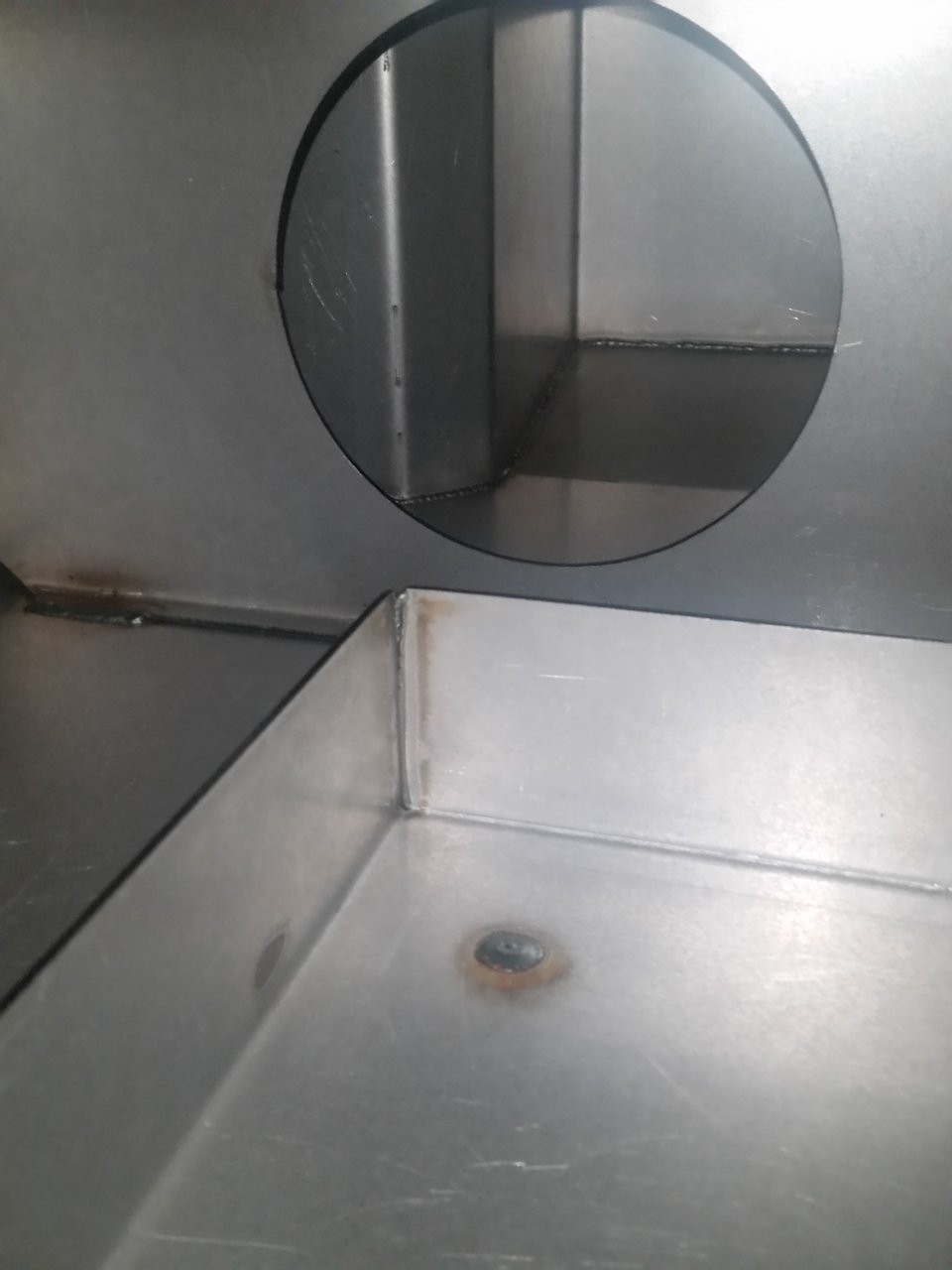

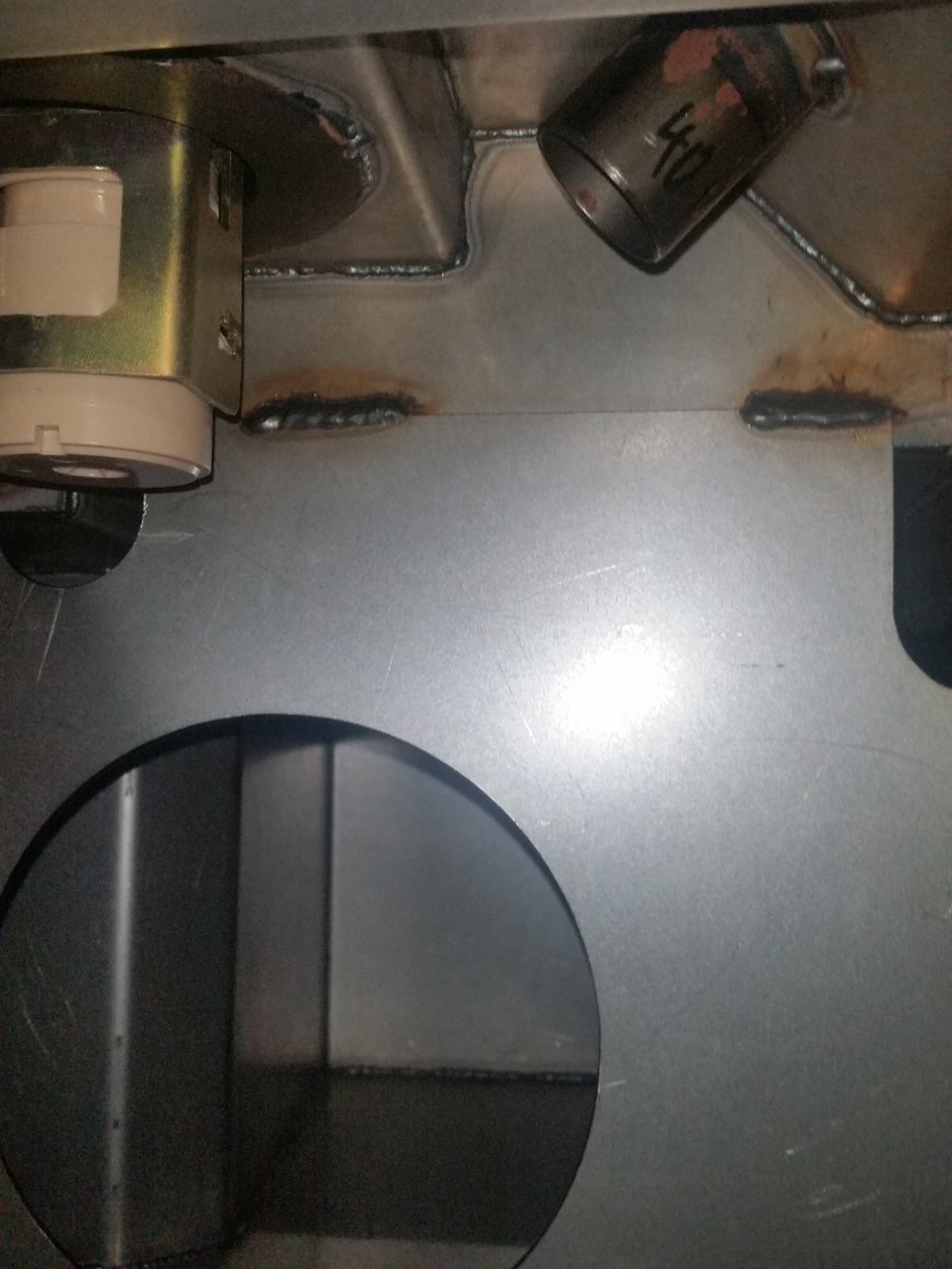

    Just for kicks gets some shots of the inside of the gas tank. I took these before installation...
