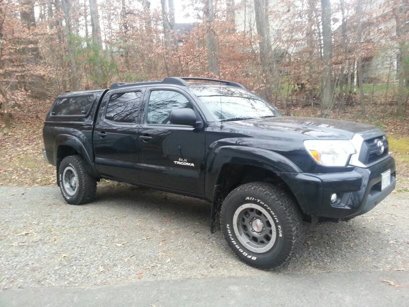

    Here it sits: The Wild Crow.
    It's Black, it's beautiful and it's ready to take over towing,kayak hauling, and forest road duties from the Tundra.

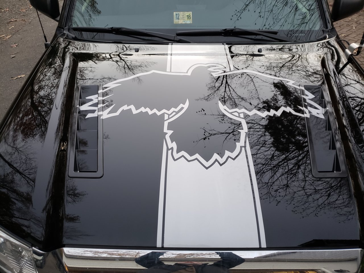

    Hood Crow and Stripe......................$210

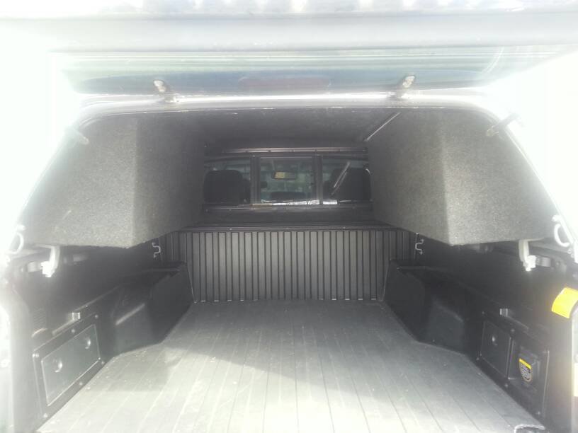

    Bed and Storage:

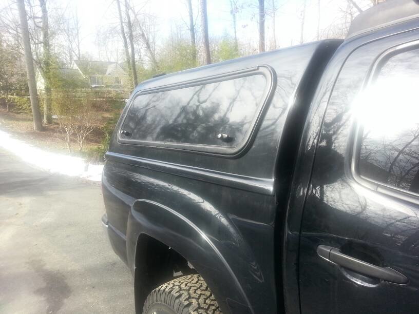

    Jason Workforce Cap (used)............$700 + $200 in expenses getting it home from SC
    BensonX DIY HiLift Mount and
    Fuel Can Storage and
    Yakima Rack storage.......................$20ish in hardware along with some scrap aluminum
    QuickFist Clamps for
    shovel, axe, and bow saw................$30

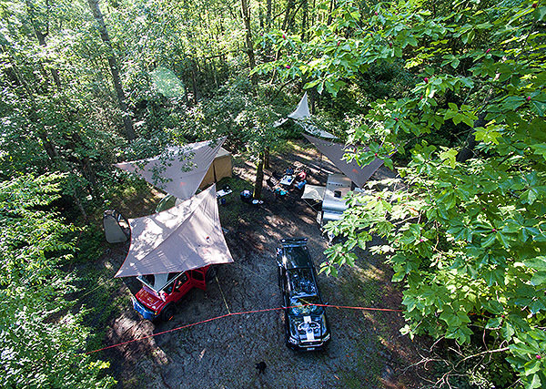

    Trips List (camping with the teardrop):
    Monongahela National Forest July 2015
    Kerr Reservoir July 2016
    Highlands NC July 2016
    NWPA June 2017
    Kerr Reservoir July 2017
    GWNF. July 2017
    Highlands NC. August 2017
    Westmoreland SP Sept 2017
    Blowing Rock NC Oct 2017
    Wiggins Spring Rd, VA May 2018
    Round Mountain CG July 2018
    Flagpole Knob August 2018

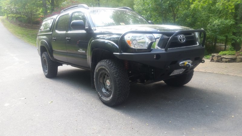

    SOSConcepts and
    Summerville SC. October 2018

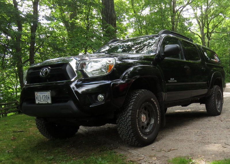

    The Wild Crow as it looks now:
    Photo by Jay Capers

    Our cap sat in the garage for a week after we bought it. It sat on sawhorses while I rewired the lights and Beth cleaned it up.
    She washed and shined up the exterior and I made sure the brake light and interior light functioned correctly. I used a four flat trailer plug to connect the lights to the truck. It was easy peasy japanesey and gives me the flexibility to easily remove the cap if needed.
    With our daughter's help we lifted the cap and set it on the truck. Carefully scooching it into position. As I was about to fasten it down with the brackets I realized we forgot to seal it.
    Now with my daughter in the truck we tossed in sawhorses and milk crates. As Beth and I lifted the cap up Madeline stacked crates so the cap would be off the truck bed high enough to add the seal.
    We used a rubber seal I bought from Amazon. Stuck it on the cap carefully fitting the corners to hopefully mitigate any leakage.
    Set the cap back down on the truck, rescue our daughter trapped behind the milk crates and sawhorses, fasten the cap down. Done deal.
    I caulked the corners where the front rail is lower than the side rails. I used the silicone sealant that we used on our teardrop. 3M 4200 sticky waterproof and lasts forever almost. Don't get it on your fingers. ....
    Cap looks good though. Well worth the year long search and the 500 mile drive

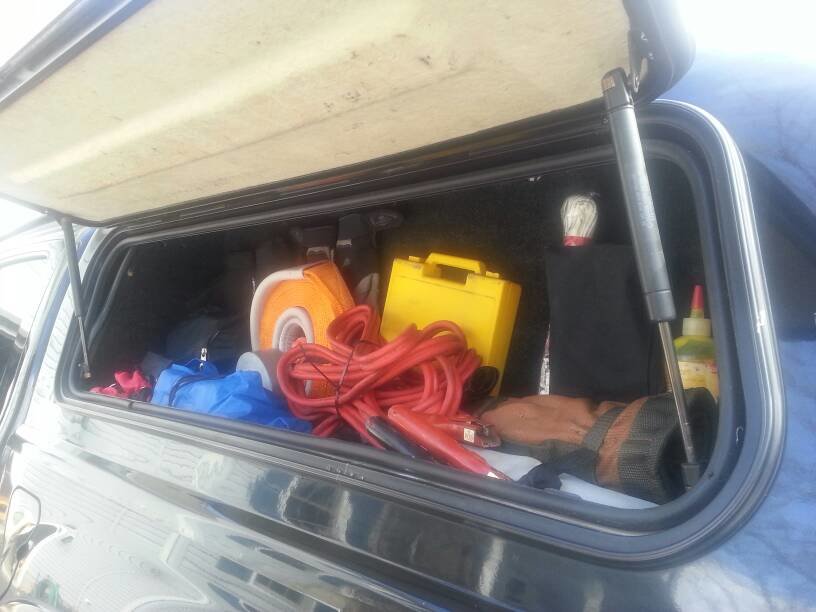

    With the Hi-Lift tucked up out of the way, we moved on to storage for other necessities:
    Items like the shovel, the bow saw and the axe (seriously). These were installed in the passenger side tool box. The axe and shovel used the original sized Quick-Fist clamps, while the bow saw is held up with two mini Quick-Fists. We purchased an 8 piece kit through Amazon.
    These items tend to find a lot of use while we are camping. The tool box access gives us easy access to them, while the Quick Fists keep them securely stored. The drivers side still needs work. I need to figure out its arrangement - which is currently tool rolls, an air compressor, snatch strap, jumper cables and various other items that get used on and "off" road.
    Ultimately, I would love to address the range of the Tacoma (both with and without Teardrop) by adding either a long range fuel tank, or an auxiliary fuel tank. Until that time (and money) come along, we are stuck with fuel cans like normal peeple.
    Luckily for us our gas cans fit under the drivers side tool box - barely. They slide snugly in with the tops of the handle brushing the tool box. There is no upward movement - awesome! Side ways is a differnt story. We discussed ideas of how to fasten the cans fast. Everything from the ubiquitous ratchet straps, to a fancy locking aluminum catch that swung open and closed tightly around them. What we eventually arrived at is the epitome of the KISS system.
    The tailgate serves as the forward (rearward?) latch - as the rear most can is held in place by the tailgate when closed. The side movement is held in check by a piece of aluminum angle fastened to the underside of the tool box. The angle leg is deep enough to hold the tops of the cans firmly against the side of the truck bed, while allowing you to slide them right in and out.
    What do you use your gun rack for?
    I use mine for kayak paddles. Our Bending Branches take down paddles slide right into the gun rack.
    Yes, we kayak. Mostly for fossil hunting in the winter and fishing in the summer, and the occasional mild white water. Currently, our kayaks are Future Beach Trophy 126's. A matching pair 'cause we are just that darned cute.
    The kayak racks have also found a home in the bed of the truck when not in use. They store right next to the Hi-Lift. A couple of wide boards, properly fenestrated; some bolts, wing nuts, and PVC end caps make a rack to hold the crossbars is place just waiting for their chance to mount to the roof to haul some yaks to an interesting place.
    Cutting and shaping
    [​IMG].......[​IMG]
    Paint
    The rear piece mounts to the bed rail
    The front is removable and slides onto studs mounted to the side of the tool box.
    [​IMG]kr
    So far, everything is out of the way
