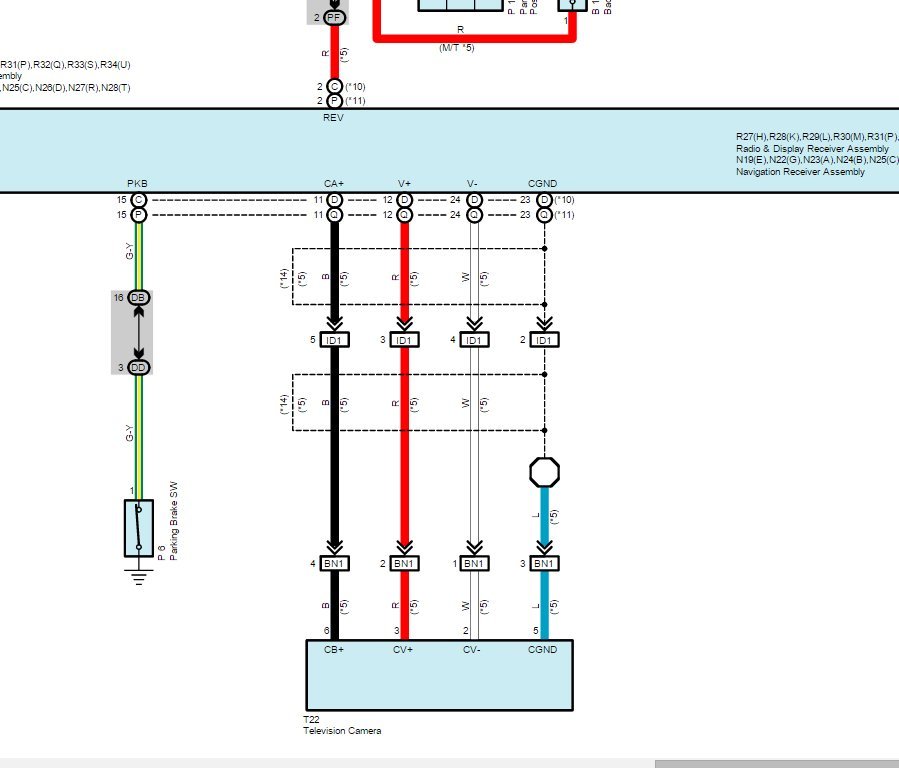

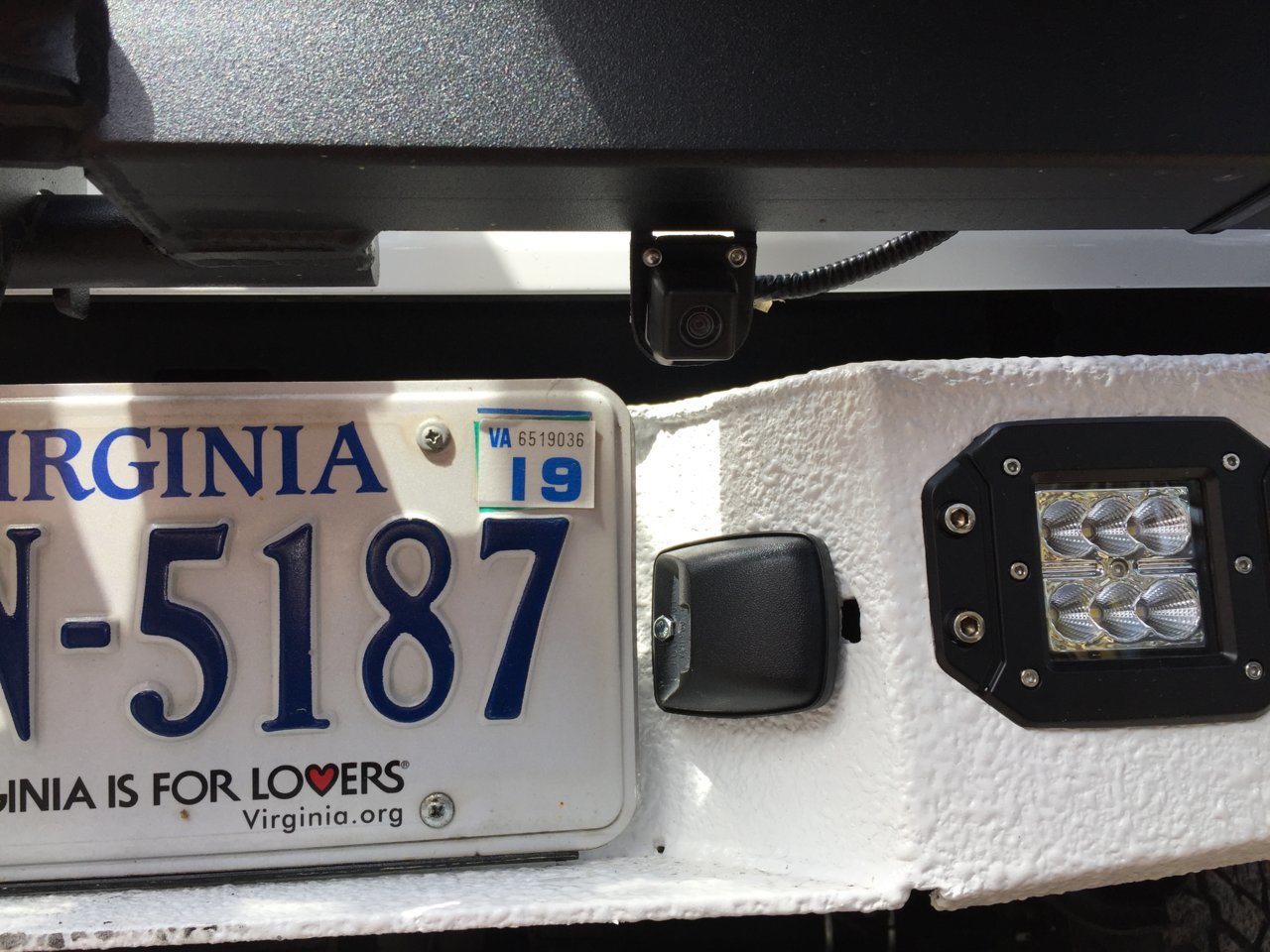

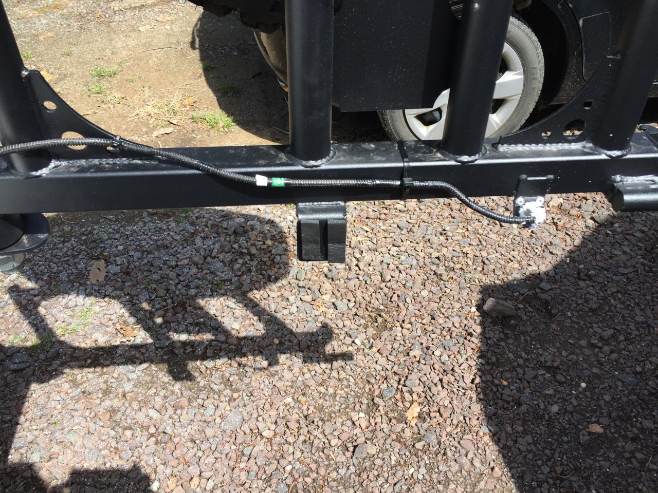

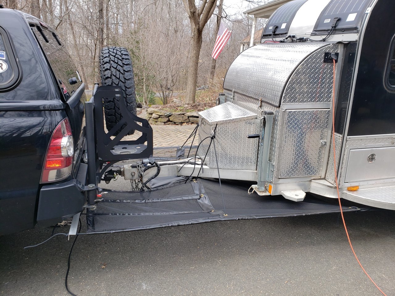

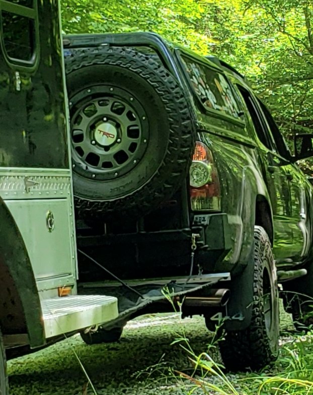

    1. BACK THE TRUCK UP!

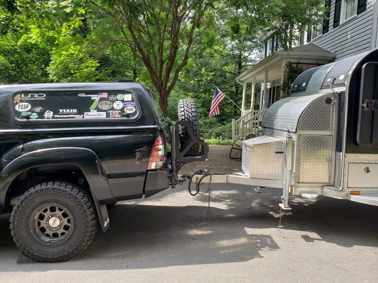

    2. With the addition of the dual swing bumper and the 255/85/16 spare tire the oem back up camera was mostly blocked for any decent use. Not long after installing the bumper I found a kit that had a camera installed in the led brake light of the Jason Cap. I bought it and looked at it, set it aside, and pondered how to integrate the aftermarket with the stock system.

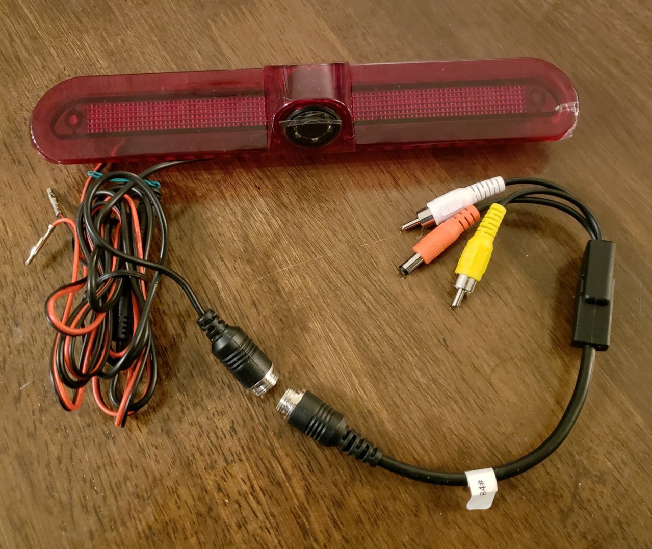

    4. After many months and asking on TW I finally did this. With the wiring and switch kit from anytimebackupcamera.com which i installed first to make sure that system worked.
    5. [​IMG]
    6. And no, I don't have a front camera, but if i need one i can add one.
    7. The Jason Cap camera and led brake light unit bolted in place of the regular brake light. The brake light wiring was straight forward.
    8. [​IMG]
      The camera wiring was not bad to do but it took quite a while to get it wired out of sight and all connected weather tight.
      The camera 12volt power comes from the 7 way trailer plug. I tied into the aux power circuit (it's a black wire) and just screwed the ground onto the steel bumper. That actually powers the camera when the ignition is on.
      As @DaveB.inVa pointed out the red wire in the oem camera loom inside the tailgate was the positive video feed. The white wire was the negative feed. I clipped those wires inside the tailgate and fed all the camera wiring into there also.
      Clipping off the yellow rca connector in the Jason kit allowed me to tie its positive (center wire it was red) and negative (or shield wire, it was black where the sheathing meet the rca). By the way, those wires are tiny! My fingers are fat and that combination makes connecting wires securely a herculean task!
      So there's a power wire (red rca in the kit) coming into the tailgate, the video (was the yellow rca until I had to snip that connector off) wire ties into the stock loom. These screw onto the video cable. That cable feeds out of the tailgate and up the inside corner of the cap to connect to the wiring on the camera itself. I didn't take pictures of this, it was 104 outside (heat index) and i needed to get this done before I died.
      The Jason kit came with about 25 feet of video cable and some proprietary screw on connectors. I left those all bundled up and secured inside the tailgate. Padded with a piece of rubber and it should be gtg.
      The stock loom and camera is still there and if I want to return in to normal all I need to do is splice the red and white wires back together.
      After its all buttoned up (with much much much testing while the wiring was being done) it works like a charm. Truck in reverse and the backup camera comes on, driving down the road, hit the switch and the camera comes on. Sweet!
      Many Thanks to @DaveB.inVa ! for making this project a success!

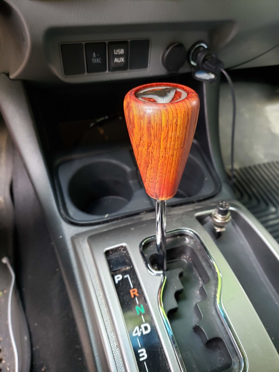

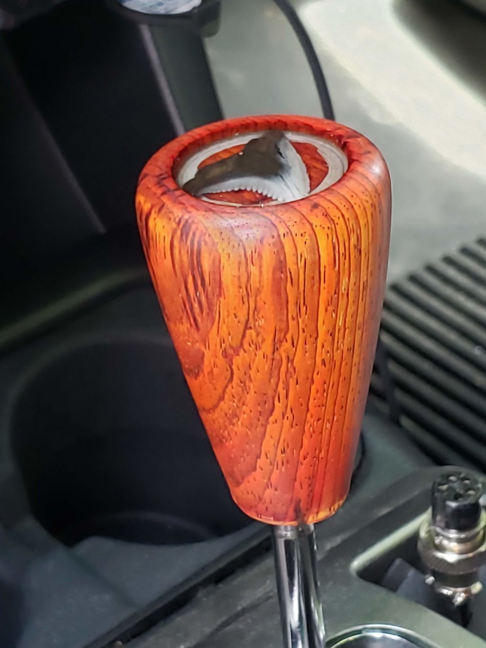

    Around the same time as the backup camera I also (slyly) installed this bit of business. It was a surprise for Elizabeth and custom made by @JohnAcessCab . The shark tooth is one we found along the Potomac River It's from an extinct shark called a Hemipristis (snaggletooth) Serra. John turned the beautiful Cocobola shifter handle and inlaid the tooth. He did a great job and Elizabeth was very surprised the next morning when she drove to work. She actually called me and said it was cool.
