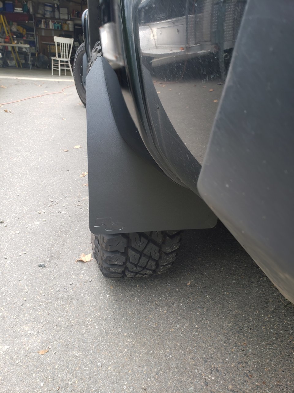

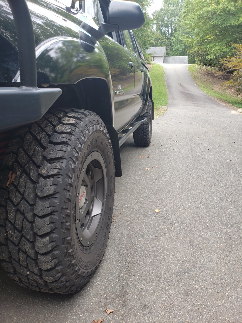

    ROKBLOKZ TIL YOU DROP
    After losing one mudflap I was really surprised just how much mud got flung onto the side of the truck. Going flapless was definitely not an option. Knowing I'd lose the factory flap again made OEM not an option.
    There's a few options out there and we settled on the Rokblokz. We picked up a regular width short set. They're actually slightly wider than the stock flap but shorter so they'll be less likely to be torn off hanging up on trails
    Now there's less stuff thrown up on the side of the truck and we are ready to rock!

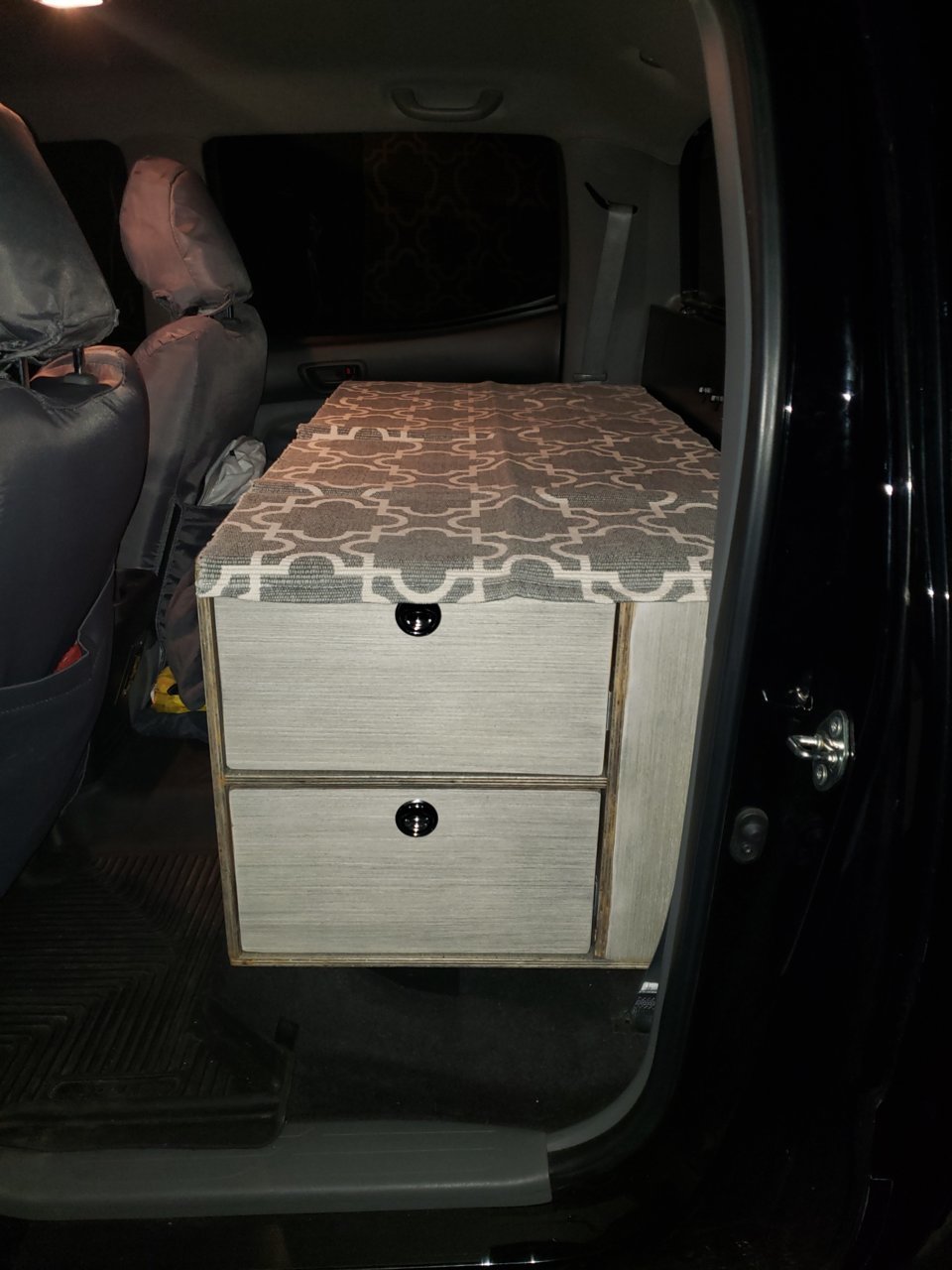

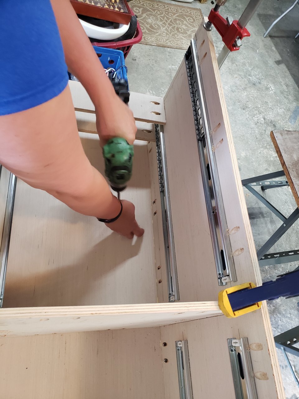

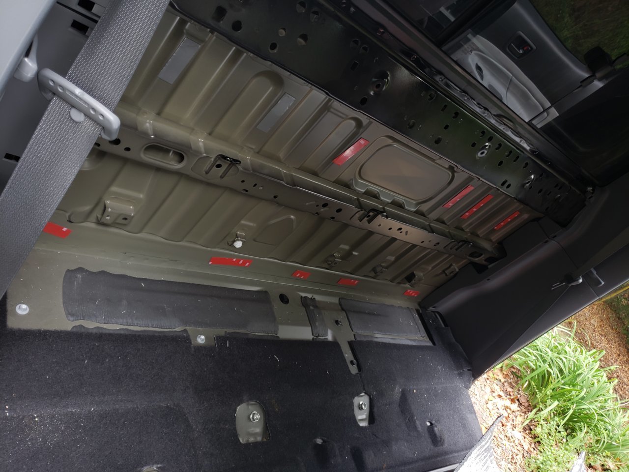

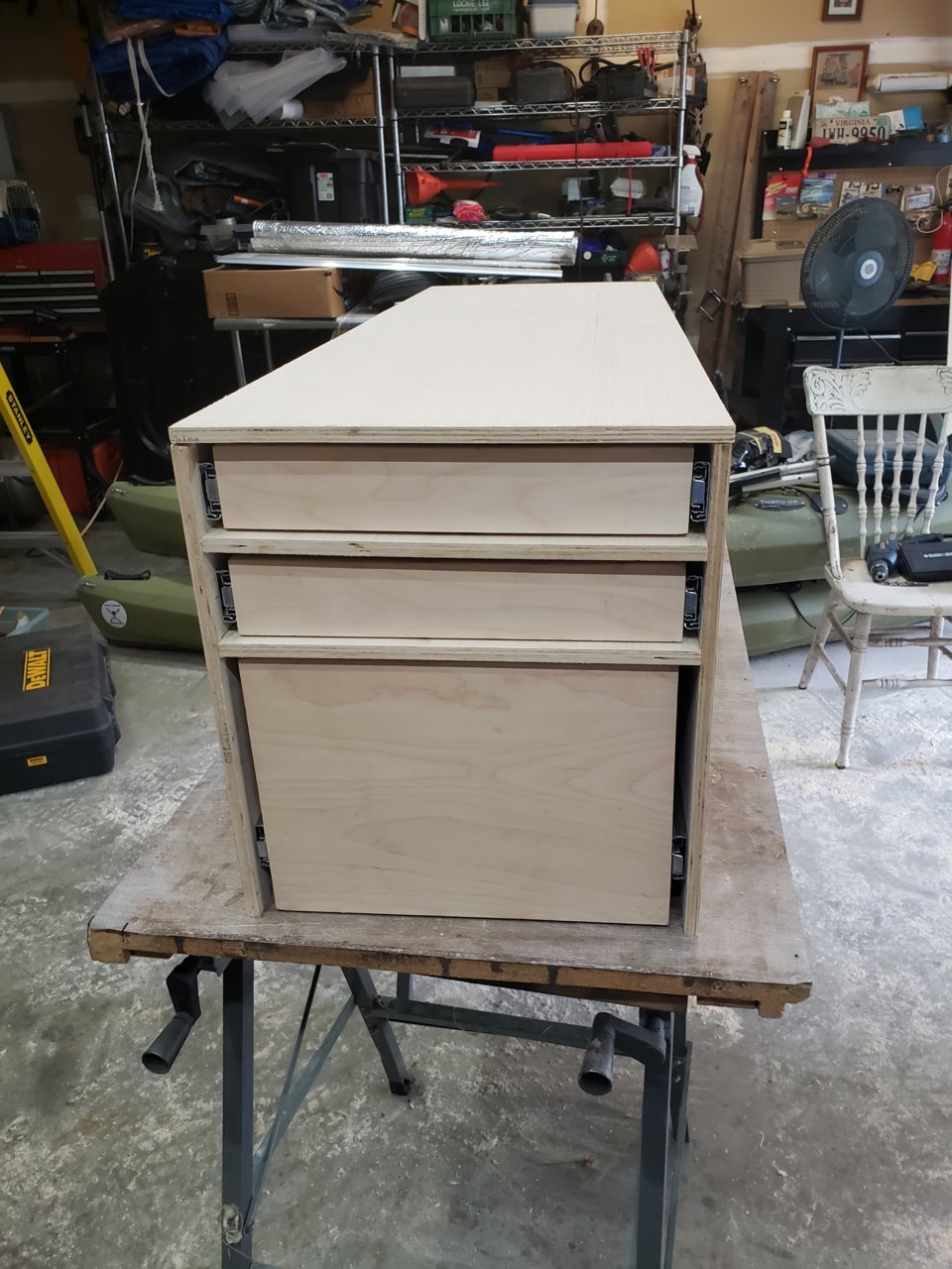

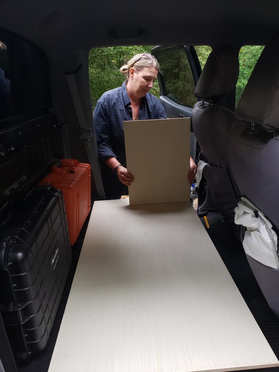

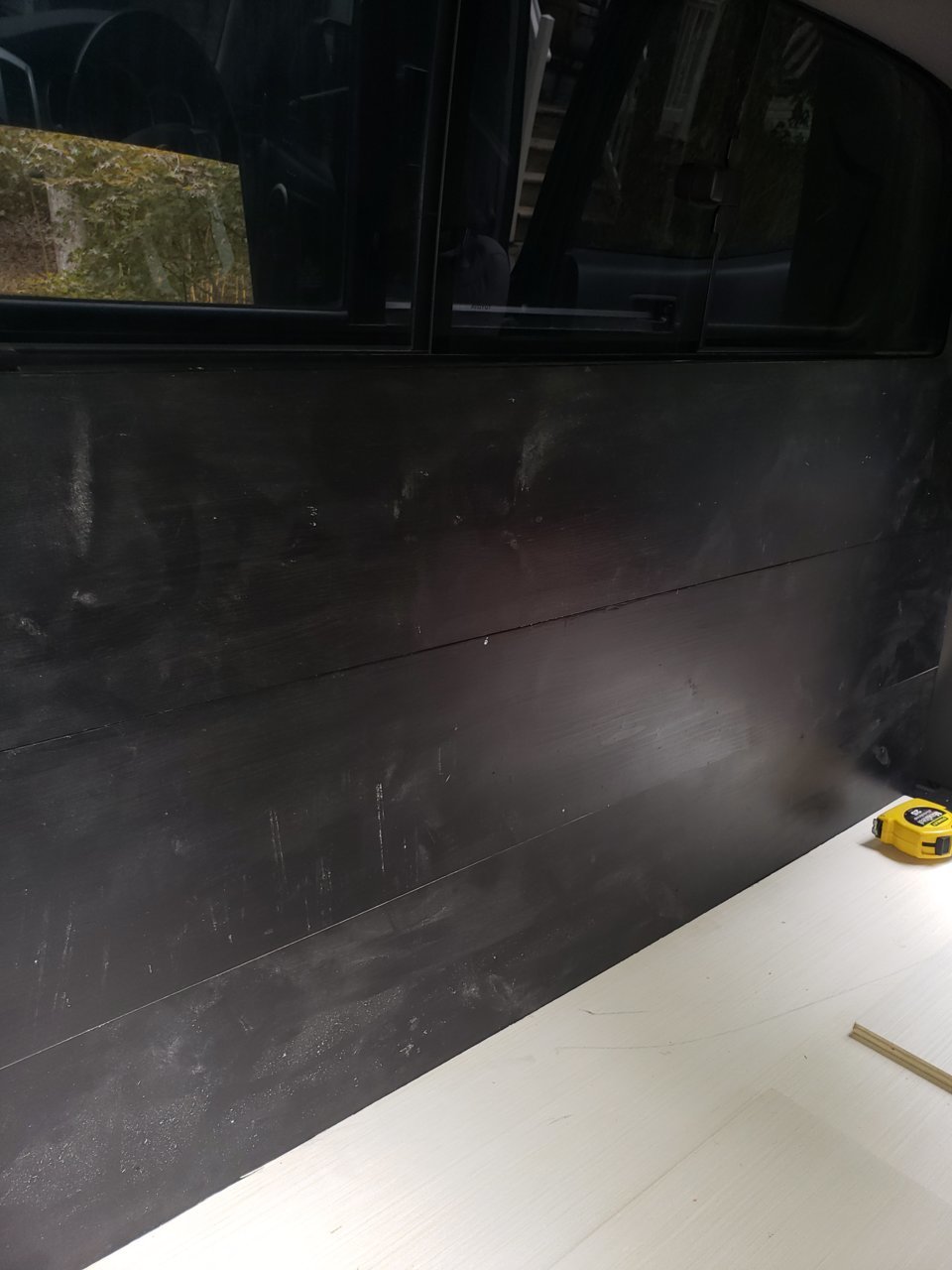

    BACK SEAT SHAPED BOX
    Hey! Wait! I've got a new complaint!
    That back seat while it's helpful for hauling peeps around it really makes hauling other things around more difficult. Not only do the seats themselves take up a ton of room but those plastic bins behind them take a lot of space and aren't very organizable.
    We really thought a lot about how to organize storage for the back seat. We started out wanting to keep the seat for hauling peeps around as we need. But, as a friend of ours pointed out "How often do you haul anyone in the back seat?" This trusted friend is also the one who told us about his experience with roof tents, driving rain and wind and got us thinking about hard sided trailers, which led to the teardrop build.
    For that, we're forever in his debt for his priceless advice

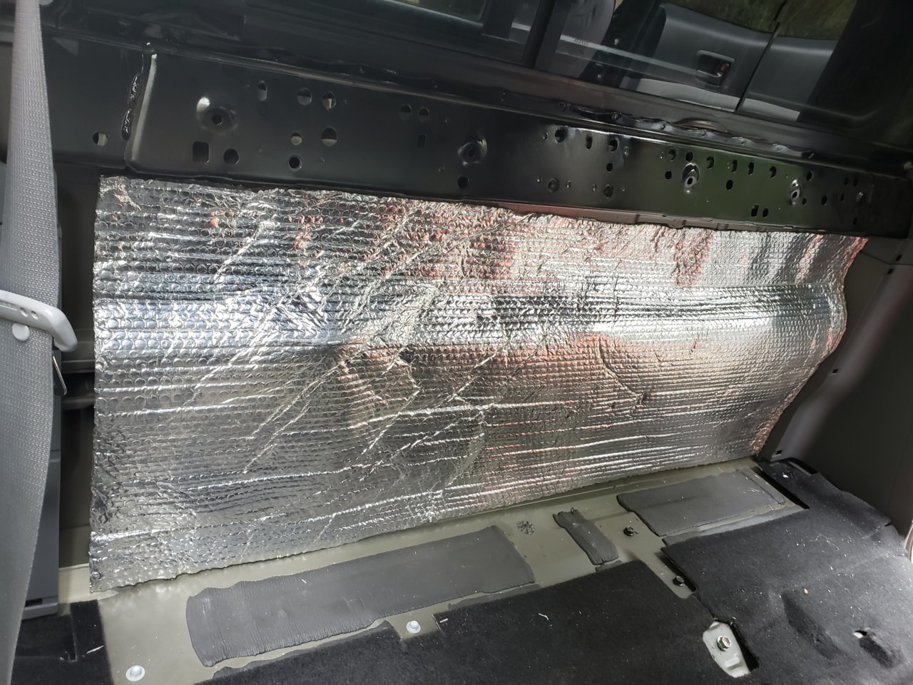

    If we ditched the backseat we'd have more room and more freedom to build and organize storage
    That allowed us to plan out dimensions, sitting front seats at a mild napping lean and using our plywood to make a floor and visualize the width and height
    We insulated the back wall
    And built a wall to hide all that shiny

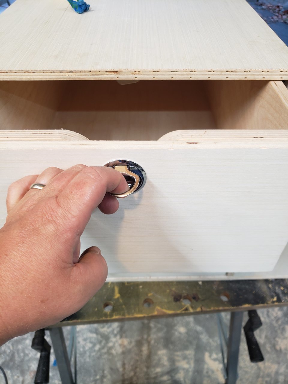

    We settled on a five drawer style box. 2 large bins on the driver's side for tools. 1 large and 2 small drawers on the passenger side for dry storage of some hiking gear, map books, and other small accoutrements
    With plywood and Kreg jig in hand the box came together nicely
    Drawer fronts and slam latches to hold the drawers closed
    Several coats of polyurethane later and Now we've got tons of in cab storage space, we can stack stuff on the box as needed (tie downs to be added). We can still put stuff in the floorboards as needed, still recline (at least partially) all the tools I currently carry fit in their respective spaces (with room for more) and we're one step closer to making a year long trip around the country

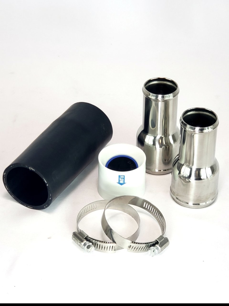

    FILL ME UP TIL I OVERFLOW, I WANNA RUN OVER.....

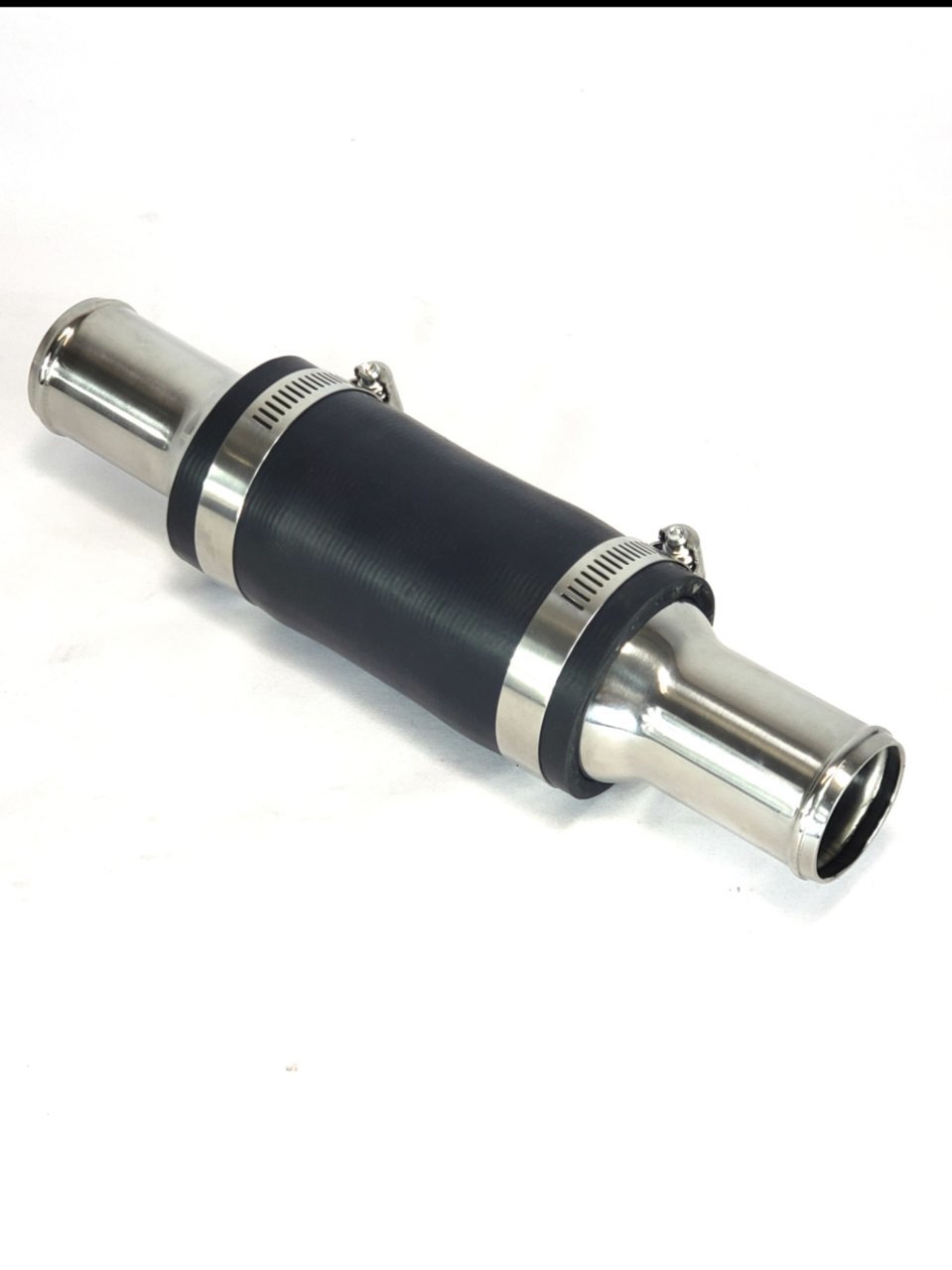

    I've been doing lots of little fiddly bits to the truck getting it ready for this upcoming year of adventure.
    One of the main issues I had was the Long Range gas tank has always had issues with overflow upon shut off. We've replaced the vent tube to the charcoal canister, made sure all hoses were not kinked all to no avail. Every time I'd fill the tank it was a game of listening for the right gurgling sound and releasing the gas pump handle at that right moment. The right timing brought a full tank and a sense of joy, the wrong timing brought a full tank and irritation at having to wipe down the side of the truck and smelling gasoline on your hands the rest of the day.
    I think I've finally fixed it. Holding my breath right now, but I've got one fillup in without spillage and the pump shutting itself off like a normal filling.
    I spent a lot of time researching and found this article on Filler Neck Supply, about an antiwellback valve. I bought their kit,
    removed the Tacoma filler neck, cut a nice long section out and replaced it with a section of filler hose with the Perko valve installed.
    Unfortunately for you, I took no pictures of the process. But other than removing the fender liner to access the fuel neck it was a fairly simple process.
    A couple hours work and I ain't crying over spilt gas.

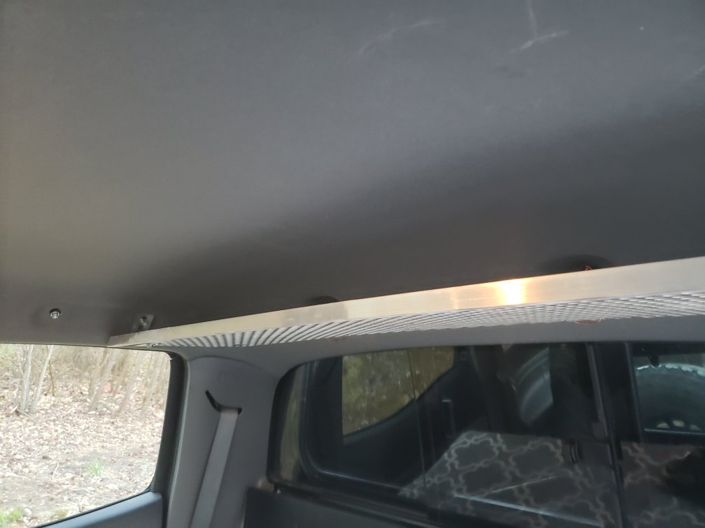

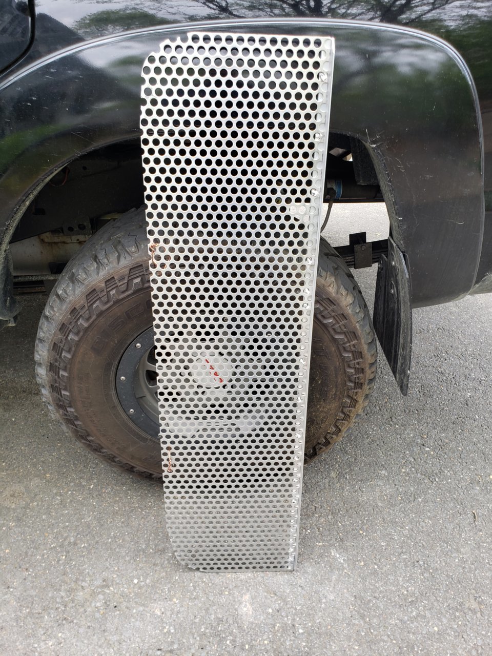

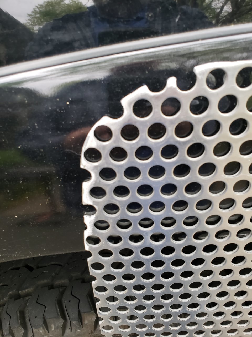

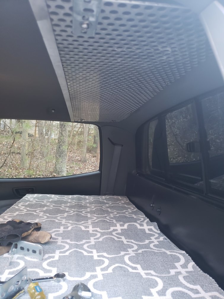

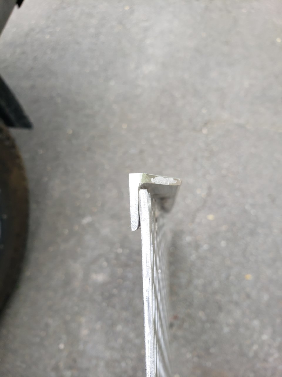

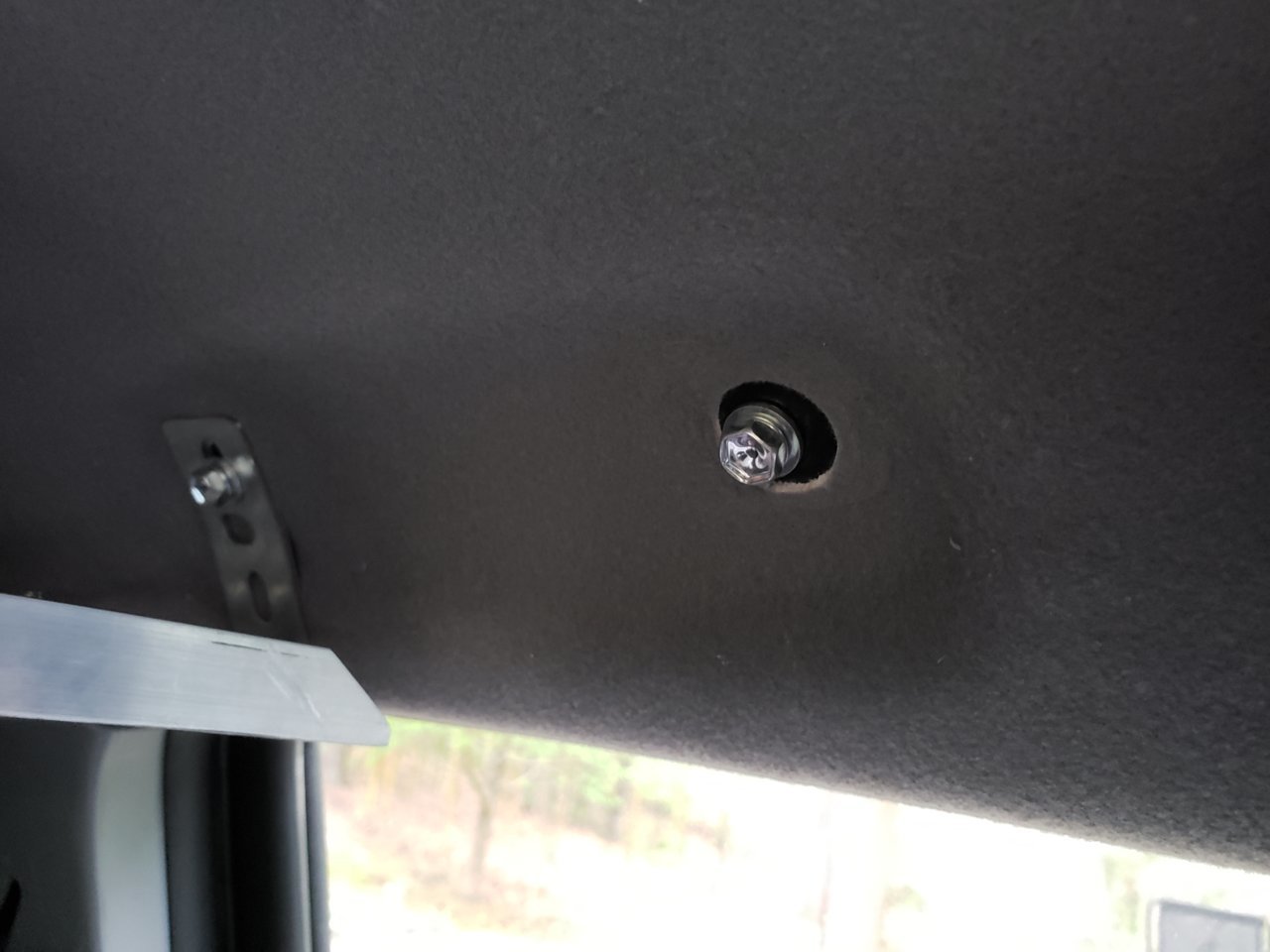

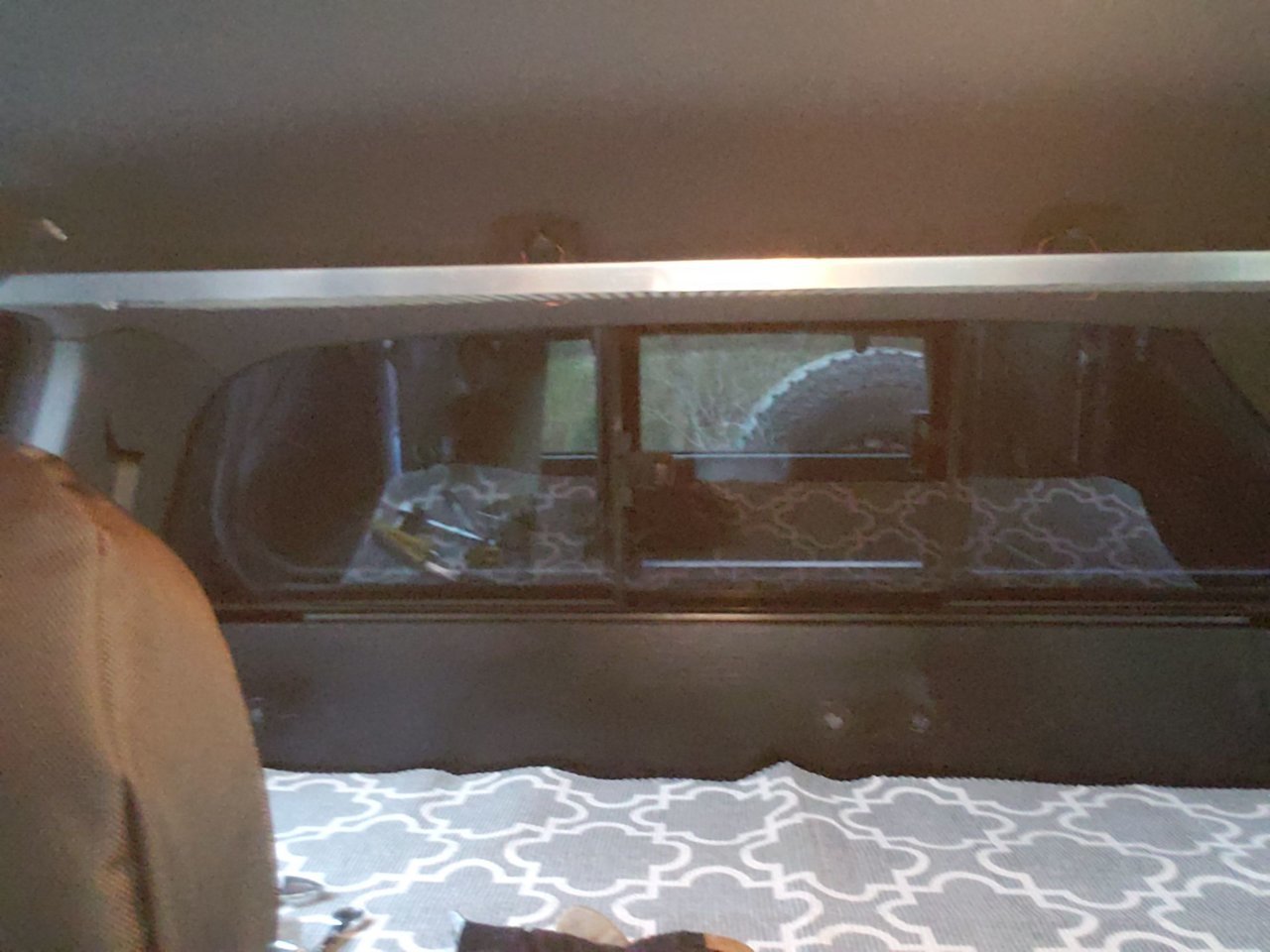

    Taking shelfies of my shelf shelf shelf
    Storage solutions 2.0
    I've liked the thought of an overhead shelf in the back of the cab. It seems a good place to store lightweight small things like hats, jackets, blankey. Things you may need when you stop somewhere but don't want to use while driving.
    We tried the netting style, with any weight at all they sag and bounce up and down on the road. We decided a solid shelf would be better.
    I used a piece of perforated 1/8 inch aluminum sheet 12x45.5"
    Cut the back corners to follow the contour of the roof
    Welded on a 3/4" aluminum angle to the front to keep your heads from getting cut up on the edge and to keep stuff from falling off the front
    It's held up with two brackets where the grab handles were on the front edge. The back is held up by wiring them to the coathooks with cables.
    It's high enough to not be in your rearview low enough to stash stuff easily

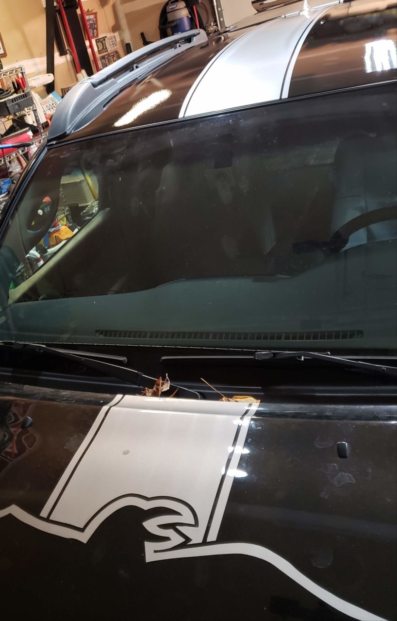

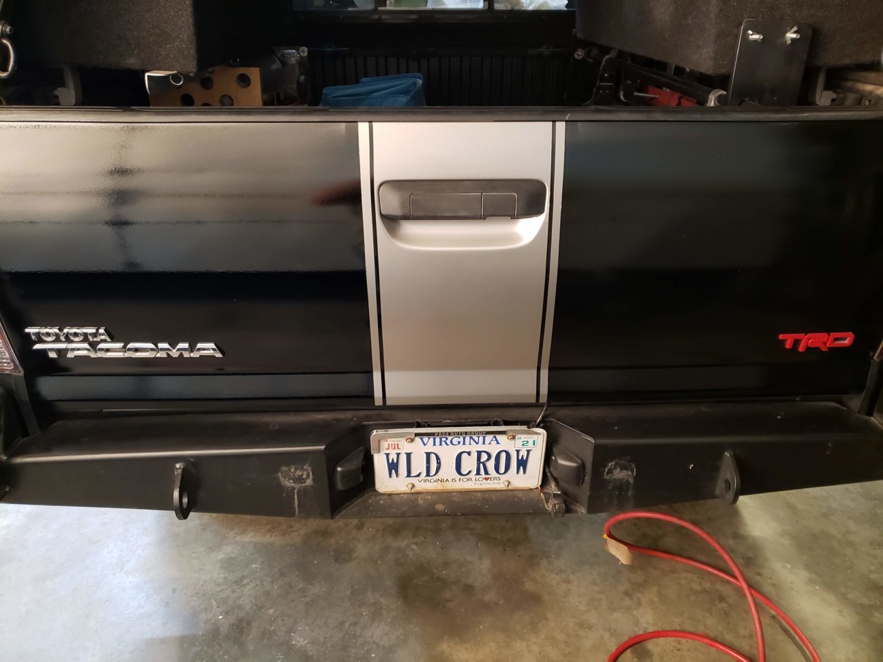

    I neglected to mention that over the winter I completed the stripe for the crow. It now runs across the roof, cap and tailgate. Conditions weren't the best and it orange peeled, but it's acceptable and can be improved with a good sand and buff
    Casper66, ChadsPride and Drainbung like this.
