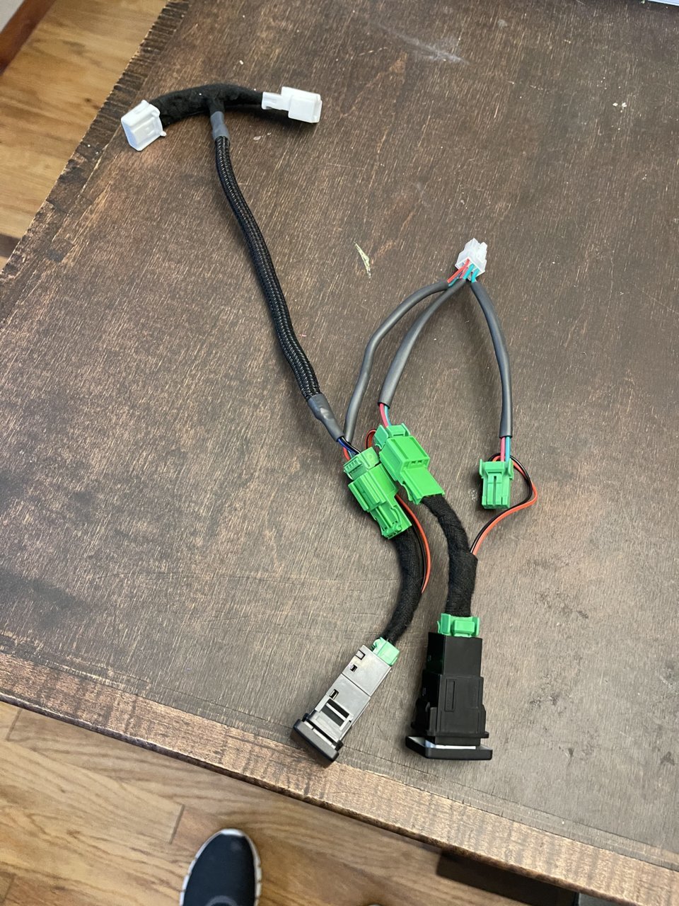

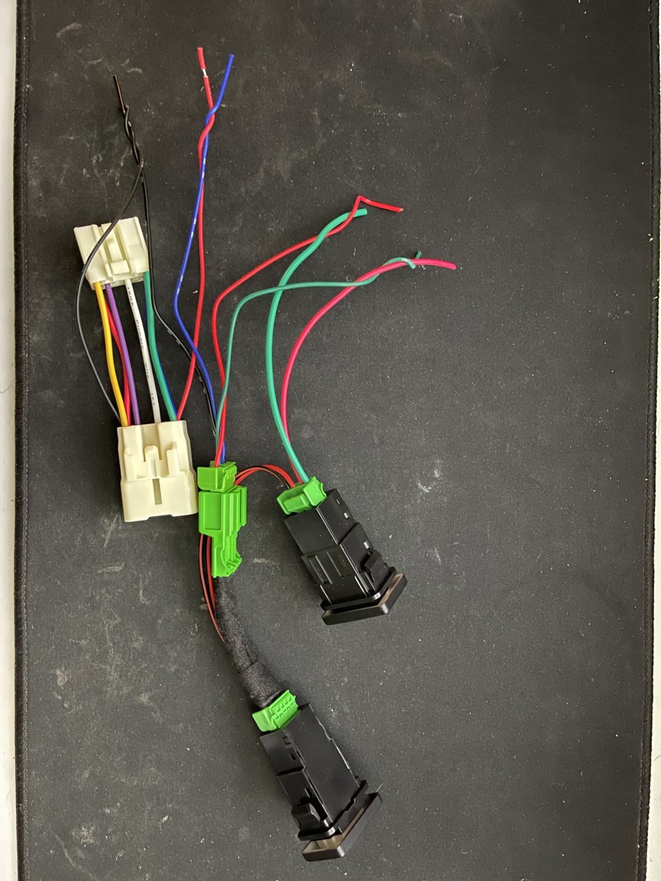

    Supplies arrived, and the Bussmann portion of the build is officially done. Now I move on to interior wiring, and the first thing to determine is how this is going to be wired up. I'm not completely confident I can crimp the Molex connectors with what I have, but perhaps the other crimper will finally make an appearance.
    I had to work out a small difference between the daisy chain harness I ordered and the AOB switch (red and green are reversed), but I think I am good now.

    Lower dash harness complete.
