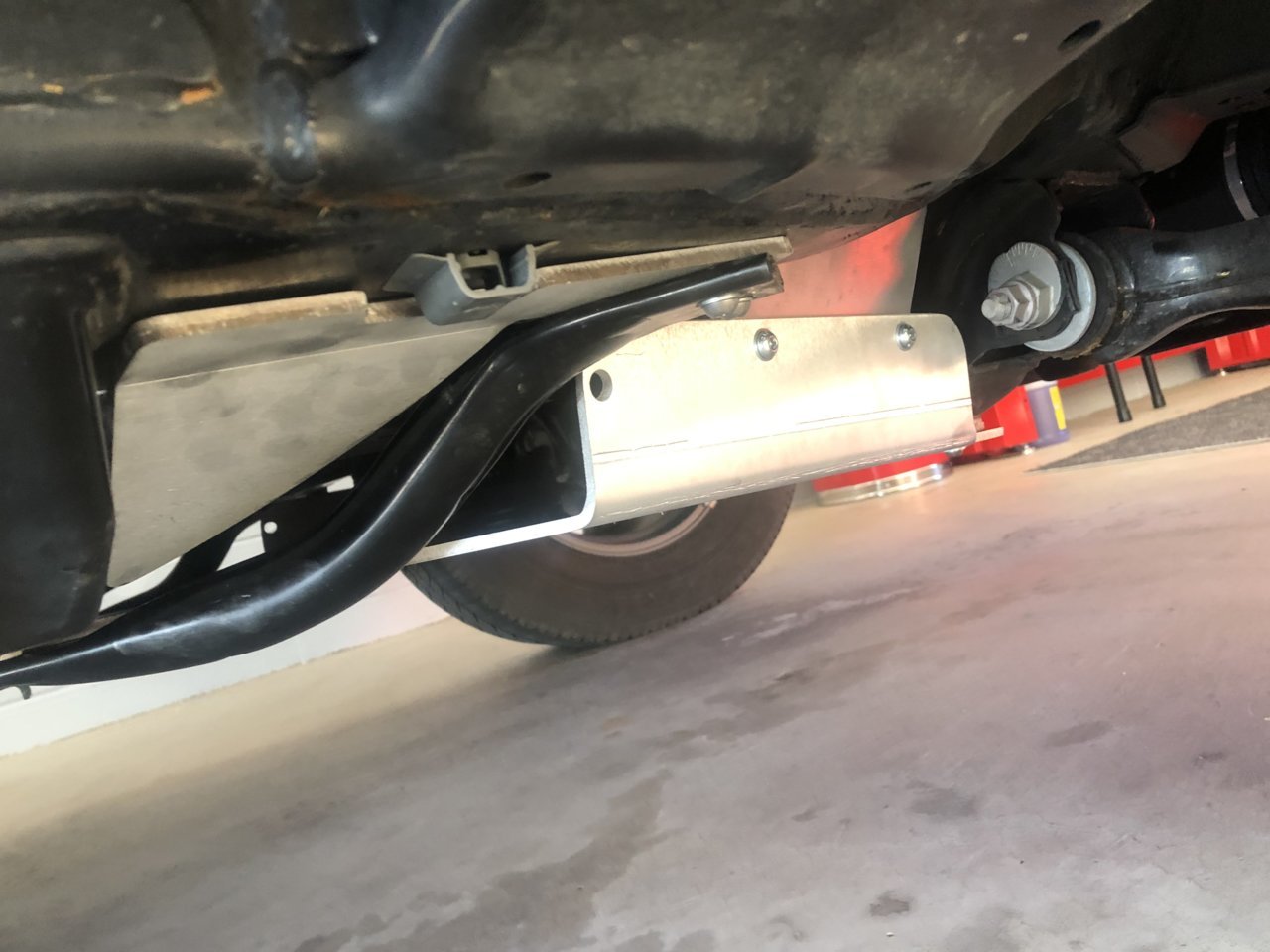

    I’ve had my Talon’s Garage plate on for awhile now, absolutely no rattling. FC739D0C-DC53-4980-BBDD-604F1A38DFFA.jpg

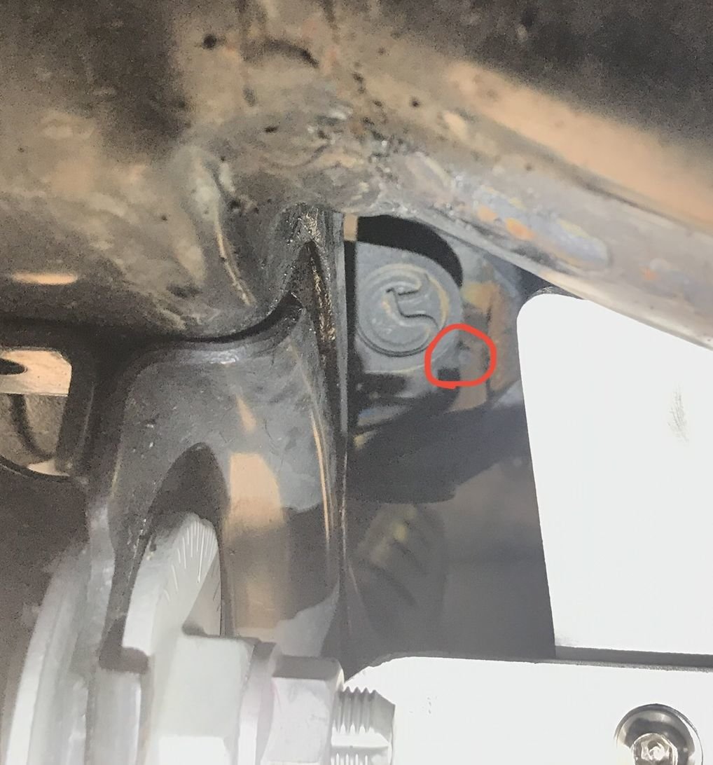

    Well, it might actually be possible. The zerk at the front diff is the problem. You have about a 1.5" window in front of the side "wing" on the shield, and the zerk is about 5.5" back. The problem is the angle of the zerk which is tough to see in the picture, but with the right extension on the grease gun it might be doable. I'll give it a try and report back.

    Thanks for checking it out (Talon). From the pic it looks like it might be doable. Maybe trim to improve access?
    Miller seems to be the other one worth investigating. Would really be a PITA to have to take down for such a quick maintenance item.
    Edit: Although, the grease needs to ooze from the universal joints to be sure it is done right and that requires a wiping down. Otherwise, it slings all over the place.
    From the pic it looks like it might be wipeable too?
