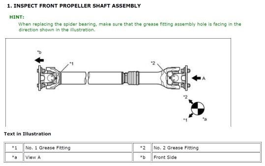

    we are talking about front driveshaft (called propeller in service manual) universal zerk grease fittings.
    some 3rd gen have it and some not. way too complicated to figure out - best go under with flashlight and examine
    universals on the shaft. it rotates easily by hand if you are parked in 2WD mode.
    while you are there - check your main propeller as i see the service manual also covers zerks on those
    universals as well. again, i have no idea which models/years have it or not. good chance your 2021 does not have any but better know for sure.
    greasing these zerks is part of the maintenance schedule (assuming you have them) and affects warranty if a failure.
    i have 2018 SR5 and have zerks on front shaft but none on rear shaft.
    example front propeller (snip from service manual):

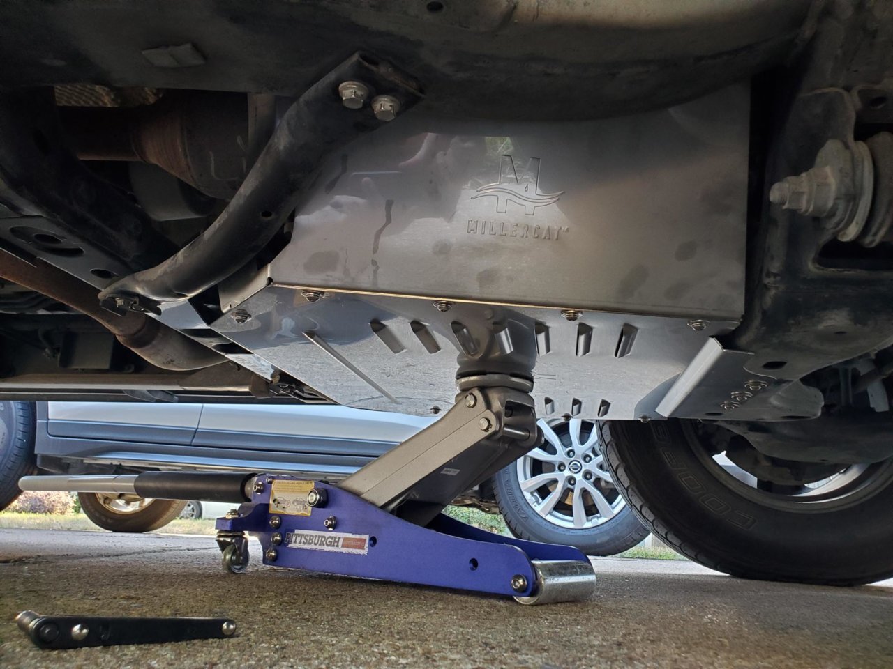

    I just installed a MillerCat stainless steel shield. Use a floor jack with a rag on the bowl to hold the shield in place while starting screws/bolts. Also doing it in bright sun light helped me line up the holes on the front crossmember plate. I don't have ramps so I drove the passenger wheels up on my sidewalk to give me a little more clearance to work. Easy to install and no rattles.

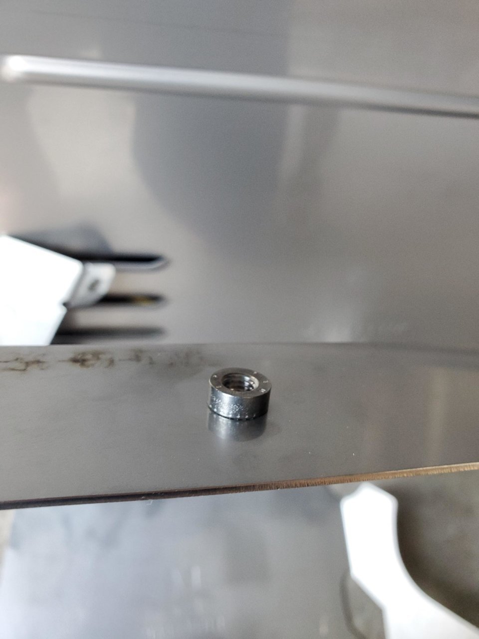

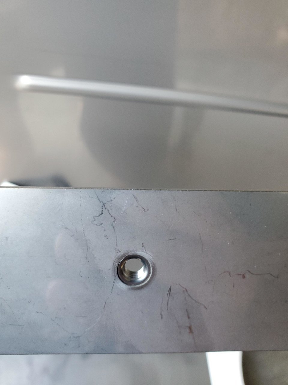

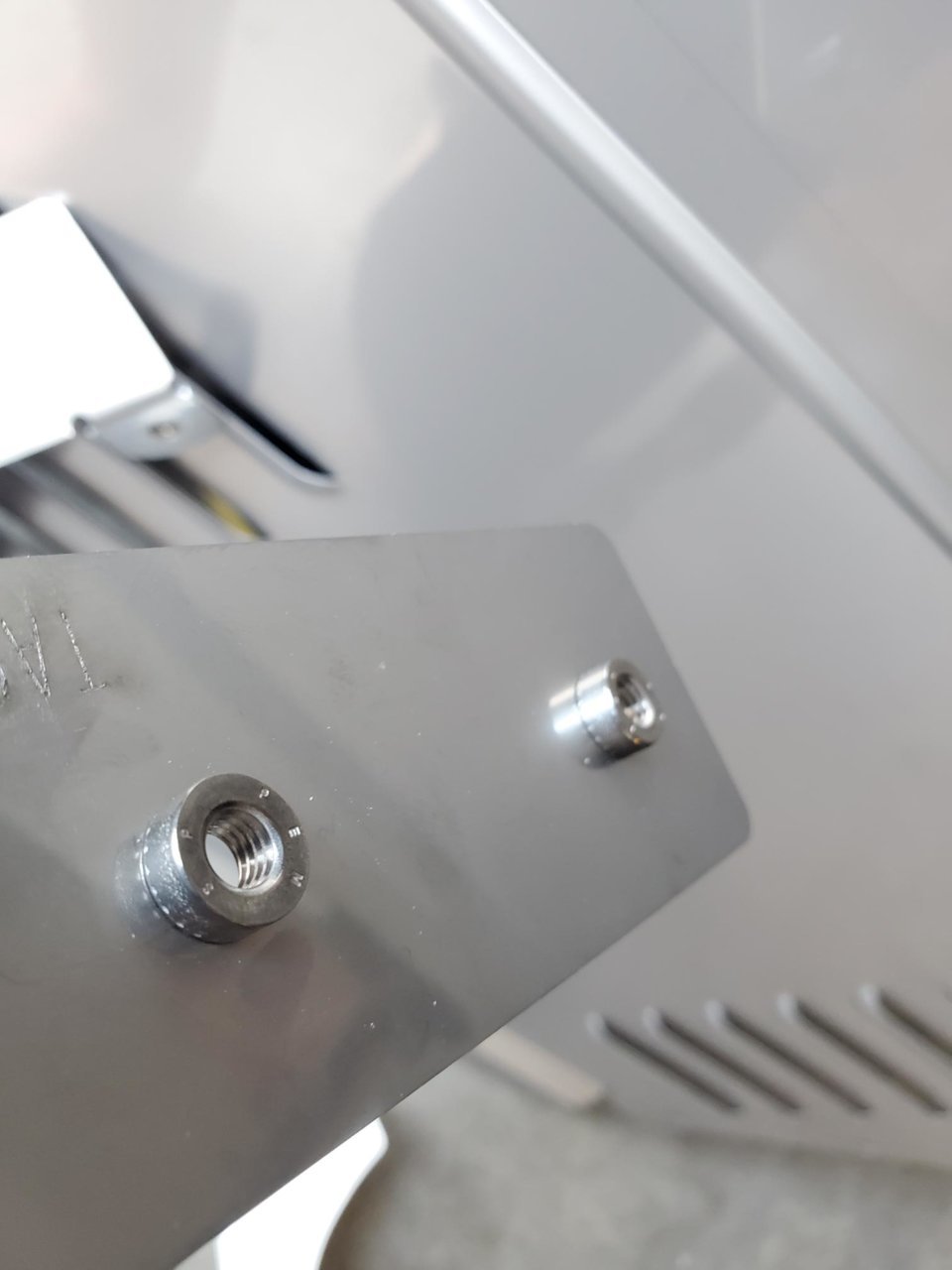

    I just installed my millercat. I did not have to raise up the truck, I was able to slide underneath.
    I used a jack to hold the plate up.
    It looks like the threads are pressed in or some kind of rivet. I would expect there to be a weld for this price. I would paid even extra for welds.
    But the screws that come with this are very crappy for the price. The heads are so easily stripped. One partially stripped just because the bit slipped out while tightening. They should include better screws in the kit. I also put blue loctite on the side panel screws only as I dont see a need to ever remove them.
    Overall this should do the job to stop anyone from cutting underneath.

    the ones with locking washer I just hand tightened them to snug and that's it, with locking washers they won't ever get loose.
    I did round the longer screws that are holding the cross bars, there's no way to torque them past 30 pound feet. I'll have to do a bolt extraction when I change the transmission fluid down the road, but for now even the thieves can't get it off.

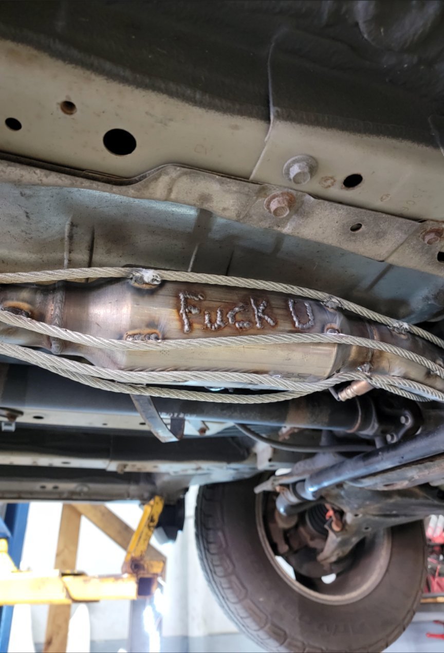

    This makes me want to go buy a welder today
