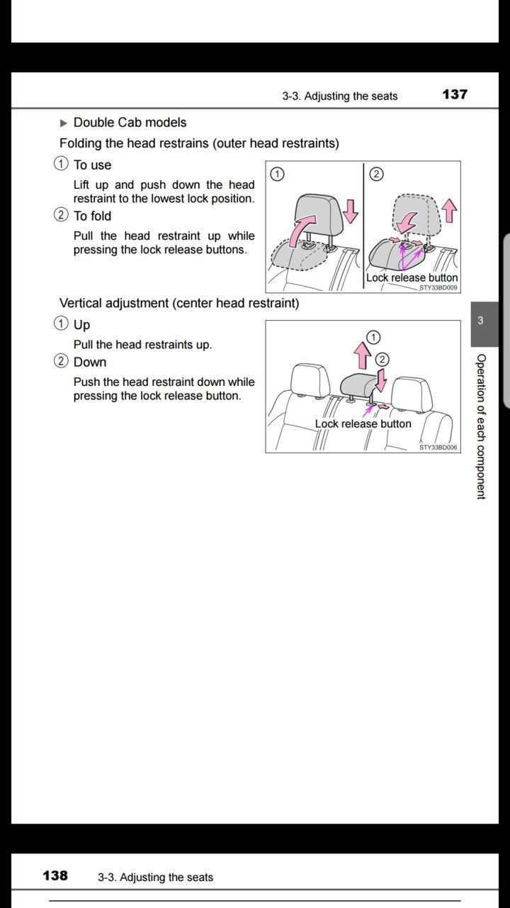

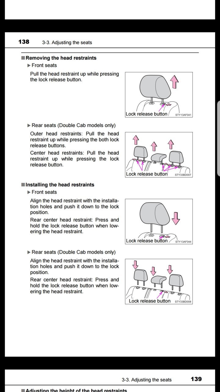

    Fold down, or remove. They're versatile like that.

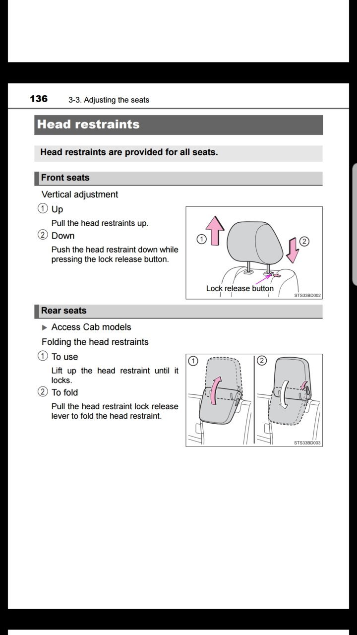

    Access cab you say? No removal for you!

    I removed the one where my child seat is and it gave my kid a couple extra inches of leg room. Although if the truck didn’t have those useless plastic cubbies underneath and behind the seat there would be even more room.
