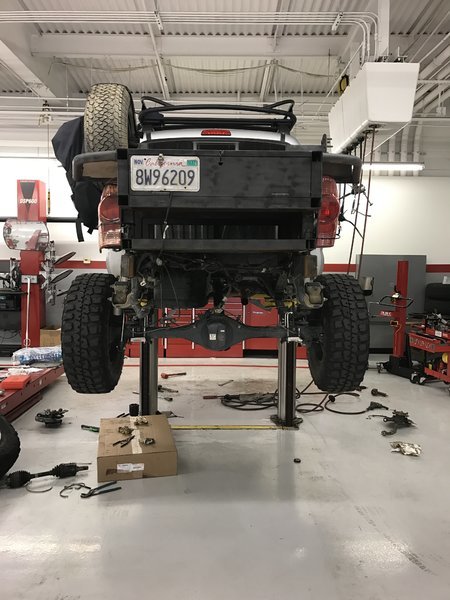

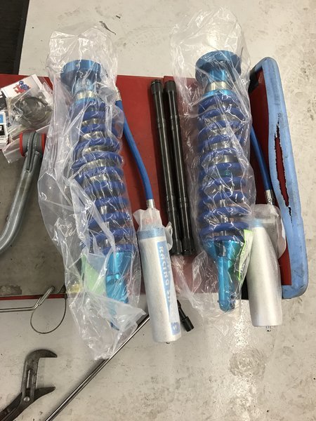

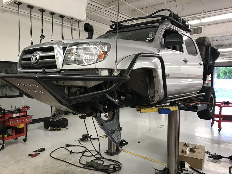

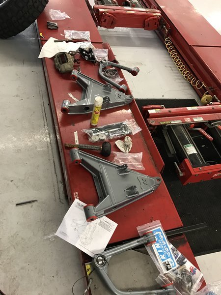

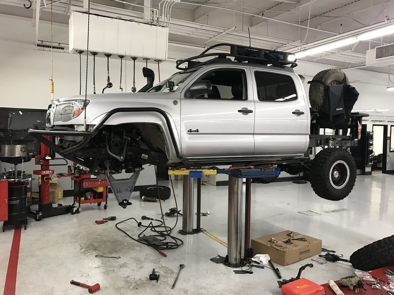

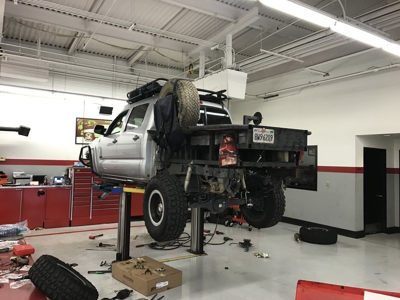

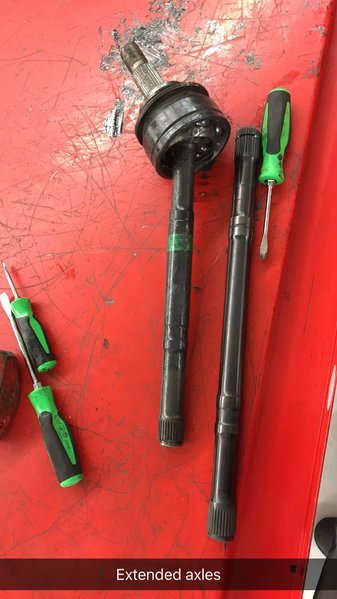

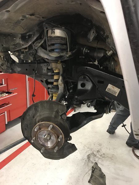

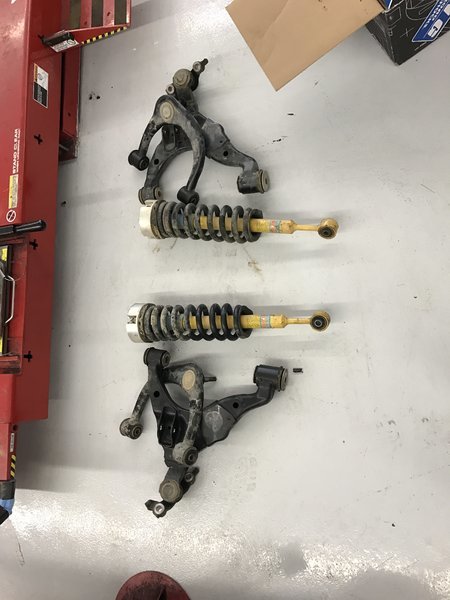

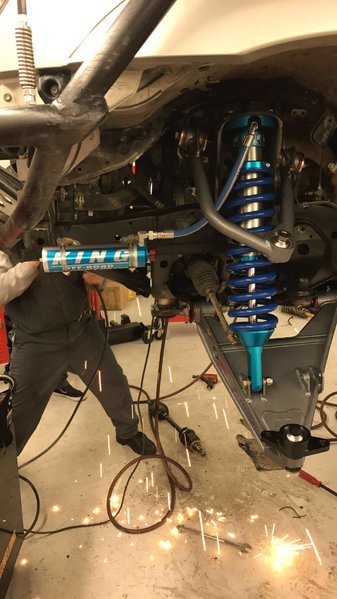

    Some pictures of my night installing the Total Chaos long Travel 3.5 kit with King Extended travel 2.5 Coilovers with adjustable resi's.
    The extended axles were definitely the most difficult portion of the night. Was able to knock the outer more difficult joint off with a heavy short sledge and a fitting from a press. I can take more pictures and show how I did it if people are interested .
    I am located in the South Bay of Los Angeles, im open to any offer on my stock arms and shocks . Couple bucks, beer and a fist bump. Not too worried about it. If you need it let me know
