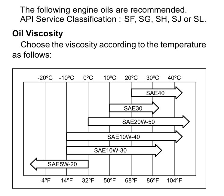

    I use straight 30 in my old John Deere (1987 model)
    But all my newer mowers get 10w-30.
    Here is the snippet from the Kawasaki engine manual.
    I use my mowers in the winter to mulch leaves. So I went with a lower winter viscosity.

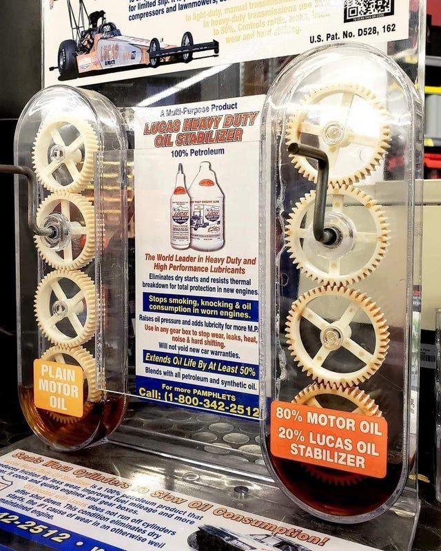

    Was I the only one that tried to get the “regular” oil to climb the gears just as high by spinning the wheel as fast as you possibly could, all while trying not to draw too attention to yourself or tear the display up? :rofl:
