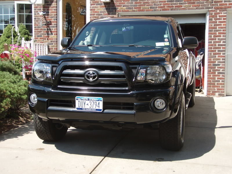

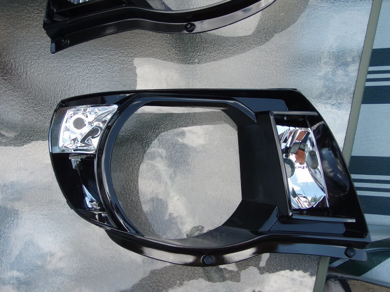

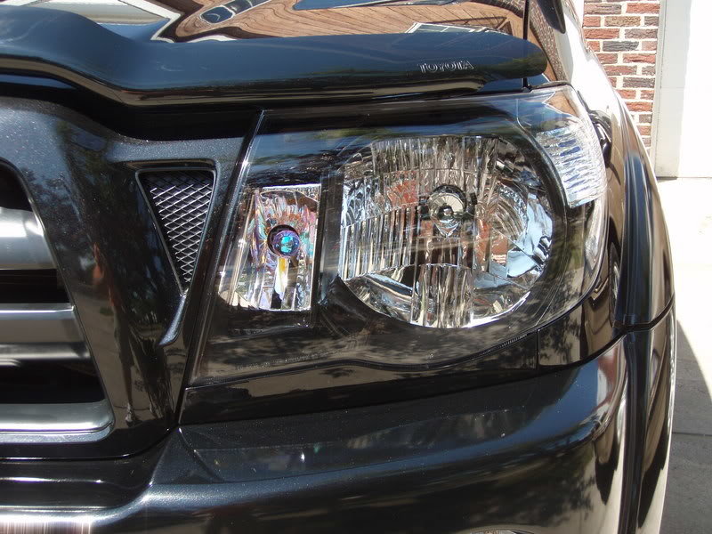

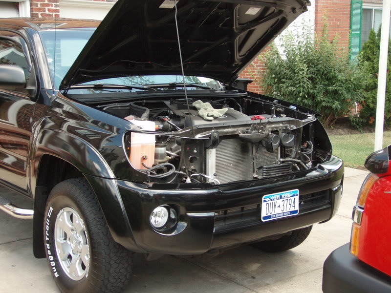

    Yea the heads lights should come from the dealer/factory like this. They look so much better. This AM i took the truck all apart, painted the headlights and installed my TRD bug deflector. I think the truck looks awsome. Hope to get my bull bar next week.
    Enjoy
    Night shaded reflectors

    :thumbsup:I like it...looks good...I thought about about going with the "glossy" paint but was afraid the paint might end up peeling or failing down the road. I also like the 'gloss side markers'.

    I made shure to prep the plastic good then used a primer that makes the paint stick to plastic. Now i think im going to take the tails apart and see what i can do with them. Planing a custom grill as well, but not a billet or honeycomb, im keeping the stock grill in place but making something to sit inside of it. Should be cool. If it does not work on my old chrome grill ill just leave it alone. My truck was the sr5 so it had a chrome bumper and grill. i think there horible so i changed em out for black. Bumper is getting its final wet sand tomaro.

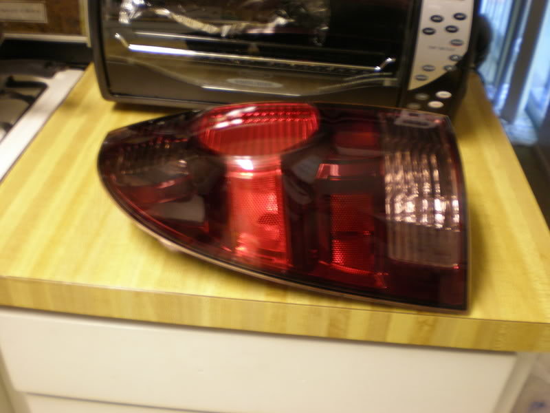

    headlights look great ..hope u dont have any probs with the buggaurd cuz i did :(..and as for the tales u cant take them apart and please dont try ..only person that i know that got them apart got them apart in like 100 pieces haha and he cut his hand pretty good in the process...if u want to do anything spray some tint on those suckers tintedtails003_f092900101a11aef6f1d3d75aff43c7d0cef39d6.jpg

    and i spray tinted my taillights with VHT niteshades tint. ten bucks a can, did both taillights and my 3rd brake light with 1/3 of a can left. make sure you do several very light coats otherwise it'll run, and take them off the truck before u spray them. don't need to sand them down, just clean them with alcohol
