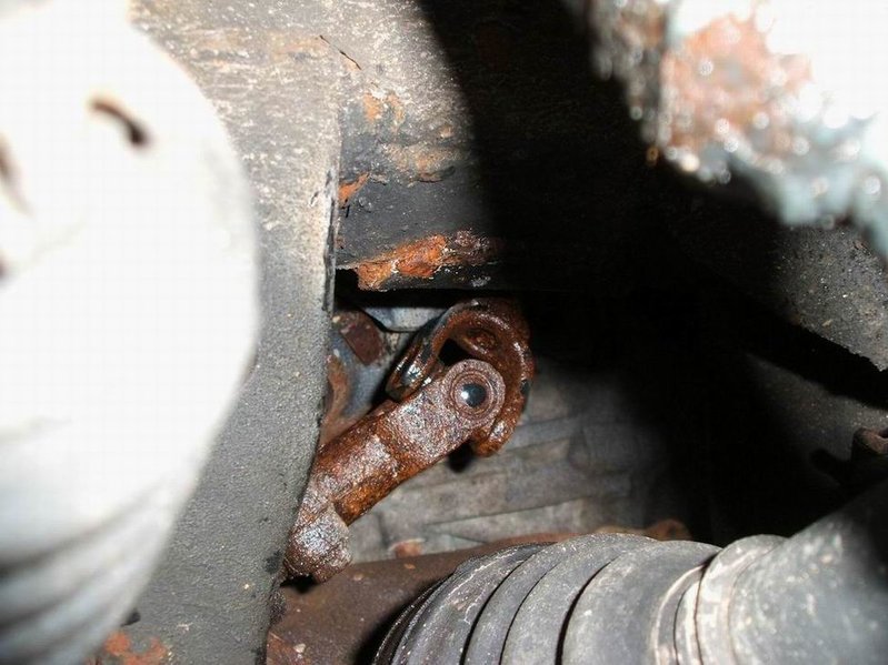

    I'd be suspect of the lower column u-joint seizing, rather than a pump or rack issue. I've heard of half a dozen cases of this so far, appearantly they aren't sealed very well, aren't greasable, or replaceable. The lower steering shaft has to be replaced, but some penetrating lube helps temporarily to determine if thats your issue, just soak it, and see if things improve. If it does, replace the shaft.

    That was the problem with mine. i've actually had luck so far just pulling that rubber sheath or whatever it is up and spraying it with grease. i do that a couple times a year and it works well.

    I was having the same issue and doused my lower u-joint with white lithium grease - FIXED!!!!! I'll include this with my oil changes - thanks guys

    i have this issue! It’s so bad. The truck doesn’t want to turn. Help me find this lower u joint!!

    Behind drivers side front wheel. Just above the CV Axle.

    Makes sense why it would rust and go bad it’s exposed to the elements...I’m try the grease fix when I get home. Hopefully that fixes it. I would just have the lower steering joint replaced if that’s the case and use grease and fluid film on it to keep it up. My trucks only a 2018.

    I picked up brand new upper and lower steering shafts from Toyota. They sure are nice. Steering should be super tight once installed.
