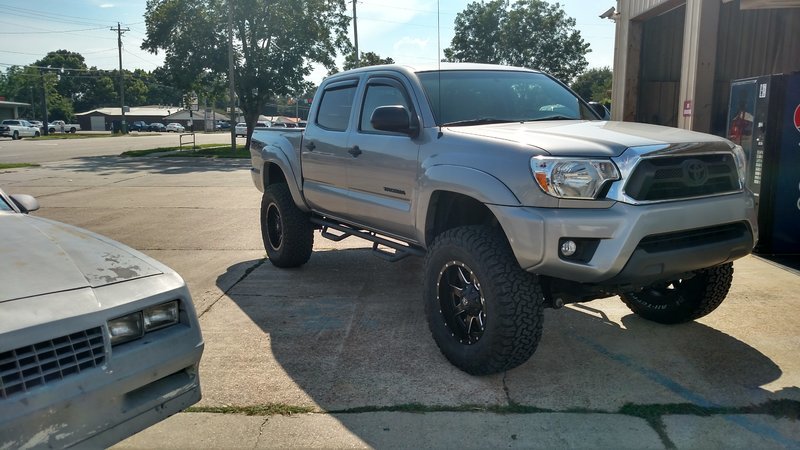

    6 inch bds with fox coils...35x12.50 R18. I love it. It is what I wanted and I made up my mind and did it. No regrets at all. If I do something else I'll be going SAS.
