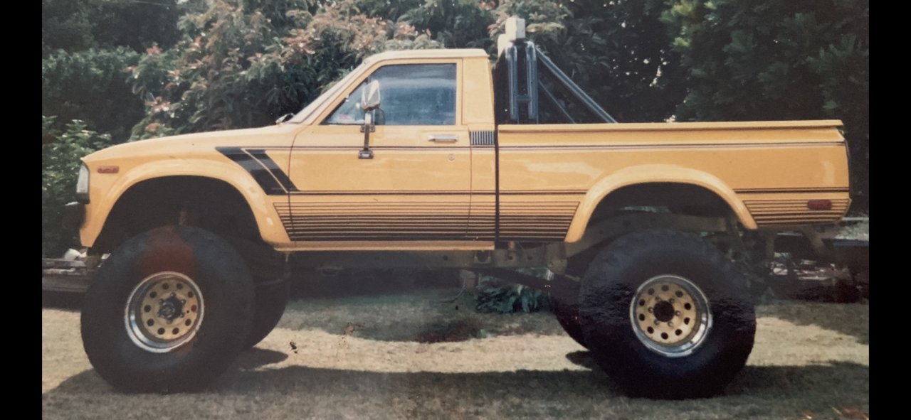

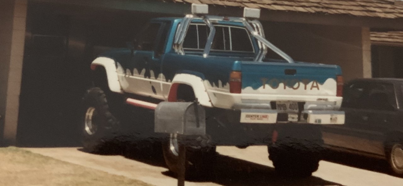

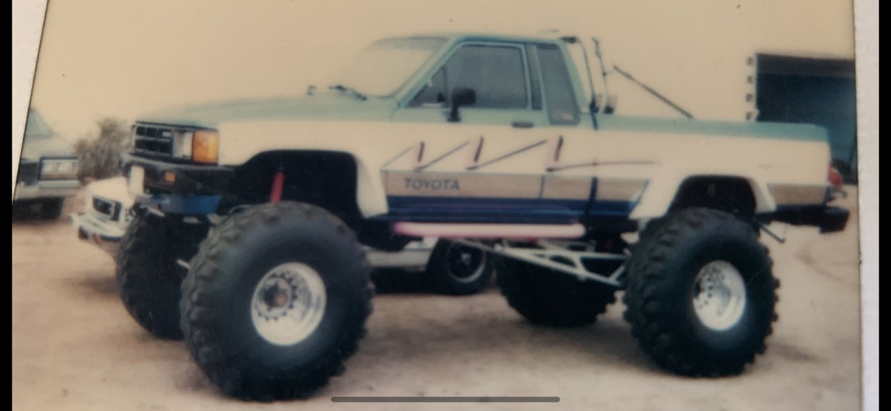

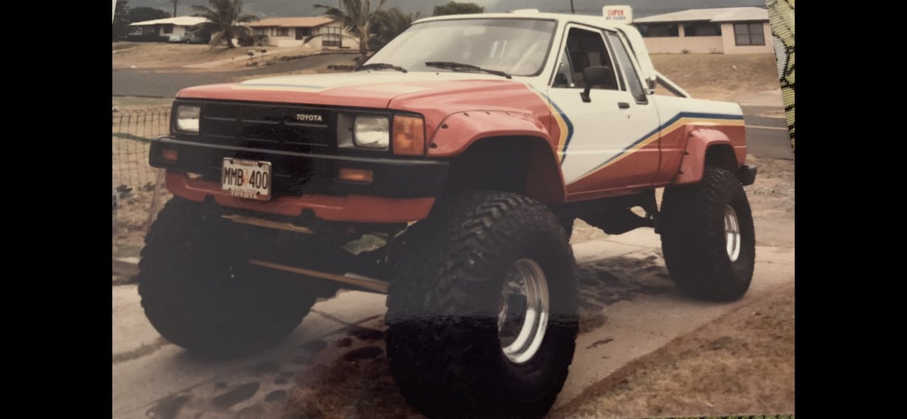

    35's??? You mean baby tires???? LMAO!!!

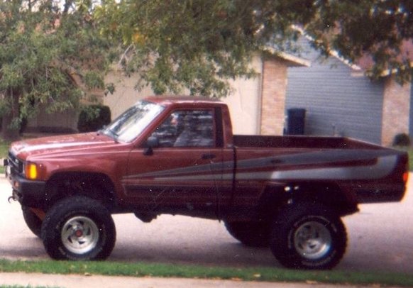

    I wasn't quite at that level, but I was definitely aiming for it on 33s back in 1997...

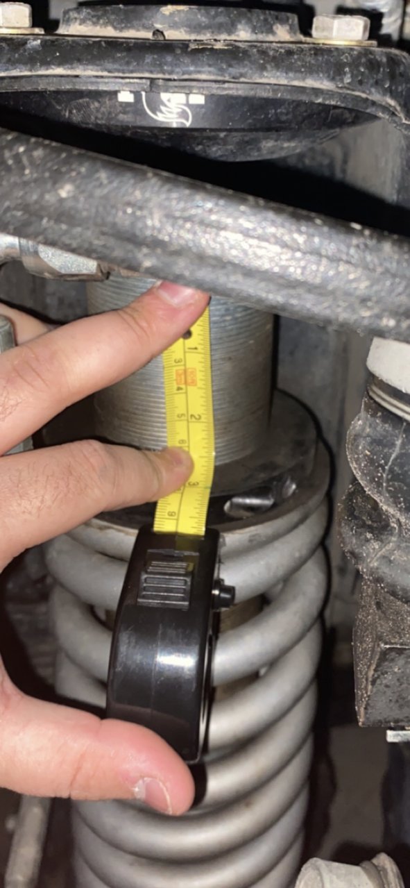

    As for preload I’m not sure, we cranked it maybe 8 turns on both sides cause we were tryna get 7” of lift cause the rear was higher than the front. The measurement is from the top to the collar (as seen in photo) so I’m not sure if you can tell how much preload that is.

    Ok, looks like you have it cranked a bunch, but preload is measured differently on different manufactures. I think fox uses the total spring compression. With wheels off the ground taking weight off springs, measure total spring height. Max is 2" preload give or take .25" . So if you have a 14" spring, max preload should be 12".

    Max preload on the 16" 600lb spring is 3". At full droop, you don't want to compress spring more than 13" in total length. AccuTune Off-road can help you out, great customer service and they know their stuff.
