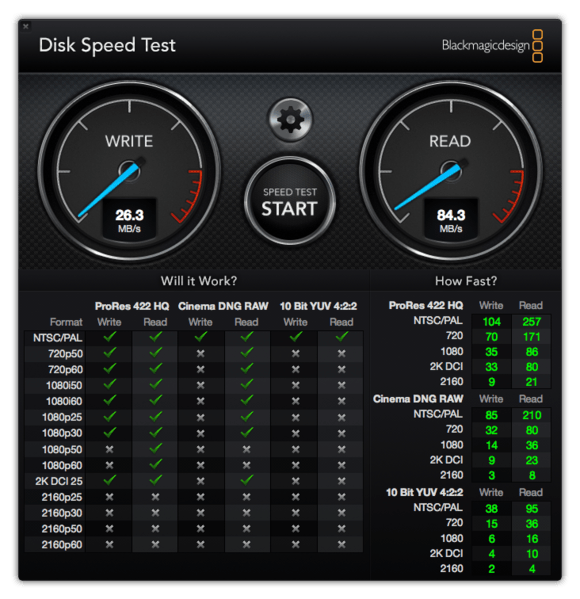

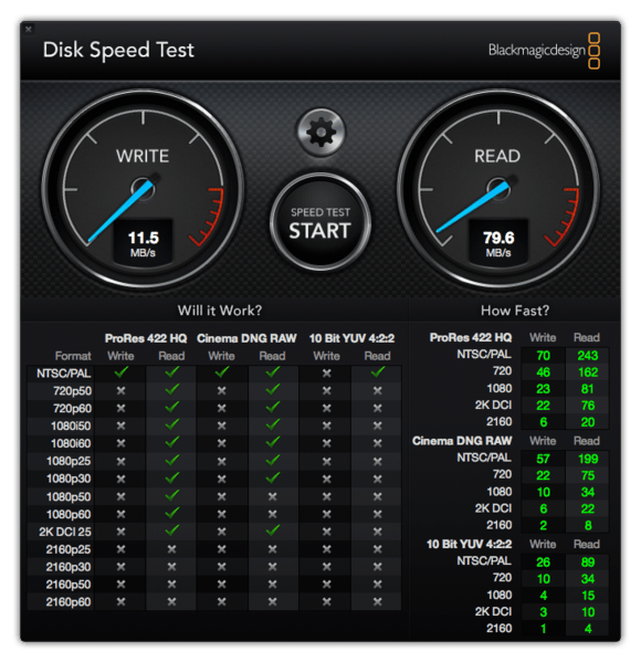

    So a quick bit of info. With some research I'd ordered a Lexar 633x 128GB card for my Thinkware F770. I knew the cam could be finicky on cards but have had good success with a PNY 32GB card so I tried the Lexar after a bit of research.
    It does not work. F770 sticks in a "format the card" loop even after formatting to ExFAT.
    Discussing it with BlackBoxMyCar (who I bought my cam from) they said since early February people have been having issues with that card and they're no longer recommending them. They believe Lexar made a change.
    Here is the Black Magic Disk Test result from the 128GB card:
    and here is the same test using the Thinkware 32GB card that came with the F770:
    I'll update further if I find a card that works and doesn't cost a fortune.
