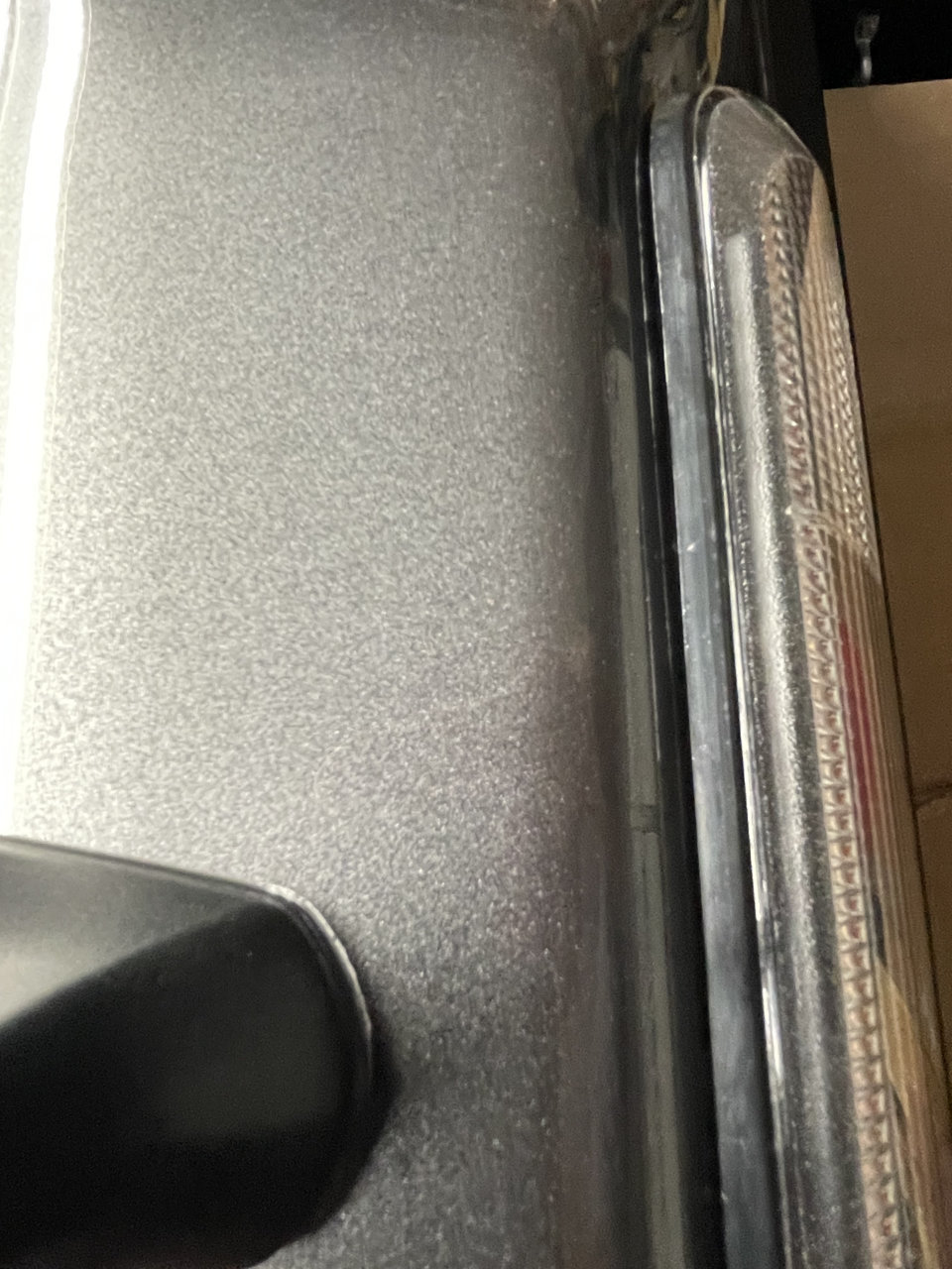

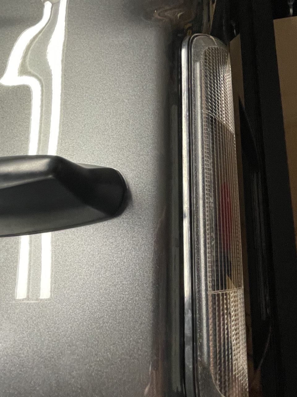

    Toyota says my trucks due for the third brake light seal recall. :annoyed:First recall in 5 years too. I wanted to avoid this, but after looking at the light up close I'll probably take it in. The light appears to have a large 1/4" or more gap all along the back where it doesn't seal tightly against the cab. I just wanted to confirm if any other 3rd gen Tacoma owners brake light has a gap like this before I take it in.

    I guess I should have been more patient and done my research on this one :oops:...
    https://www.tacomaworld.com/threads/yes-another-leaking-third-brake-light-thread.558122/page-4
    https://www.tacomaworld.com/threads/breaking-news-3rd-brake-light-problem-solved.733074/
    I think I'll be ordering the new part (81570-04051) with the thicker gasket and attempting this repair myself as my truck doesn't meet Toyota's requirement for a full lamp replacement and I don't want any silicone. Should be a fun project. o_O

    You have read the other threads on how that light unbolts from the cab, right? If not you may want to read those threads and reconsider the silicone.
  5. Aug 26, 2021 at 7:00 PM
    MGMDesertTaco
    MGMDesertTaco [OP] Come on, live a little...
    Jan 30, 2021
    #354573
    9,827
    Yes, gotta pull the headliner. This appears to be the easiest way without pulling the entire headliner.
