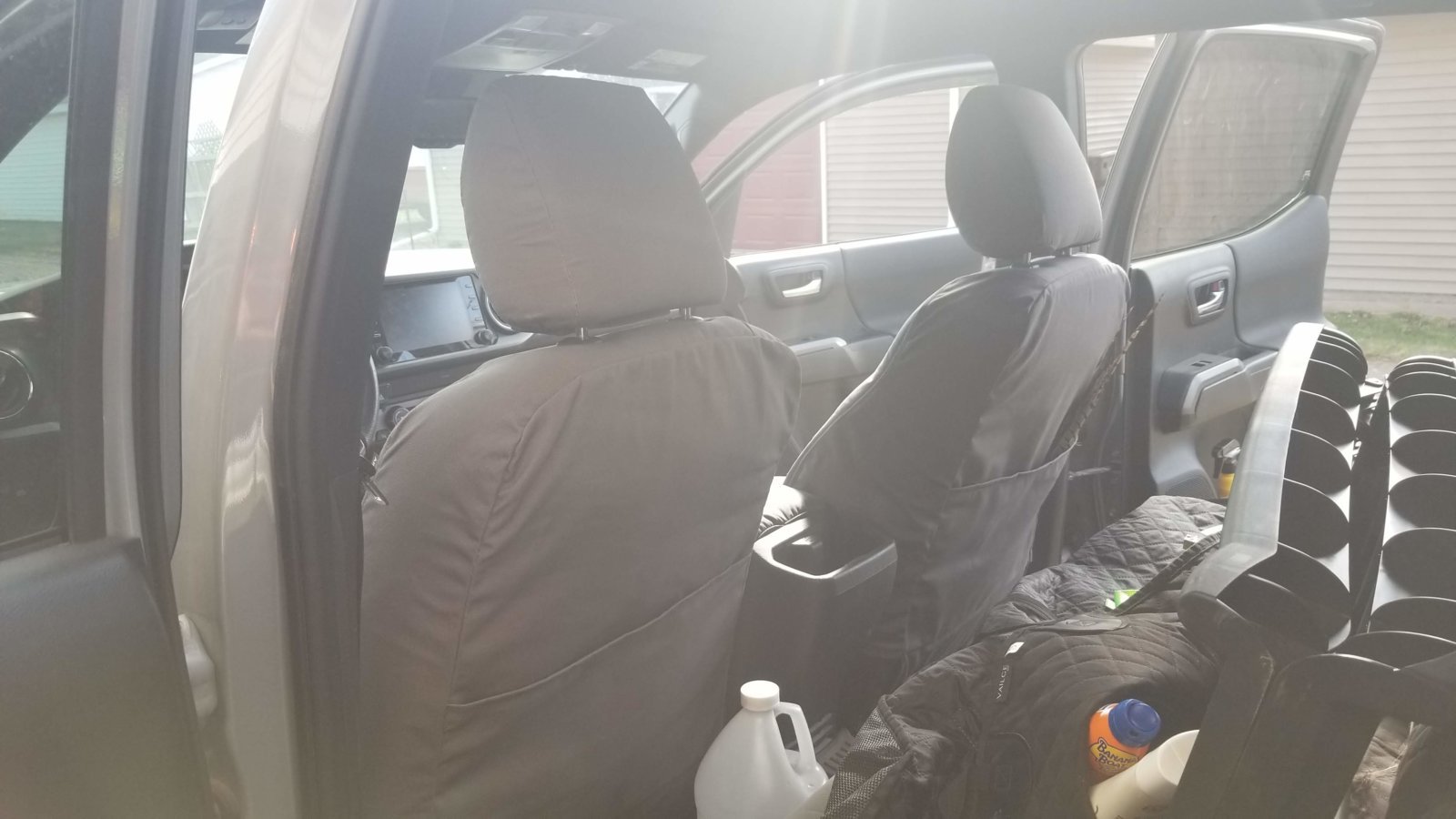

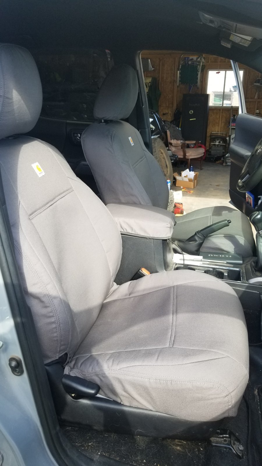

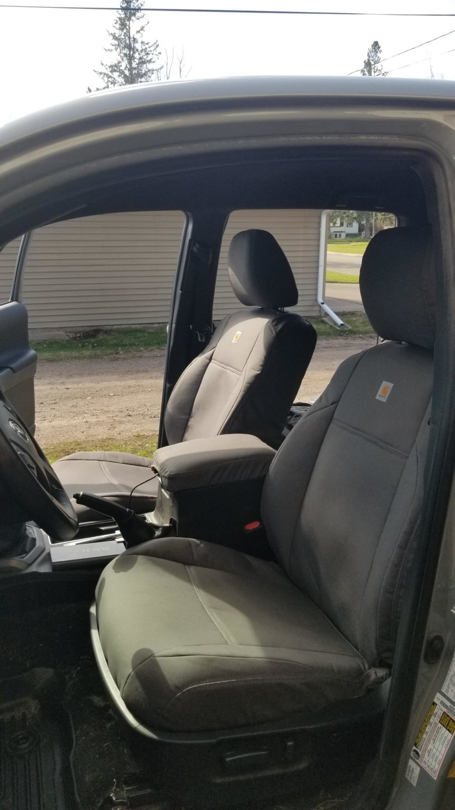

    My seat covers showed up last weekend, so I took the opportunity on a sunny Sunday to throw them on. The whole process took maybe 3 hours, which included a lengthy talk with a neighbor who stopped over to BS, debating if I wanted to remove the seats or not and potentially deal with wiring/airbags/etc. (decided to do it with seats in, disconnect your battery beforehand if you decide to remove the seats), and looking up an install video on Youtube to make sense of the straps (the directions were pretty minimal/generic but made more sense after watching a video, link below).
    https://www.youtube.com/watch?v=XG5hiYK2nrs
    The center console took removing 10 screws (6 holding the inner plastic to the lid, which covered the 4 remaining screws to remove the lid at the hinge), made it pretty straightforward. Probably possible to do without removing the cover, but it's a pretty tight fit. I used a magnetic tip screwdriver since the 6 inner plastic screws are tiny.
    I flipped the headrest covers completely inside out and lined up the seams while rolling them down, they were tight but that method worked well.
    I did the same with the backs, but only flipped them ~1/2 way inside out, lined up the seams, and rolled down, pulling it tight as I went. There are some hooks on elastic ties attaching the OEM back bottom carpet under the seat that had to be released (pay attention to where these hook to, small metal bars), then the straps for the back of the seat cover could be fed through the bottom/backrest crease (the straps ultimately ran under the seat to attach at the bottom/front).
    The bottoms get tucked in to the plastic surround on the drivers seat (less plastic on the passenger side to tuck). The plastic on the truck seats is actually surprisingly loose and was fairly easy to tuck the seat covers into. Because the bottom seam is folded over and stitched, it had enough to "catch" inside the plastic after tucked in. There's also a white plastic tab near the seat recline controls on both sides that sit inside the plastic of the seat sides (visible in photo #2 below), presumably for better holding power. This is probably a part that you could spend a lot of time on to make it look as good as you want, tucking everything as nicely as possible into the plastic and tightening as you go.
    I wasn't really impressed with the side to side velcro solution, which probably would have worked much better if I had removed the seats, but it was sort of tricky to figure out how/where to strap the velcro (and keep it from sticking to nearby carpet, and connect it to itself along the entire length solidly under the seat). It wasn't a very good "pull tight" method either, I've seen strings used with a tensioner in the middle on some other covers that seemed like it would work way better. Then I connected the 4 straps front to back and tightened over the velcro running side to side, while paying close attention to where the straps and velcro were run and trying to avoid crushing any electronics, which there were plenty of with power seats/air bags. I also did my best to make sure nothing would get caught when moving the seats backwards and forwards.
    After that, the rear bottom velcro attaches to the OEM carpeted bottoms and the OEM bottom elastic/plastic hooks could be reattached to a small cross bar underneath.
    I didn't spend much time trying to make everything look as smooth as possible. I think the creases are much less noticeable in person than they look in pictures.

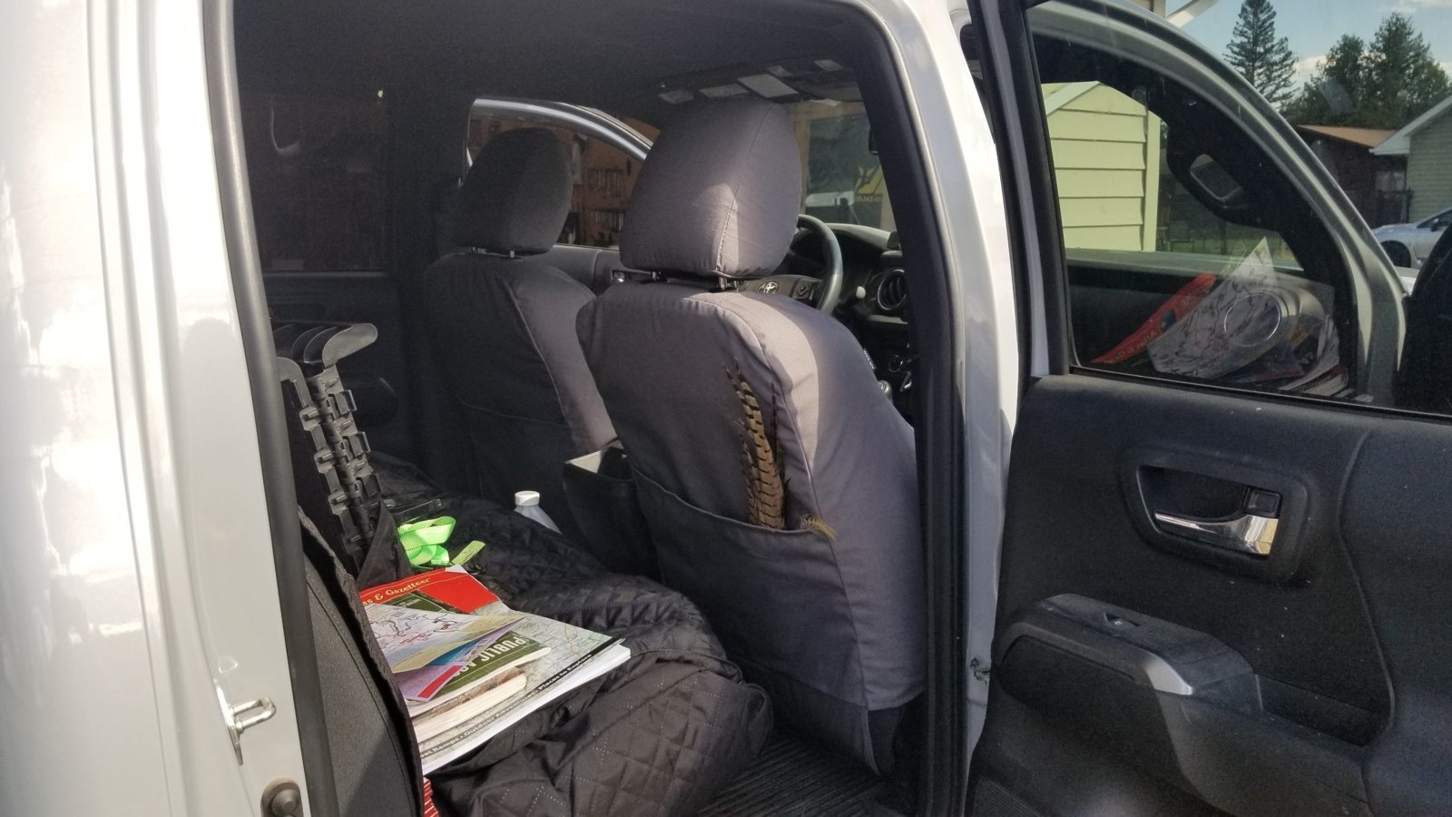

    From the back, passenger:
    Fronts, passenger side:
    Fronts, driver side:
    From the back, driver:
    The backs get covered up by my dog hammock which is in the truck 99% of the time. The map pocket on the driver's seat back was a nice add on (why do the OEM seats not have one?).
    I've had them in the truck for a few days, and so far I'm very happy with them. There's a small amount of foam padding on the inside of the covers that add a little more cushion to the seats. The color was slightly darker than I was expecting, which I really like since the rest of my interior is black. As far as I can tell, gravel and brown are the only color options for the precision fit, so it worked out well having a cement truck. I could probably spend a good hour adjusting and tightening to get some more creases out, which might happen soon when I deep clean my interior (especially if I remove the seats then). It sounds like there's a chance you have to have your passenger seat air bags recalibrated at a dealership (with something like 66 lbs of weight) upon removal, which is why I didn't do it in the first place.
    They don't recommend machine washing due to the foam padding on the inside, so I'll either give them a light scrub in the truck if they get dirty, or remove them for a deep clean and hand wash them in the future as needed.
    Overall I'd give them an 8/10 as far as initial impressions go, especially at 20% off (went from ~$500 to $400 before tax/shipping). I'd easily give them a 9/10 if there was a better solution other than the side to side velcro straps. They've got a bit of a "new Carhartt smell" to them, which I don't mind. My only other minor complaint is the added thickness means the seats rub the center console cover (more than stock) when sliding the seats back and forth, but my seats don't move often, and that's on Toyota, not Covercraft, or any other seat cover manufacturer.

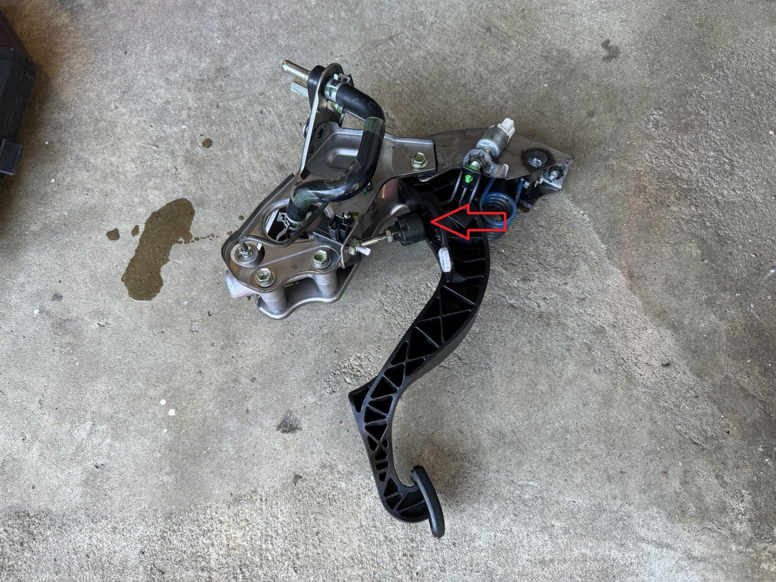

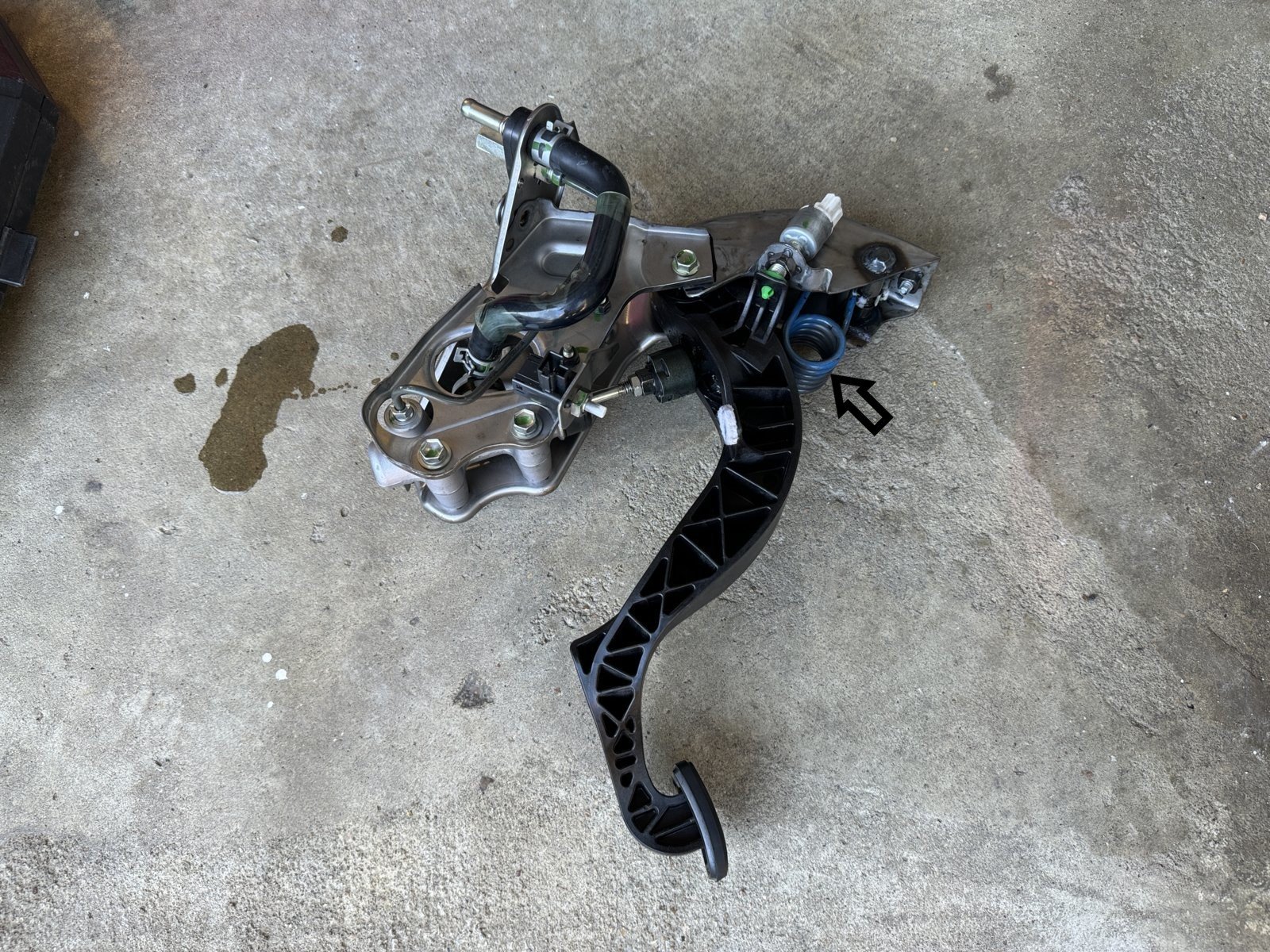

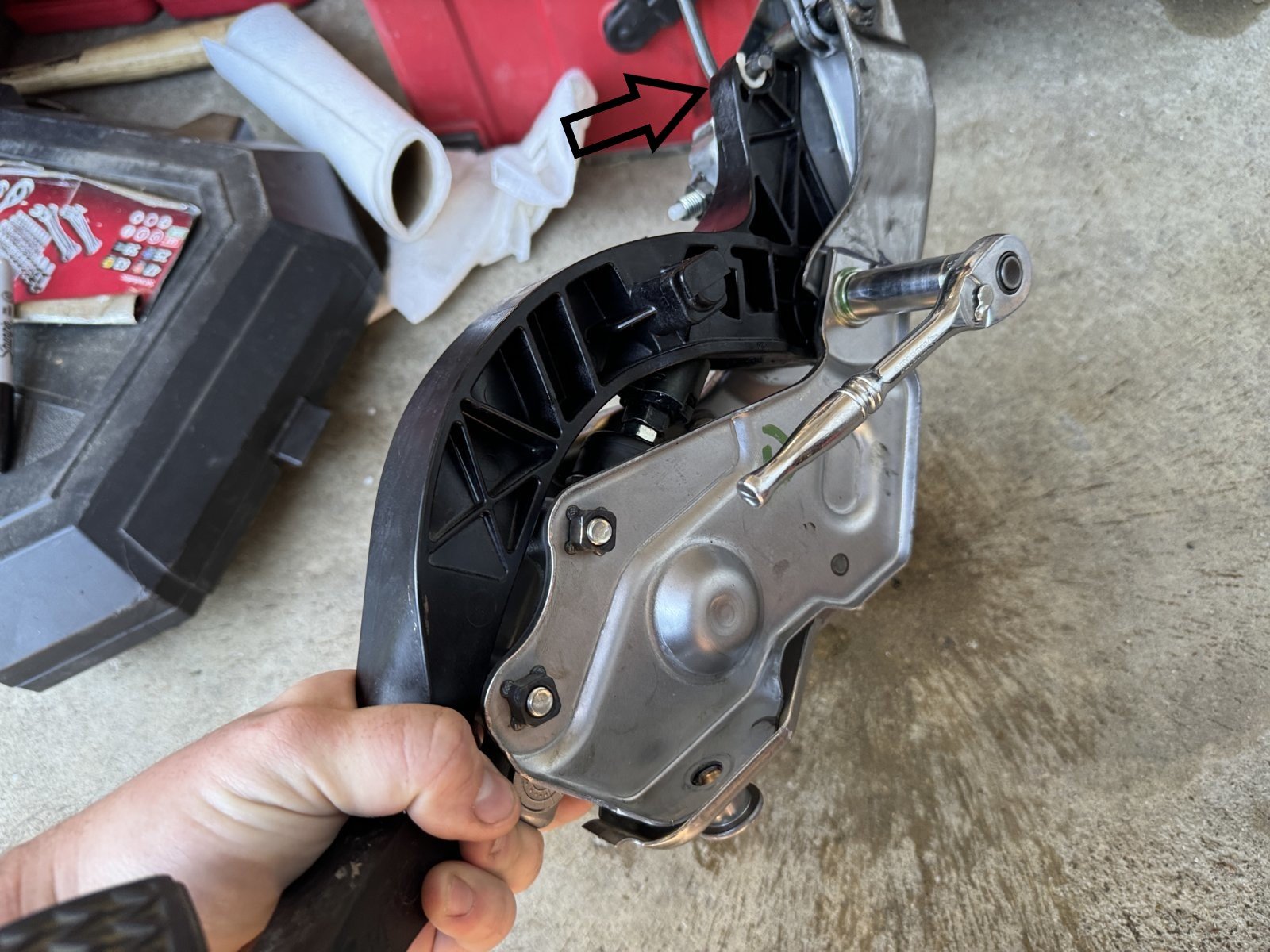

    I started getting a squeaky/creaky/groaning clutch pedal in the last few days, first instance of it happening (currently right around 39,900 miles). Quick pedal pushes were still smooth, but slower movement made it creak enough where I could feel it binding with my foot.

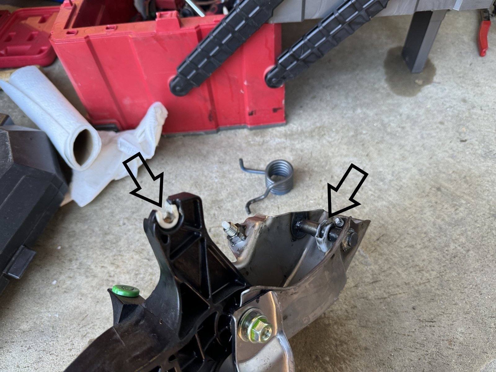

    Poking around here, it seems the consensus is to use brake grease as it has long staying power. Fortunately I had some on hand, and went crawling on the floor of my truck for the 2nd time in as many weeks.
    Unsure of where exactly to slather the grease, I ended up going for the two white plastic ends that the big return spring sits in. I didn't think to take pictures, so here's a couple courtesy of BLtheP's metal FJ Cruiser clutch pedal swap thread to show where I mean:
    https://www.tacomaworld.com/threads...al-for-a-metal-one-from-an-fj-cruiser.814720/
    I did my best to work the grease into the plastic retainers while pushing the clutch in and out. It seems to have taken care of the issue for now, so we'll see how long it holds up.

    Minor updates. The previous post with the clutch greasing lasted for a day or two, I ended up applying more grease in the location below, has kept it quiet for 3 months now.

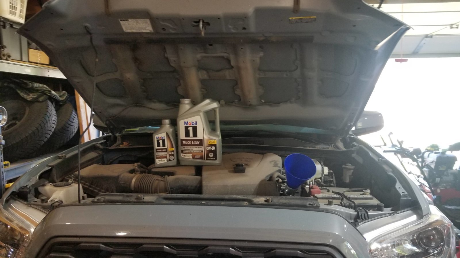

    Also changed my oil and filter (OEM) at 40,763 miles on 6/8/24. I went a bit long on this oil change (last done 12/29/22 at 30,101 miles), I'm thinking I'll switch to 5k intervals for the future. I had the dealer do oil changes at 5k, 10k, and 20k, and now have done my own at 30k and 40k. However, my commute to work is almost exactly 5 miles through town, and it's winter here December-March (at minimum). Per the Warranty and Maintenance Guide, 5k intervals are recommended when driving on "Repeated trips of less than five miles in temperatures below 32°F / 0°C," so for at least part of the year I meet those criteria.

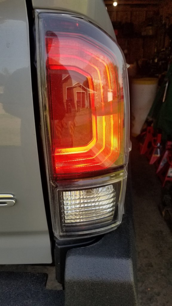

    I decided to splurge on something I've wanted since I bought my truck, a set of OEM TRD Pro tail lights (2020-2023 styling). I figured Memorial Day sales would be a good time to look for a set so I browsed the online deals, and also decided to call my local dealership parts guy, who is a close friend, and he was able to come close in price to the sale prices online, so I ended up ordering them locally.
    For the most part, I'm happy with the updates that the 2020 trucks received over the previous 2016-2019's. Android Auto, power seats, actual buttons on my radio, etc. are things that I absolutely love about my truck and would not want to do without. However, the removal of the driver side bed cubby (even though I rarely use my passenger side cubby, but it's the principle!) and going from a mostly red tail light lens to a clear housing with chrome/silver accents inside were things that I was not a fan of. I didn't hate the look per se, it actually went well with the Cement color of my truck, but they looked a little too much like Altezza lights to me, which I've forever associated with knockoffs (I now realize Altezza lights were started by Lexus, referring to a clear tail light lens, but I always think of the cheap ricer knockoffs that followed those regardless). I've always liked the look of solid red tail lights, so I considered grabbing a set of those from the 16-19's, but I slightly prefer the look of the Pro's, so that's what I went with.
    Part #'s: 81550-04230, 81560-04230
    Old OEM Tail lights, not bad, not great:
    New tail lights, still Altezza, but an improvement:
    I like how they match my bedside stickers now, and generally I think they fit the truck better overall with all of the other black I have going on (matches better when everything isn't covered in dirt).

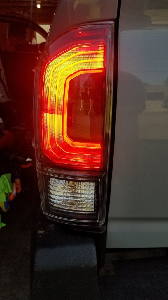

    I've had the Meso Total Tails Stage 1 on my wish list for some time now since they improve the visibility of the rear tail lights in a few ways, but after waiting months for them to restock, I ended up going with the VLED VTails (Standard) which from what I understand is an improvement anyways. Luckily they recently dropped a 20% sale, so I scooped up a set.
    The packaging and quality of everything in the kit seemed really top notch. I would have liked to install these one light at a time in the dark for a good side by side comparison to stock, but I had some free time this morning and was eager to try them out. The stock rear tail lights are not optimal, as the brake light and turn signal are built into half of the red C separately. This kit moves the turn signal into the bottom white section and uses a switchback bulb to flash amber for the turn signal, and white for reverse. It also combines the two brake lights to completely fill the red C area, as well as for the running lights, and improves the brightness over factory for everything. For daytime comparisons to stock, the difference was pretty noticeable.
    VTails blinker (left), stock blinker (right):
    https://youtu.be/tAdStaKw-EM
    Brake lights (for all these, VTails left, stock right):
    Both VTails installed (tried to show reverse lights, with brakes on):

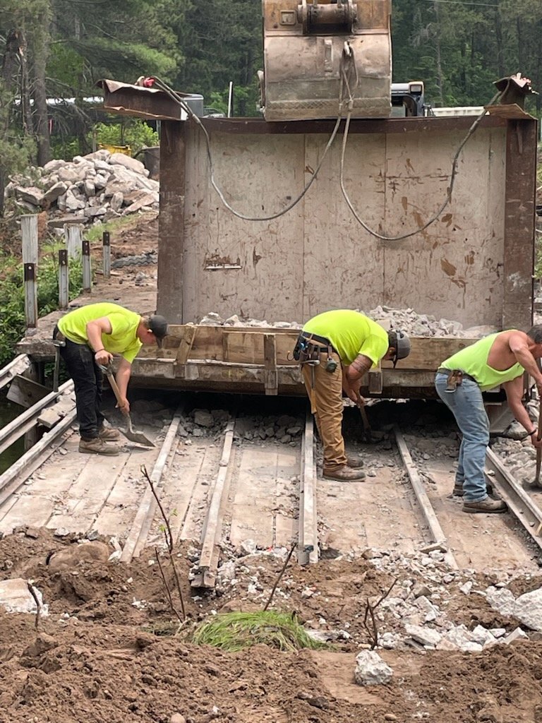

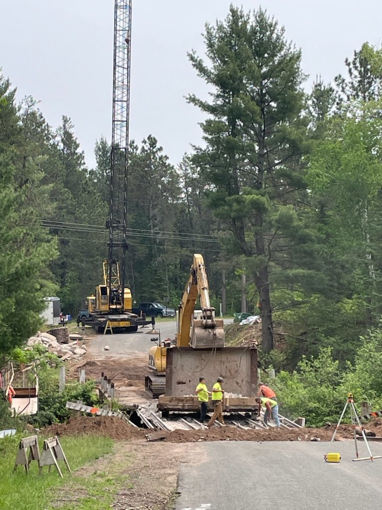

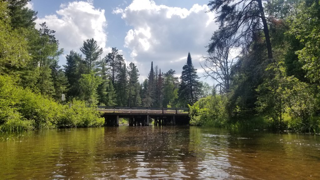

    Our family river property is adjacent to a local bridge that is under construction. Bridges on this stretch of river were constructed in the 1930's and 1940's, so a lot of them have been replaced in the last several years as they reach the end of their lifespans. Ours in particular was pretty unique, as it was originally constructed completely out of wood, with wooden piling and abutments (soaked in creosote) and a wooden deck. Many of the other bridges were concrete, which makes me think this bridge was constructed even earlier. The original deck was very narrow, so it was widened at some point with lengths of railway track on top spanning between the abutments, concrete poured between the tracks, and eventually overlayed with asphalt.
    My old man was around a few weeks ago when they began demolition work and snapped a few photos and chatted up the workers.
    Here are a few of my favorite photos of my dog on the bridge a few years ago:
    Best picture I could find showing some of the underside of the bridge construction.

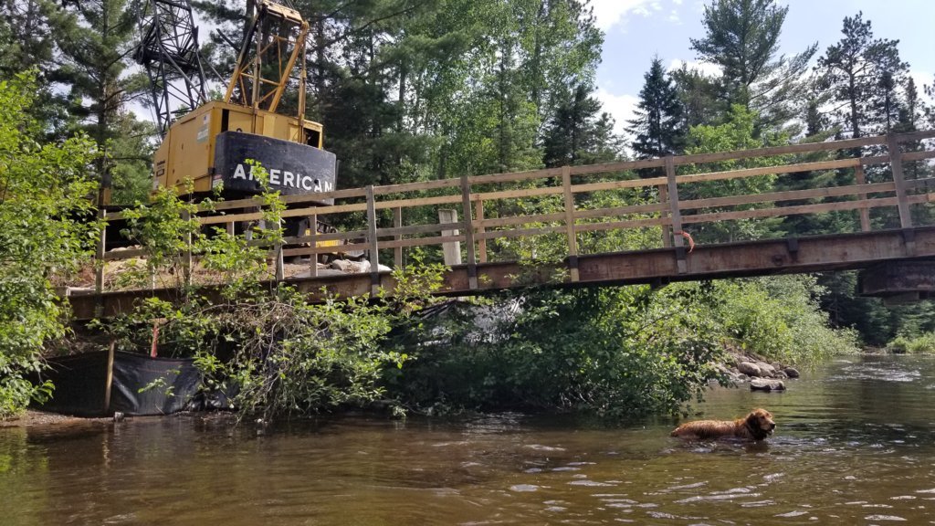

    Currently, they have the old bridge removed for the most part, and have the new pier constructed in the middle of the river. It sounds like both abutments will be poured before the 4th of July, so I'll probably grab more pictures then to document the construction since I think it's pretty cool.
    Here's how things currently sit.
    Temporary walkway for the workers:
    Old cranes are from the ~1960's I believe.
