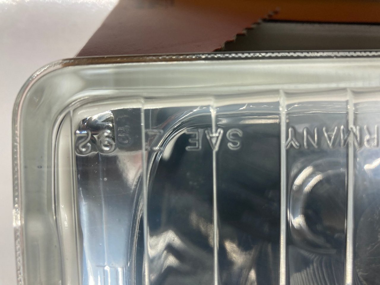

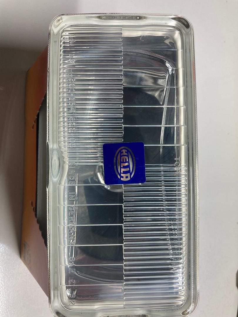

    Here's one for you. It took some digging in my lighting parts stash, but I knew I had a set of these. They're Hella 550 mid-beams. (NLA as far as I know.) I used them on a Mazda 626 that had the world's worst low beam headlights. They did a pretty credible job of replacing the low beams and didn't bother oncoming drivers.

    Those are a nice find!!! SAE Z or J582 are very rare. J582 (aux low beam) was discontinued. Any chance there is a part number?

    Looks like the part number is 301-134 622-05. You can see it if you zoom in really close to the upper image on the bottom left, but it's hard to read. I couldn't find much in my searches other than 1 on ebay for $80.

    From what I can make out on the lens, the part number is: TA 10 301-134 622-03

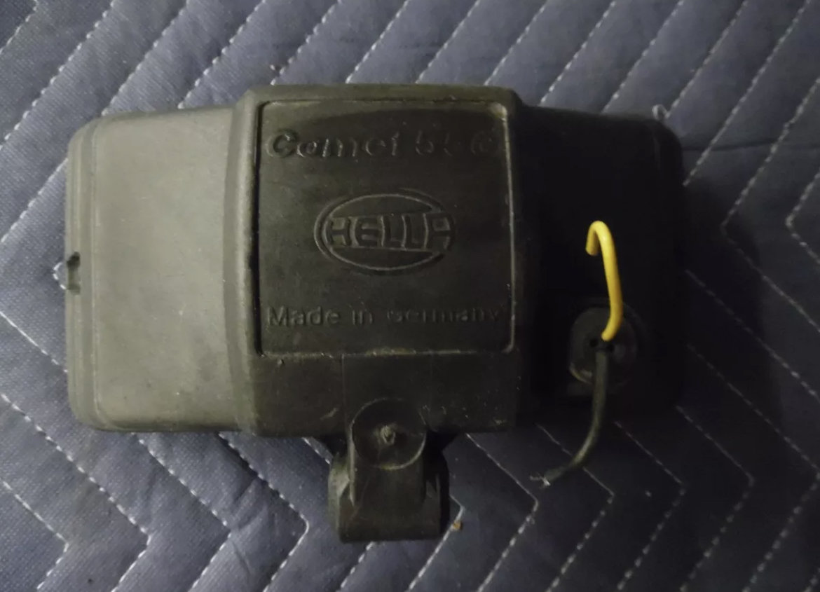

    The listing on eBay shows that lens and on the back it shows that it is the “Comet 550”. Though I cannot find that lens style for the Comet 550.
    https://www.ebay.com/itm/HELLA-FOG-...-z-92-Right-Left-BMW-SAAB-VOLVO-/322260419304
