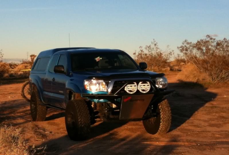

    note: I am probably an extreme case here because I run mud-terrains with a little more tread. In this photo you can see where I got rid of the entire front quarter of the inner fender. On the backside there is nothing easy you can do, you must cut the cab mounts.
