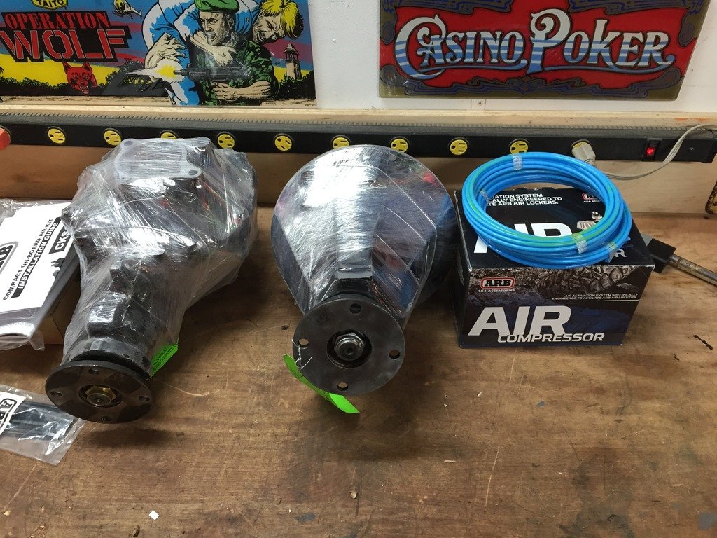

    These were waiting on my steps when I got home tonight. A pair of 4.56 Diffs with ARB lockers, and a compressor, for my 13' 6 Cyld Auto.

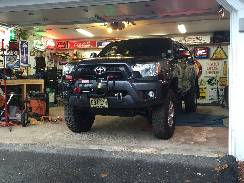

    My truck:
    B3A4FC34-8367-4D6A-9030-229B97DDD31F_zps_9e54c602e6105bd57541d03f7d4cae19e2d3d3d5.jpg
    C259929D-4A1D-4FFF-B926-3CF379B2F7D2_zps_099585d0f8b74066757f86595fcc36d4ba7b0048.jpg
    Im loving the 255/85/16's. I'm NOT loving the lost power due to the 33's. Couple that with the added weight from the winch, tools, and the armor, and skids I have on the way... This re-gear is going to be very welcome.

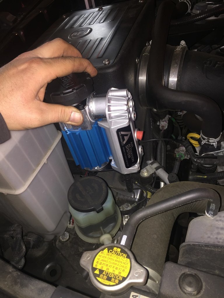

    I was playing around with where to mount the compressor tonight. I saw a thread on here somewhere where someone mounted it on the fuse box cover like so:

    I also kicked around the idea of mounting it on the side of the AFE Air box:
    F0EB561F-6A34-4D6D-86E4-E5149F1E8A82_zps_81132c55eb61c3f3303af3ee51ea8ff5e0778f46.jpg
    I like the idea of putting it on the fuse box cover. Less likely to have to extend the wires. I'm putting all three switches under the blanks in the center under the radio.

    And... it begins.
    EEA249BB-24E0-42E4-8C62-802569201658_zps_ce64d4f02ada07b7a8e6b1e76f5ad3c0612a4b1e.jpg
    Out with the old
    59C8FA7A-C8BB-4D9B-82E7-E653CACEE73F_zps_b36f07fed574e4ae33f5510bc2d8128ad725e6ab.jpg
    In with the new

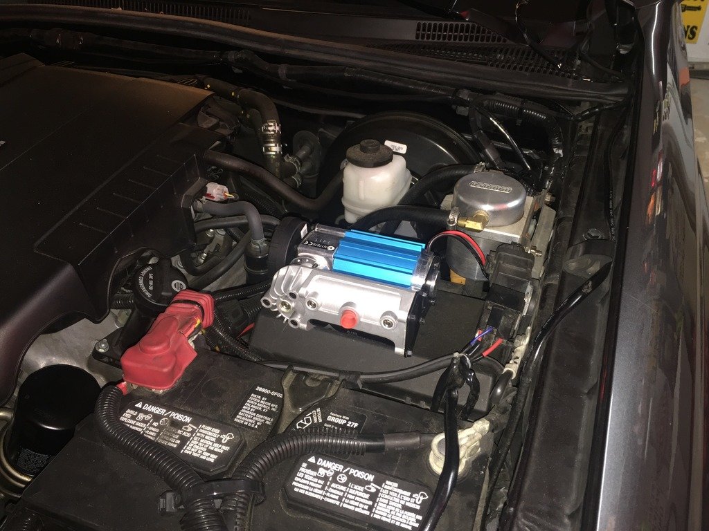

    3" Lift, ARB's and 4:56 gears front and rear, Allpro Off-road bumpers sliders, skid plates and Ubolt flip kit, 35" Maxxis tires, Trail Gear Creeper Locks, 8000lbs winch and lots of LED lights.
    Just did the same setup on my 15 and love the gears, compressor mounted just need to mount the switches in the cab what's your plans for your switches.

    Looks good. Love the mount. Unfortunetly, my catch can is mounted right there.

    Given the weight of the compressor and the amount it vibrates while running - I personally would strongly recommend against mounting it on the fuse box cover.

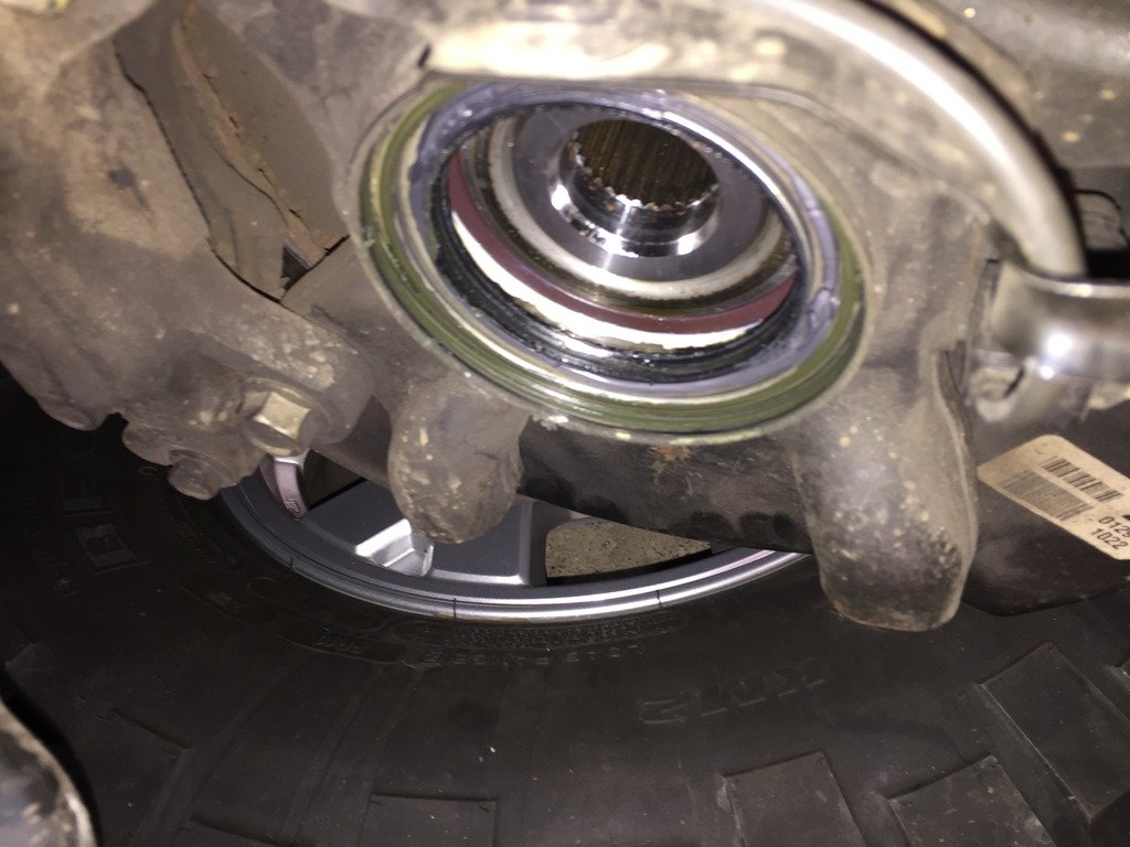

    Hey thanks! Just in time too... I pried the drivers side out easily. The passenger side, not so much.
    I used the pry bar and hammer method in that thread. Worked like a charm :thumbsup:
    Last time I did the slid hammer and hose clamp method. I didn't have a clamp big enough this time though. Didn't feel like running out to get one.

    Can anyone tell me what kind of grease is on this hub seal?

    I'd just use mobile 1 synthetic or any type of wheel bearing grease.
