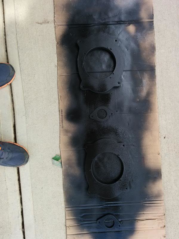

    So, I'll just leave these here.
    Almost a shame to cover them with a door card. They are beautiful.

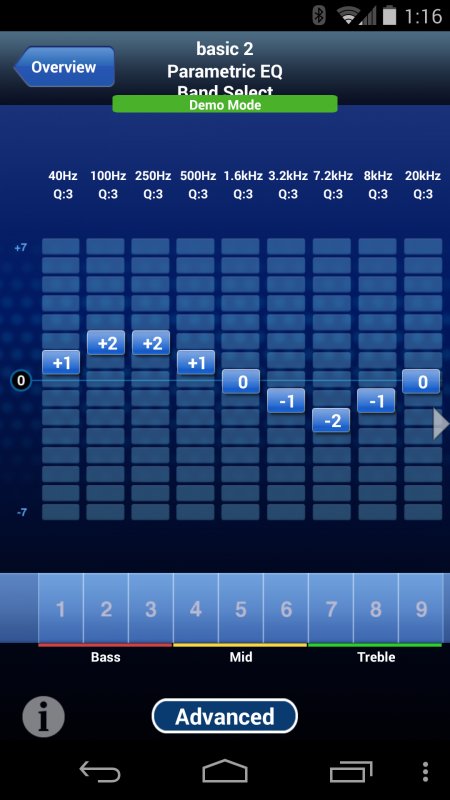

    So far, after playing with it for a week, this is the nicest tune I have, for the smoothest sound from all the speakers I have now. I'm running 200w to the Hertz speakers, and running the rear speakers off the deck.

    does the crossover allow you to adjust the tweeter level down any further? based on your EQ curve, it looks like your tweeters are running a little hot.
    Can your HU do bandpass filters on your mids? I smell a perfect candidate for active.

    They are already on the -2db setting, so no, no further adjustment. I think running them off axis, pointed more towards the listener is bad for these guys. They need to be on-axis for best results. Funny you should mention active, as a JBL MS8 was to be next on my purchase list. But that won't be for a while, I've got some things to take care of first.
